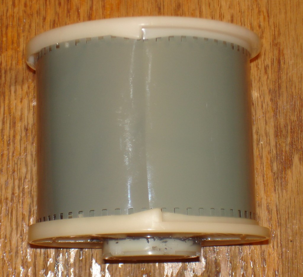

I have collected, cleaned and dusted, added blue tape, to my remaining stock of Kodak 70mm Cartridges. All of these cartridges are complete, including the silver inner clip. It is important that the film go completely into the exposed cartridge, without damaging the film transport. My plan is to load 24 exposures including header and leader, which I can develop on a Unicolor Uniroller, using my JOBO 2500 with modified 120 reels, or my Patterson which holds three 24 exp 70mm modifed reels. I bought up, cleaned up, and modified another Unicolor Uniroller, this one has continuous one way rotation.

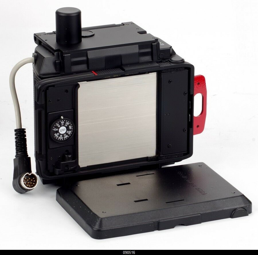

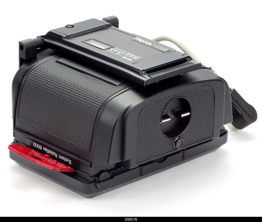

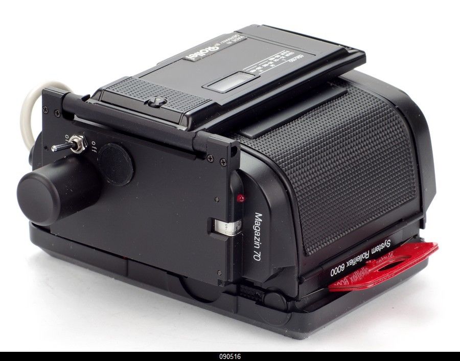

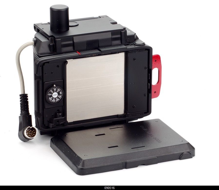

I've seen references to a 70mm back for the Rollei 6000 series cameras in an old catalogue and on the internet, but I've yet to see a picture of one, let alone one for sale. Do these actually exist? And if they do, do they use the standard 70mm cassettes? I have a bunch of 70mm film, and a 6008 seems like it would be an ideal way to run through it.

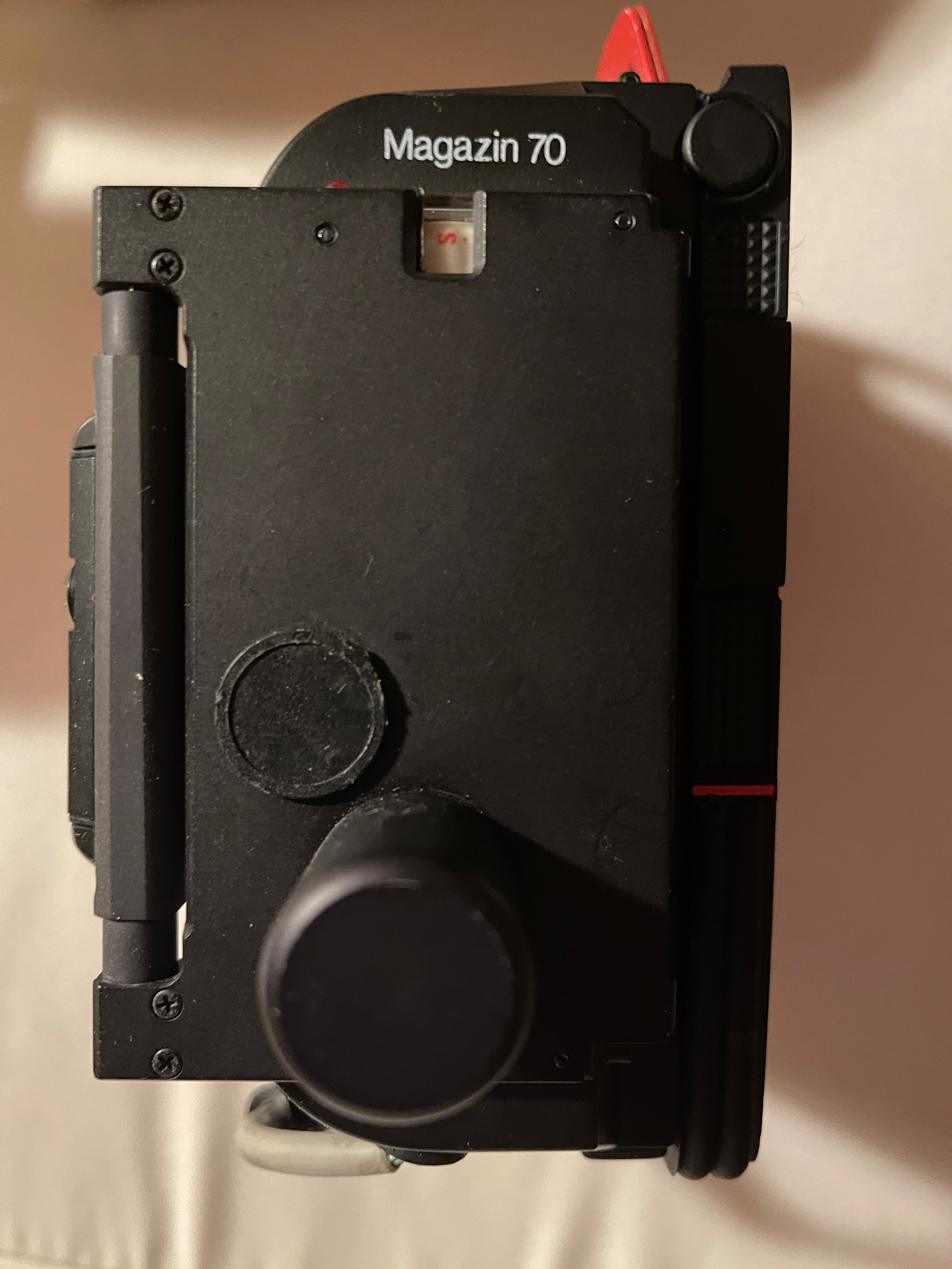

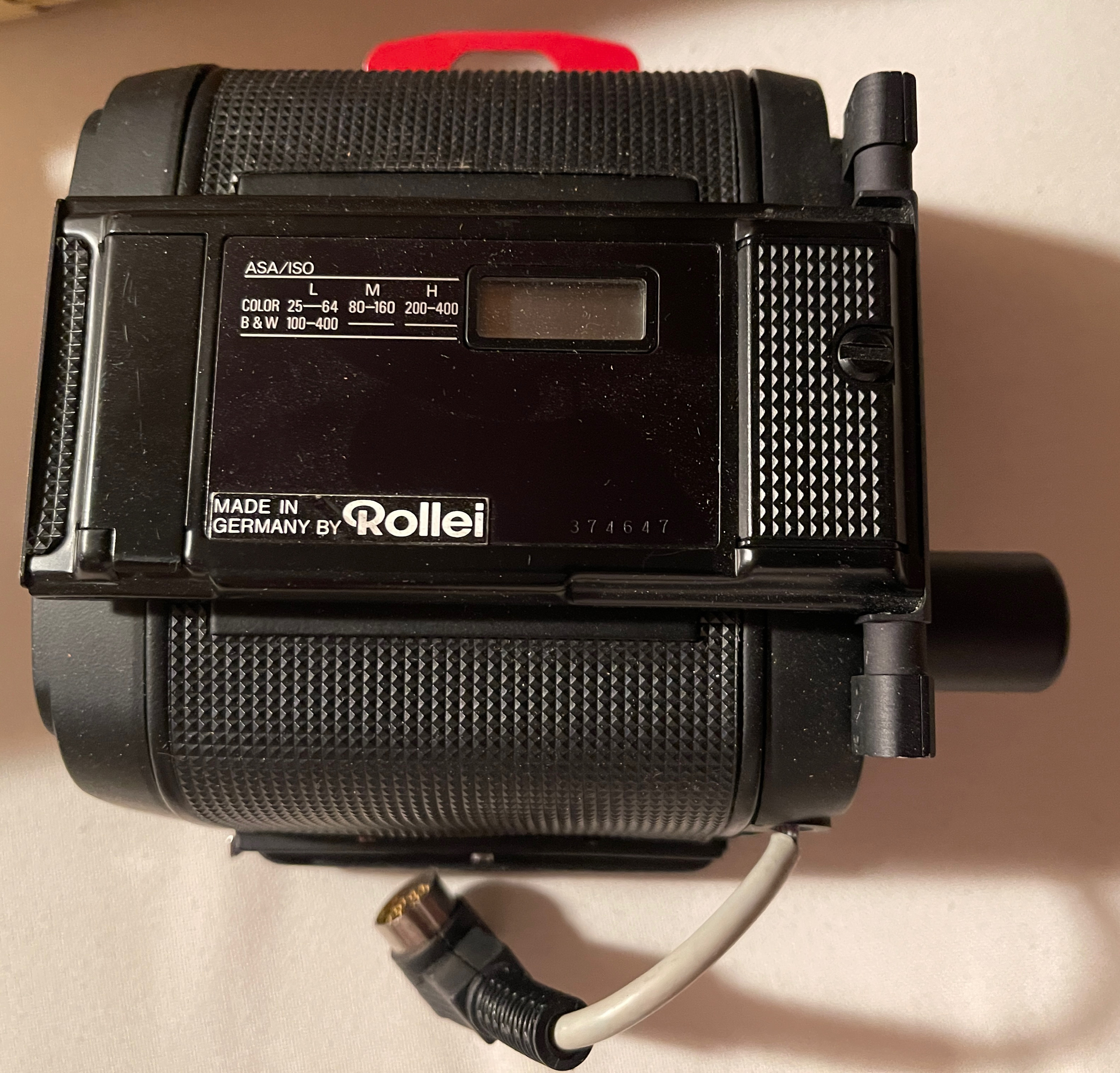

To illustrate this post, I took just a few pictures of my version of the magazine.
First the face with the Nikon data back. It is attached on just one side and rotates around that axis, the other side being attached through a sort of magnet.

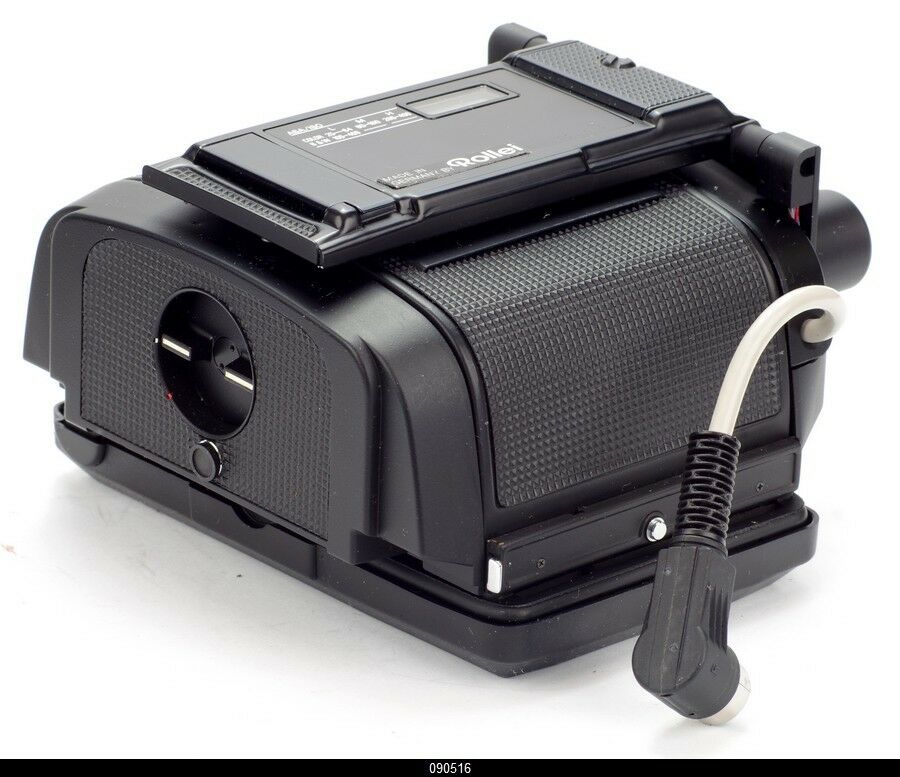

The DIN connection to the body gets out of the bottom.
Second the right-hand side. Alas no film speed wheel for me. Frame number at the top, and cache over the DIN socket, probably so a remote can be used when the magazine connection occupes the DIN socket of the body.

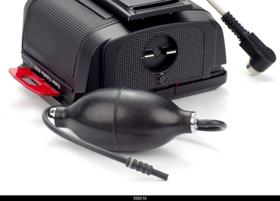

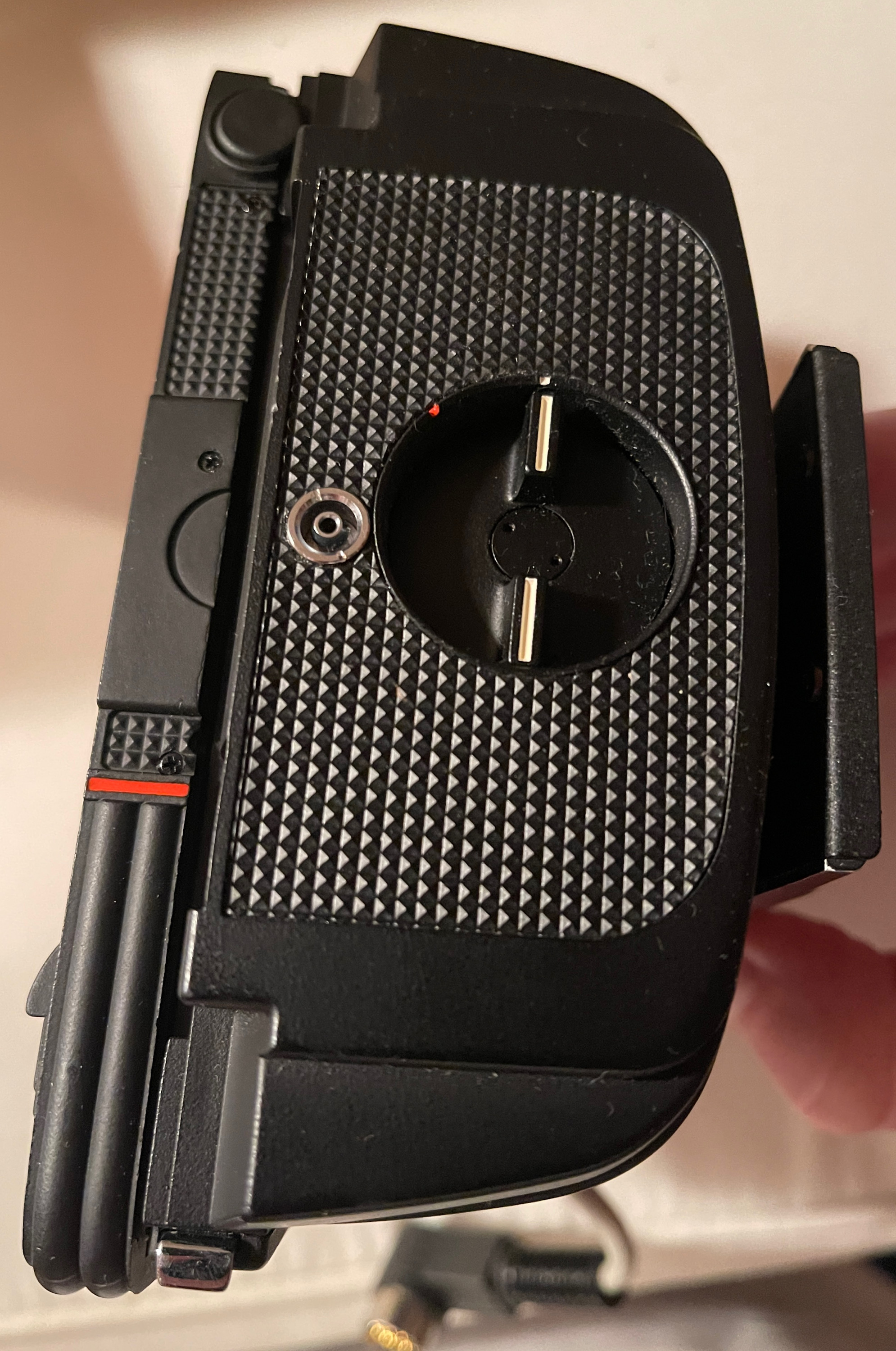

The left-hand side, where what looks like a flash output is in fact the vacuum pump connector.
So it does exist! Thanks for the photos. It's really interesting to see what one actually looks like.

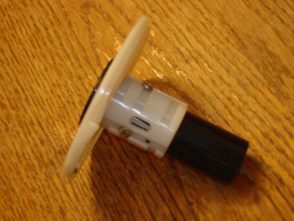

Definitely check with SK Grimes, maybe they even have some alreaready in stock? Back in the day one portrait photographer from East Coast with Mexican last name (sorry??) was making those wheels and selling them. That was what I was able to find a few years ago when I was looking for them.
I'm sure any machinist can make it, it's not complicated part at all. Now, there is question of the price you are willing to pay for it?
I've explored possibilities for machining wheels to convert Hasselblad A70 magazines to handle unperforated 70mm film. It looks like cost would be $20-$25 per wheel. Is anyone else interested in these? I could have a quantity made up and sell them at cost, but I'd only bother if there's enough demand to make it worthwhile. Are there 15 or 20 people out there who want one? Looking on Ebay at A70 auctions, they seem to sell fairly frequently and rapidly. Someone is buying them.

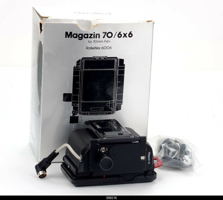

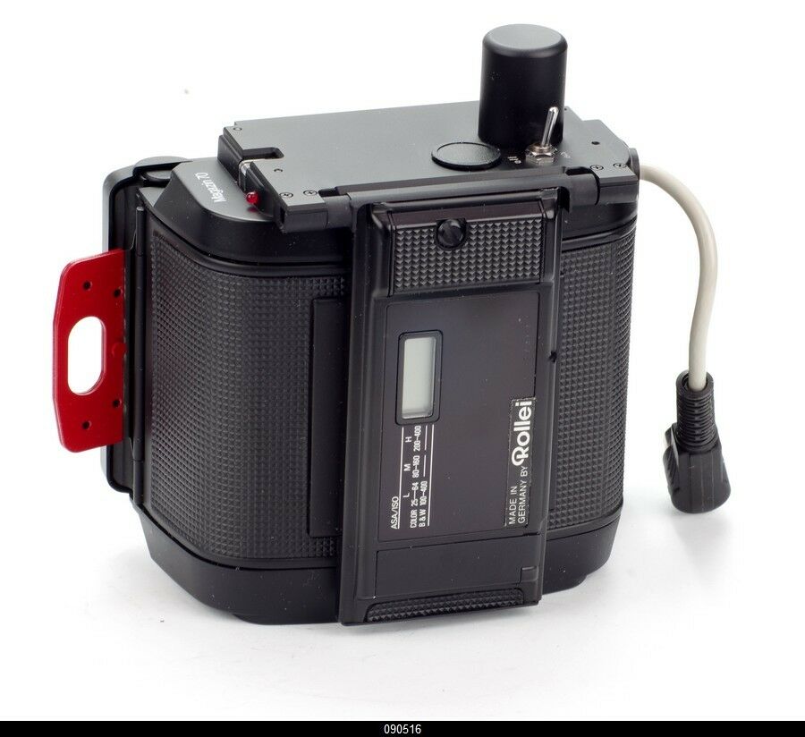

I found some pictures I had saved from a Google image search some time ago, most probably an auction site. This one has both the data back and the film wheel inside (that mine does not..), plus some kind of on/off switch...
It looks like your dream has come true… in a version without speed wheel nor data function.

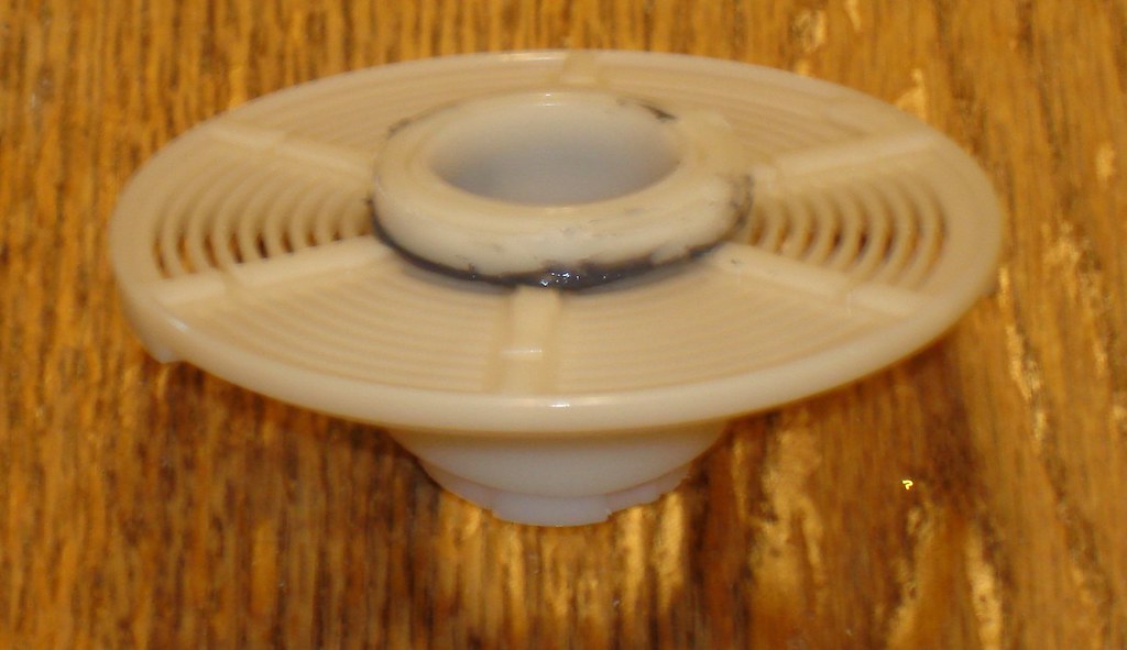

Custom Made Paterson 70mm Reel hold 220 length by Nokton48, on Flickr
I just tested this new to me Paterson custom made 70mm film reel, it holds a 220 length of 70mm film. No problem loading at all, although if it starts to slightly stick during loading, I simply pull the reels gently apart, while twisting and pulling the film onto the reel. It goes on smoothly and tightly. I am really pleased. I will be making two more custom 70mm Paterson reel sets, so stay tuned on how to make your own. Two sets of reels are required to make up the necessary parts for this thing.

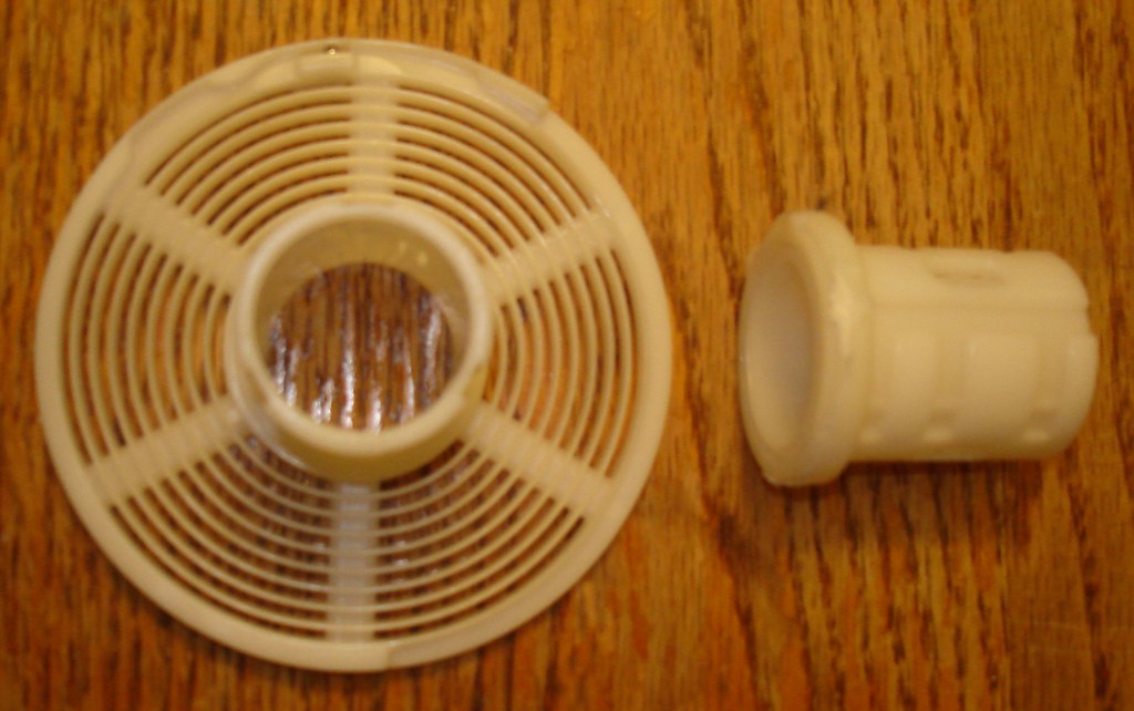

Step 1 Parts Needed Paterson Single 70mm Reel by Nokton48, on Flickr

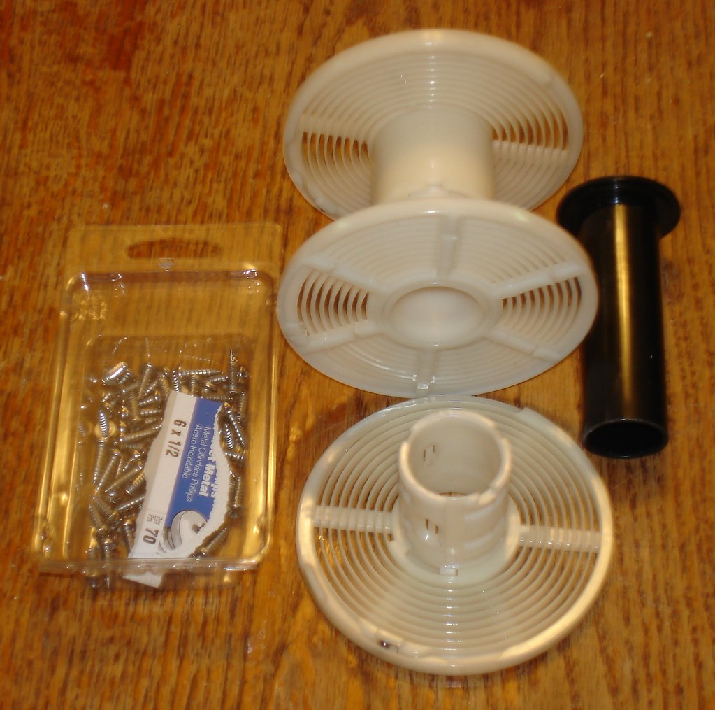

To make a Paterson 70mm reels for the small tank, you need: one complete reel (both sides) and a third reel side, the one that will fit tightly on the black central core. In addition to the core, you will need stainless steel metal screws #6x1/2", JB Weld, cross point screwdriver, and 1/8" drill bit and drill. I drilled out tiny guide holes with my dremel, to accurately and easily drill the screw holes. The plastic is rather slippery and tricky to drill
Step 2 Remove Spiral Material From Rotating Core by Nokton48, on Flickr
On the left, is the original reel. On the right, what you should end up with after modification. I also used a bench grinder to buzz down the right side a couple of milimeters, so there is plenty of room for the final adjustment and fitting.
Step 3 Attach Spiral with Ball Bearing to Black Central Core 3 SS screws by Nokton48, on Flickr
Make sure it is tight and square, then install three stainless steel screws.

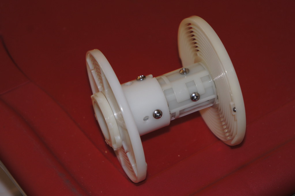

Step 4 JB Weld Other Reel Tightly Squarely together Dry Overnight by Nokton48, on Flickr
Carefully JB Weld the Other Reel to the modded hacked central reel. It is mucho important that both sides of reels are square and not wobbly. Otherwise you will go nuts trying to get the roll to feed smoothly and without issues. Don't get any on the inside of the spirals, obviously. When this dries overnight, I'll finish the final assembly. Stay tuned.

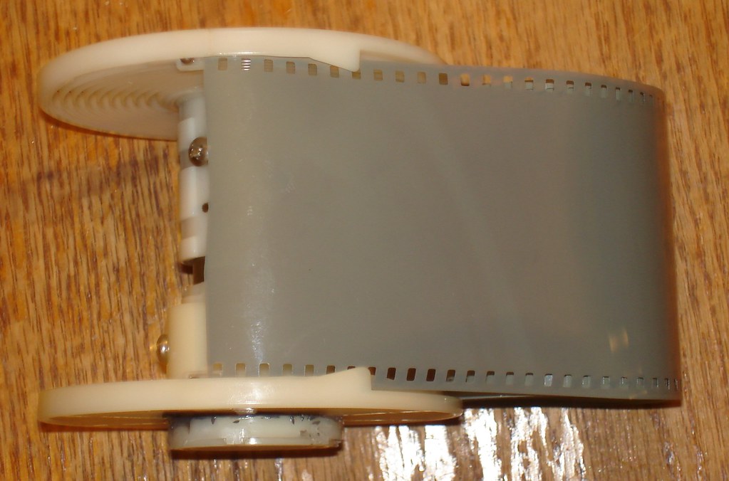

Step 5 Use a dummy 220 70mm roll to set reel spacing perfectly by Nokton48, on Flickr
Assemble the reel, and use a 220 length of 70mm film to set the spacing between the two spirals. Do not be in a hurry, this one goes on smoothly without any issues whatsoever. Roll the complete dummy film all the way on to the reel, make sure you are well satisified how it is going
Step 6 Practice winding full roll onto reel until you are satisfied by Nokton48, on Flickr
When you are well satisfied that the roll goes completely smoothly onto the reel, remove the film carefully, and then drill and install the three stainless steel screws to lock everything down on the second spiral. After final assembly, make sure to try loading the roll a few more times to make sure all is good.
The reel is now ready for use in the small Paterson tank.
