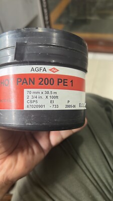

Currently only found from sellers in India. Agfa Aviphot aerial photo emulsion. Or wait for the annual Ilford/Harman special format sale (probably not especially cheap). Fairly high contrast. Proper development is discussed there:

Neither options are cheap, but not outrageous either, and they're guaranteed to be well stored & good quality. The India-source Aviphot is hit or miss. The ones I have have been fine, but I've heard of others getting bad rolls.
