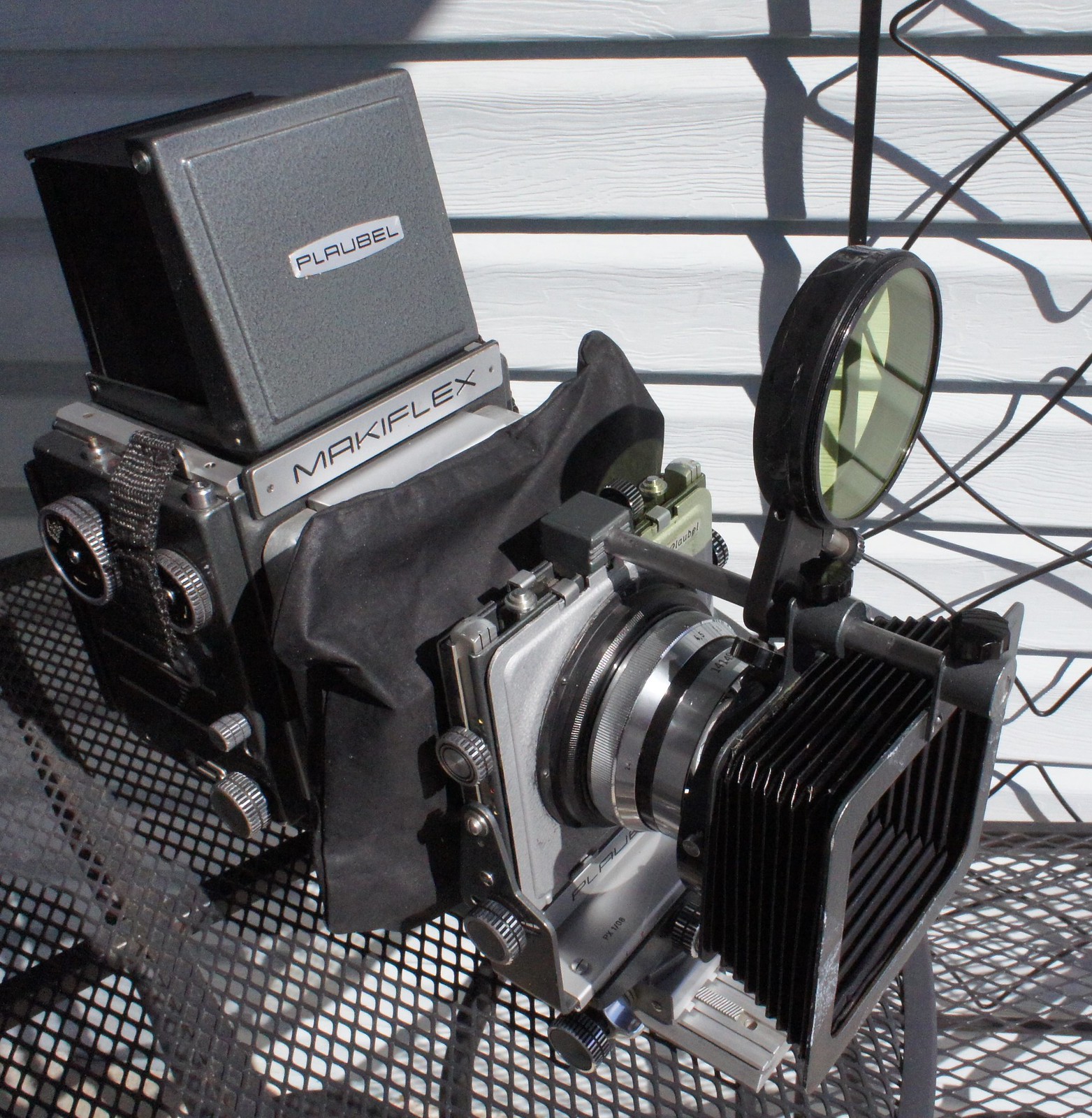

6x9 Rollex Restored Compendium Russian Filter 2 by Nokton48, on Flickr
This is basically a Plaubel Peco Junior front section, with the Plaubel Makiflex Adapter on the Automatic Makiflex. I made the custom bag bellows from a Plaubel Bag Bellows found cheaply and completely built, took about thirty-two small brass hobby screws to hold it together. Then glued together and painted flat black.
Easy pretty drastic moves are now possible. I agree with Glenn Evans, that the Peco Junior is certainly one of the most finely made 6x9 monorails. Actually it would be ideal for a digital platform. This is the best way to get reflex imo. Shown with the chrome Schneider 240 Xenar barrel lens. I made the swing out filter holder with Russina YG filter from a pile of parts I had in a junk box

I have had several Plaubel Peco Junior 6x9 cameras over the years and still have one. They are indeed very small precision cameras and easy to take in to the field. They are way smaller than a Cambo 6x9 and smaller than a Linhof and Arca Swiss. With the appropriate back they can shoot Plaubel 6.5x9 sheet film holders, 6x9cm and smaller roll film in Plaubel holders, and 6x9cm in Graphic film holders. They are fairly easy to adapt to other brands of backs/holders.
The one for sale in the link above in not wearing the original Plaubel bellows. This one looks to be an Arca Swiss bellows to me. The original Plaubel bellows are tapered and reduce the size of the camera even more than pictured in that link above.

The view camera front end that Nokton48 attached to the front of his Makiflex is from the 9x12/4x5 Plaubel Peco Junior, you can tell because his picture shows tilts on the front standard. The 6x9 camera has tilts and swing on the rear standard with rise/fall and shift on the front.
I'm doing ok for an old guy.
