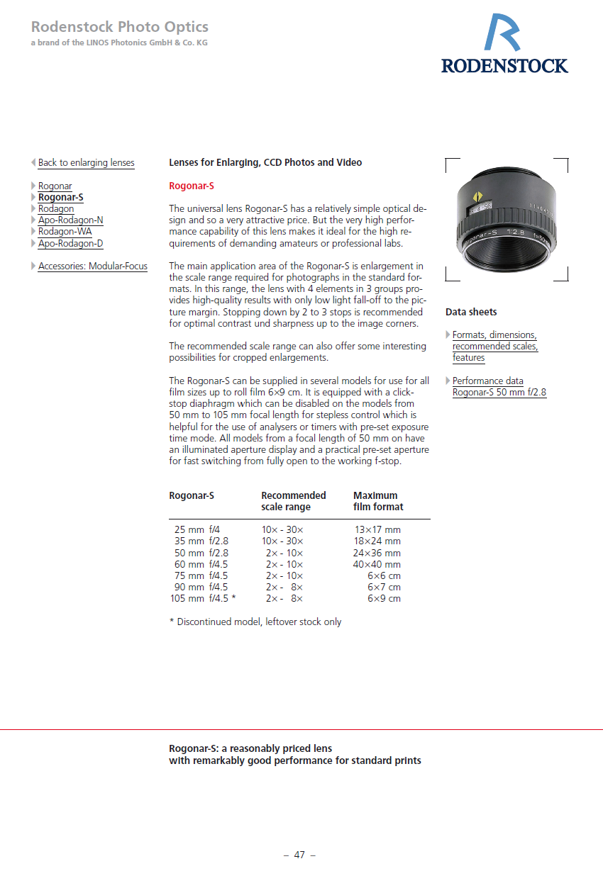

Thank you. Do you have any opinion on the Rogonar S 105mm f/4.5? I'm looking for a lens to enlarge 6x7 and possibly 6x9 negatives probably to no more than around 11x14.

The Rogonar is sort of bottom of the barrel. At today's prices there's no good reason not to get a Rodagon or an El-Nikkor.

Technical literature from Rodenstock is attached, it describes Rogonar S

Much of the difference in enlarger lens quality is concerned with the performance in the corners of the projected image. With a simple (few element) lens the illumination is brighter in the center and dimmer in the corners, this causes the print to be pale in the corners. The effect is minimized when small apertures are used. Sharpness in the corners is also a concern, to obtain it with a simple lens it is usually necessary to use small apertures.
The Rodenstock literature above states that the simple lens with fewer elements gives best quality closed down to f11. The more sophisticated lens with more elements maintains quality at larger apertures, f8, f5.6 and in some cases f4. The wider aperture gives a brighter image on the paper which translates into shorter exposure times.
It is common with even the best enlarging lenses for the widest aperture, that is used for focusing, to be slightly inferior quality, and exposures are made with the lens closed down one two or three stops from maximum to achieve the best quality. The best lenses can be used one stop down, second best two stops down, third best three stops down.
Earlier on ebay.com I saw several Rodagon 105mm f5.6 lenses (six element) that had sold for less than $50, prices for excellent lenses are very reasonable it seems.
