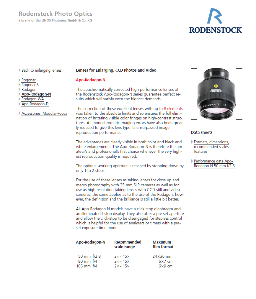

I lucked out and found a 105mm Apo Rodagon N for less than $200. Bought it on the spot and have been pleased with the results.
That said, I tend not to use glass negative carriers. So, it's unlikely that I'm getting all the benefit of such a fine lens.
Hi, Neil - are you using this for 6x9 negatives? If so, is the image circle coverage suffcient to have good light in the corners at wide (low no.) apertures?
Cheers,
Mike
tedr1
Feb 3, 2016
940
50 miles from NYC USA
This is from the Rodenstock datasheet

Thanks! Since I currently use a 135 for my 6x9s, I was wondering just how close to the limit of the 105 a 6x9 is in practice.
Cheers,
Mike

I've been using a Rodagon 105 for 6x9 and 6x6 for about 20 years. No complaints.
