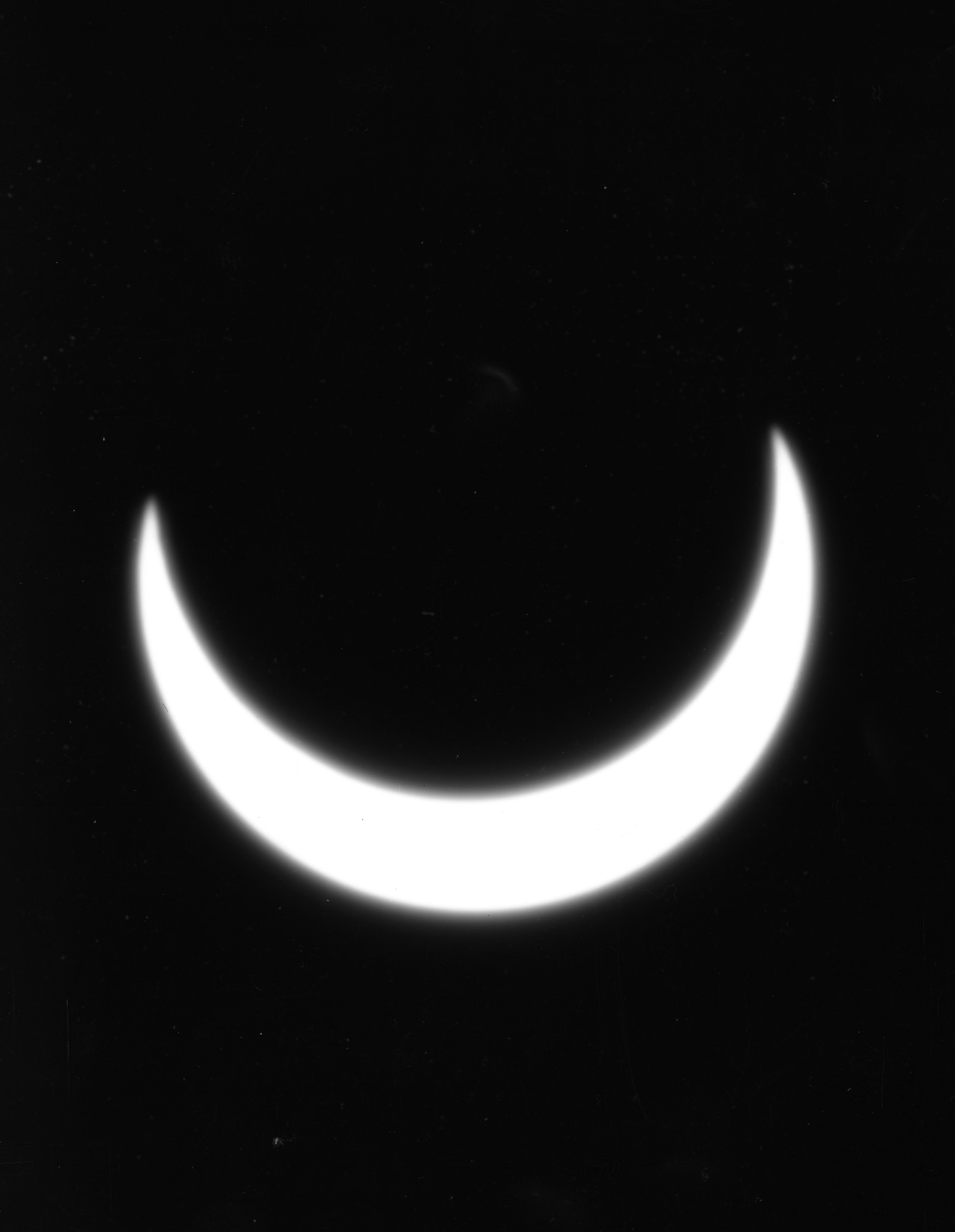

Just out of curiosity anyone ever use a long section of pipe to do pinholes of the sun?
Yes, with two 10 foot lengths of black plastic drain pipe with a .07 inch pinhole in a shutter at one end and an improvised sheet film back at the other. The top 1/100 shutter speed greatly overexposed 5x7 litho film. Sun diameter on film was just under 3 inches. The front of the camera was suspended from a telephone pole and the shutter was triggered by a string. Aiming was by centering the shadow of the front on a flange at the rear.
