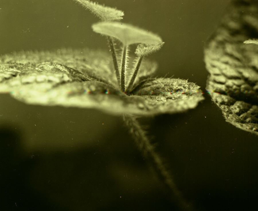

Its not an easy thing. But I used my RB Pro S with extension and a 180mm lens, hand held on this macro. I would use a tripod if I tried it again.
