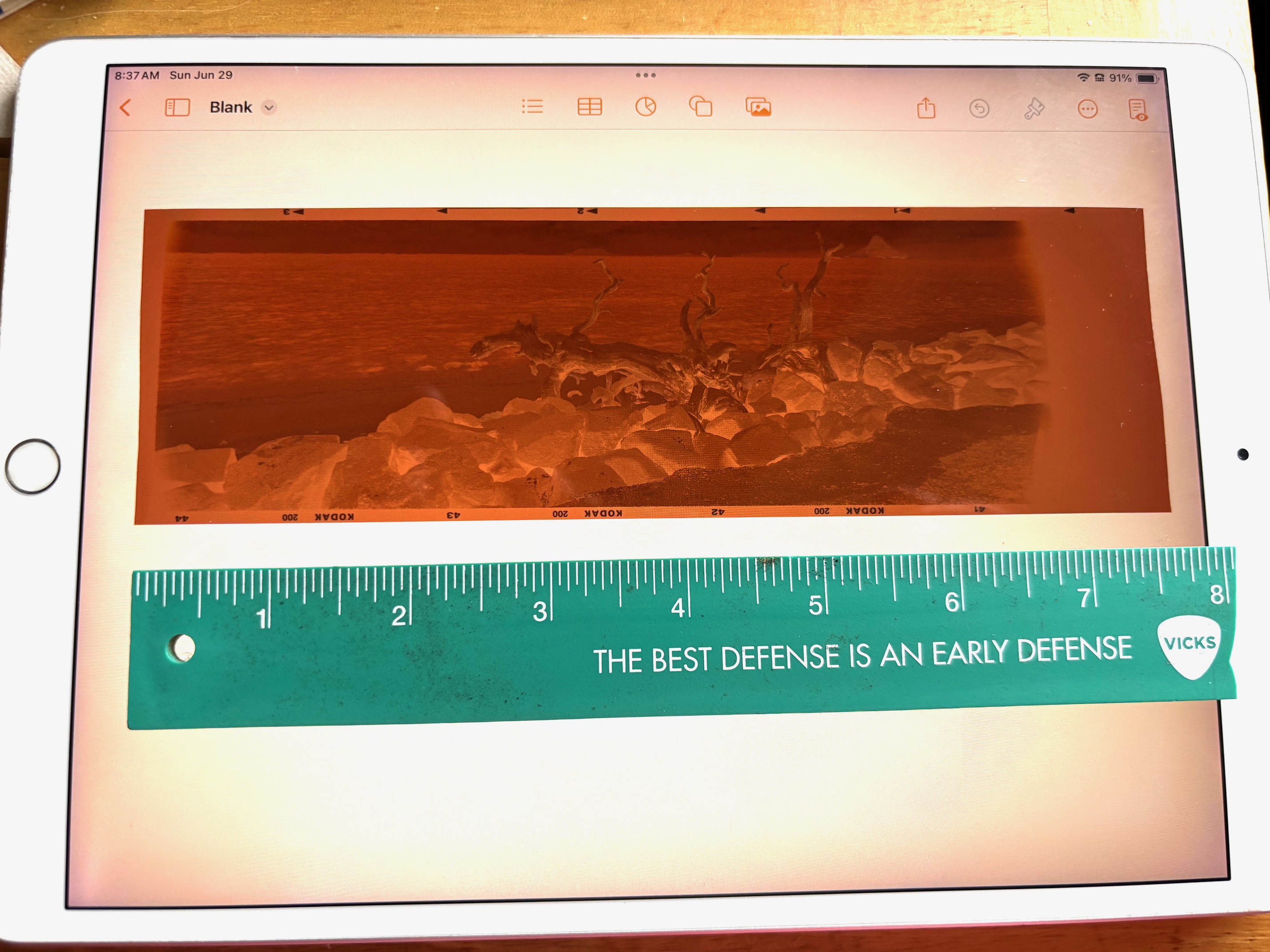

I have a 3D 6x17 camera made by Custom Camera Builders. It came.with a mounted 90mm Super Angulon f/8 lens. I have noticed that on some, not all, of my frames one end sometimes is not a clean verticle edge but slightly concave. It is always on the same side. could this be a misalignment on centering the lens in the cone? The lens is very sharp and works well.

Here is an example of the fall off. The fall off amount varies and this is one of the most pronounced. Some frames have no fall of at all. I’m am usually at f/45 on the lens.

It isn't that the end is concave. It is that a whole chunk of the end of what should have been imaged is vignetted.

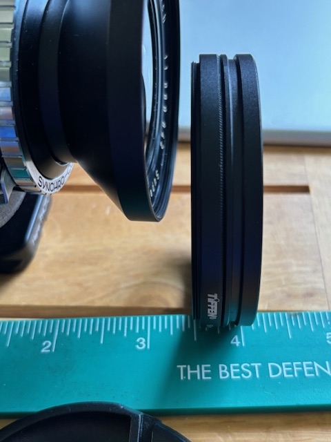

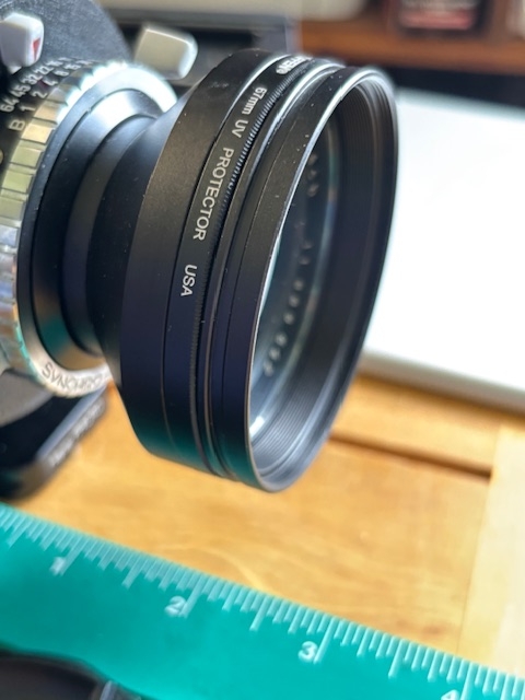

I have been reviewing all my negatives with this camera, and dates I bought the filter I’m using. My first roll before any filter is fine, no cut off. Dates on my notes taken when I used the camera show the filter going on for roll #2. That roll had two frames testing the rubber shade and show cut off with the shade extended. All the later rolls show some degree of cut off.
next step is to 1-not use any filter,and then 2-use Tiffen slim uv alone. On checking the specs on the Tiffen Slim filter is is not clear how thich the frame is. Hoya makes one that claims to be 3mm thick, so that’s a possible choice.
for many years I avoided any filter on my lens unless I needed to correct something. As time went on and my professional photography went towards news work I began to use protection filters. So now that I’m older and working slower I will not use filters. But my Super Angulon is in such new looking shape I want to protect it.
@OAPOli has a good point about filters. Also do you use lens shade on top of filters? To protect your lens, you can use oversized filters with step-up ring or go for the bigger square filters systems (like Lee, Formatt/HiTech 4x4).

While 90mm f8 Super Angulon covers 617 easily, there's only 17.5mm to the edge of the image circle on the edges.
I would say this is caused by rubber shade or by filters in some way.
If the lens was misaligned, it would have to be misaligned quite a bit to reach mechanical vignetting on this lens.
In other words, misalignment would be readily visible.
Rubber shade would be quite hard to use as they usually don't hold the shape very well.
Double filter on this lens will almost certainly cause mechanical vignetting.
This is easy to check by looking through the camera with lens open and looking from the corners through the lens.
If you can see the filter or the shade, they're most likely going to shade the image.
Shade on 617 can be in the view in this case from the top and the bottom as the image circle is mostly unused there and it would be beneficial there. Shouldn't cause any issues unless positioned too far.

Yes, this was caused by filters and/or hood. 90mm on 617 is very wide. I tried a double filter on a G617 (105mm) which caused vignetting.

I will test the camera without the filter+empty filter ring in a couple of days and post results.
but I have looked at the filter combo and I’m surprised how thick it is, around 1/2”.
after all my years doing photography I should have realized that this is too much for this lens.
