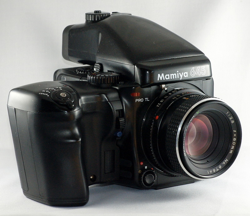

6x6 TLR's like the 500C and S2A, even with a prism, are clunky to use on their side. Adding a handle helps but at that point weight starts to really creep up.
Another plug for the Mamiya 645 Pro/TL - with the prism and handle its still less weight compared to a RB67 and handles like a standard SLR. I have both the metered prism and the non-metered with the adjustable diopter. I prefer the non-metered since I usually use a separate light meter and the diopter really helps me nail focus while keeping my glasses on.
I know it has a battery but if you let that one parameter creep back in I think you'd really like using that camera.
Also, with the way Pro/TL prices have been rising over the last couple of years, you probably could get all more more than what you paid if you use it for a bit and decide you don't like it.
If you were local to me I'd let you borrow one of mine to try it out.

Not only is that newer model Mamiya much more electronic than I want, it's at the very upper edge of my price range. If not a little out of it.
