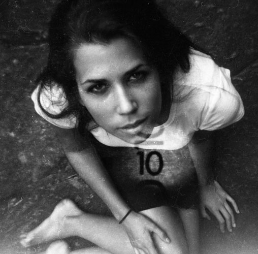

I went back and dug out the roll I shot
with the Argus -- it turns out not to have
been Tri-X, but a film without markings.
I am guessing Efke 100 but I am attaching
a rough scan of a frame with the number
burnt in through window and paper backing
-- perhaps someone can identify the film
from the design of the frame number.

I dont think anyone here doubted you, we only stated we hadn't experienced it, yet.
