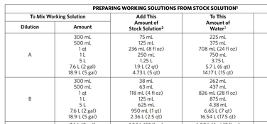

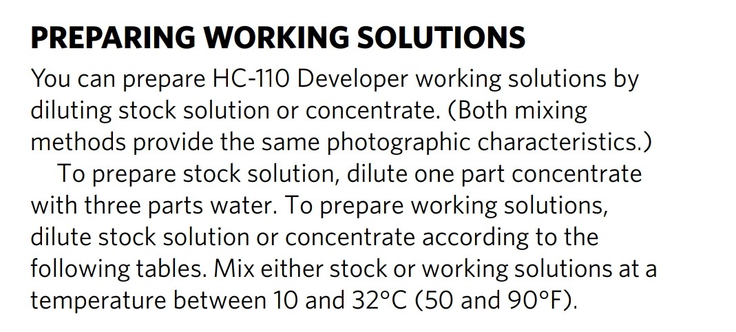

I made this thread a while back : https://www.photrio.com/forum/threads/new-hc-110-kept-surprisingly-well.210022/
About the syrup being difficult to handle and measure small quantities of : preparing a stock solution eliminate that issue, but it's surprinsingly not common practice at all among HC-110 users. See attached the relevant part of the j24 datasheet
