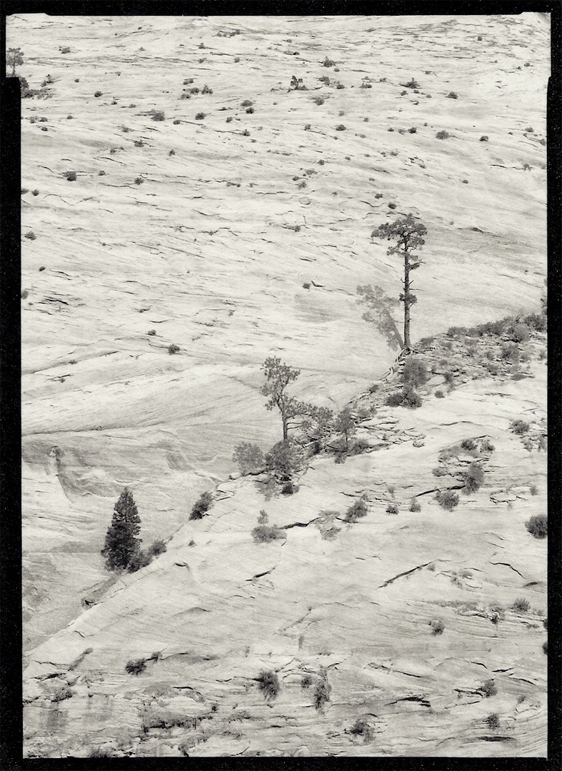

Attached is an example -- I keep all the image info with the negative. (and also the platinum print from the 5x7 neg for fun). I use them for 4x5, 5x7, and 8x10. Stored in appropriate-sized clamshell boxes.
