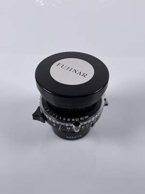

If you are serious about this lens, this seller is very reputable, I've bought more than a few items from him. If you click the best offer, you might be able to nick 10% off the lens price.
Just to avoid even MORE confusion, although the seller refers to it as a "Fujinar", it is not. The front cap is from a Fujinar lens. There never was a Fujinar 250mm f6.3.
