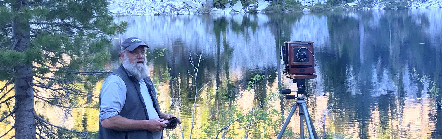

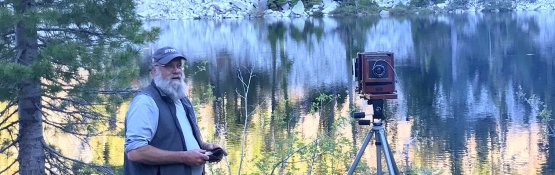

From a previous backpack trip...5x7 platinum print. This was about a 4.5 mile hike in, with the trailhead fairly high up in elevation. I carried the camera on the tripod in my arms...which ended up being no fun, but I had to have room for the two or three pints of beer in the pack. The first few miles were the steepest, of course, and that section also had a lot of down trees across the trail from a fire a couple years earlier. The lake was a welcome sight.
Thank you very much for this knowledgeable reply. Nice photograph.
