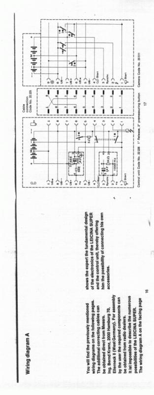

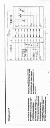

This schematic for the external controller and instructions how to open the camera up, may be of help.

Bill, ic-racer's post #21 in this thread contains links to a few pages from the Leicina 8s and 8sv service manual. These are both 8/8 cameras. None of the pages is particularly relevant to the OP's major concern, dead motor and dead electronics. They do, though, make the point that there's little in the way of electronics in those cameras.
