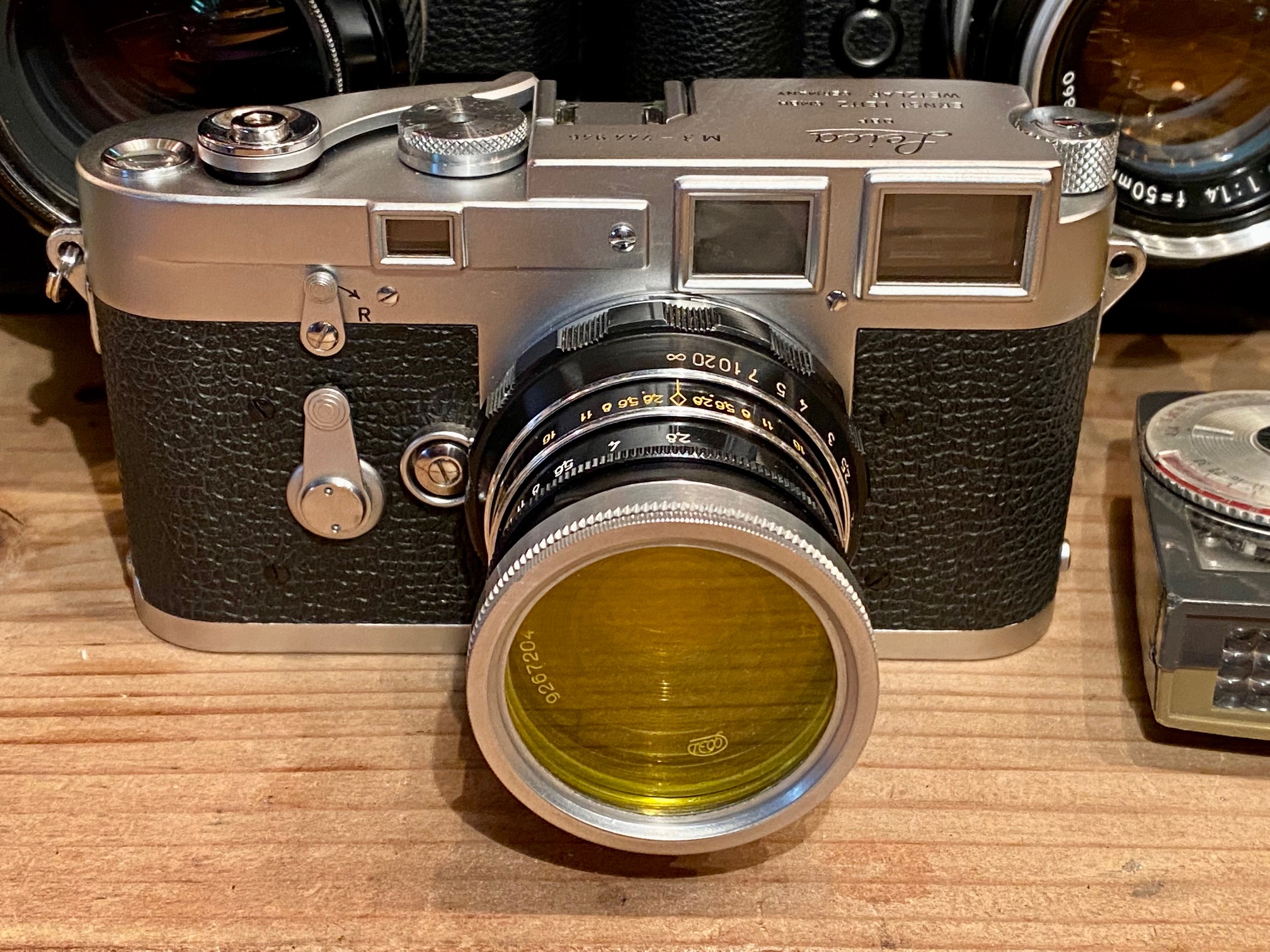

Well, I have a solution for now. Thanks to AnselMortensen for offering an Industar-61 that needed a little work, I have a functional setup. The lens and adapter were far less than my anticipated ~$300 budget. Despite the potential focus inaccuracies, manufacturing variance, etc. I’m willing to state on the record that the Idustar is a good lens. Not great, but certainly good. I might try to fine-tune the close focus, but that’s just because I like to mess around with this stuff.
The lens was a bit stiff, but that was remedied with disassembly, cleaning, and new synthetic grease. It’s 10X better than before. I also attached a clear Series VI filter to the front with a strip of black electrical tape (an old trick I’ve used for years on other lenses) with a Series VI extension ring over it. Now I can easily attach any of my colored filters.

This is an ideal solution for the meantime. It gets me outside with the M3. Better to use a cheap lens than none at all. And after thinking things over (and over and over and over again) the lens I really want is the DR Summicron. It was on the first M3 I ever held, and it’s part of what drew me in. The size, image quality, mechanical precision, and ability to close focus would really make the M3 a do-it-all rangefinder for my purposes.
