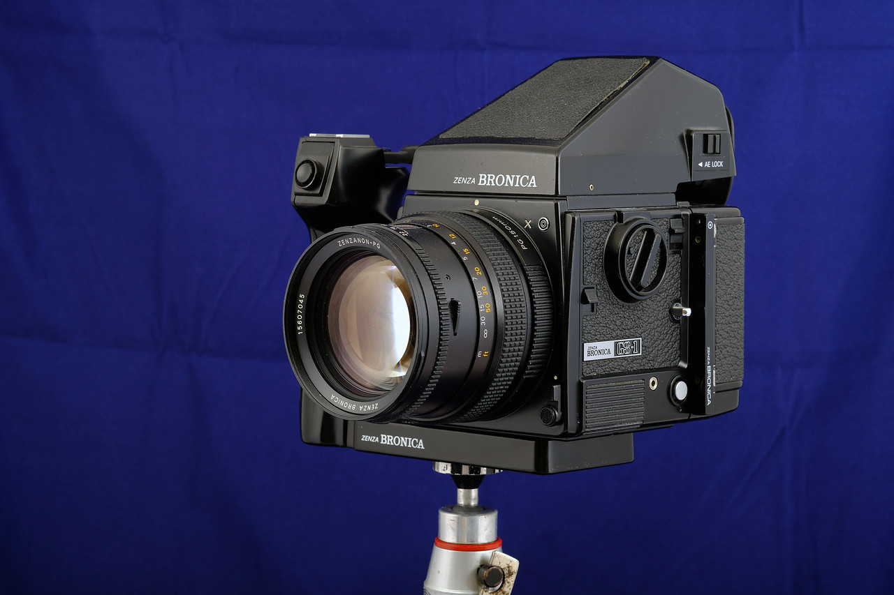

I just received my 50mm f4.5 PG lens for my Bronica GS-1. I can't try it out right away since my camera is at my cottage and the lens and I are at home. I'm headed to the cottage tomorrow and wondered if there are any special tips I should know or be aware of with the 50mm? Second question is I want just a three lens kit and will need a short tele lens to go with my 50mm and 110mm Macro lens. I'm thinking 150mm or the 200mm? Any help there? Many years ago I bought a Hasselblad 500C w/ 80mm then added the 50mm and 150mm I really loved that combination for all the weddings I shot. No more weddings, so the shooting I do is mostly scenic with a portrait thrown in from time to time. I'm leaning more toward the 200mm unless I'm missing something that would push me more toward the 150mm PG lens.

I've got the lenses discussed and find that I use the 150 far more (mainly because it's more likely with me). The 200 and 250 share the same hood which saves a bit of volume when headed out fully equipped. The 150 is so compact that it makes things much more manageable and can be used handheld in many situations.
