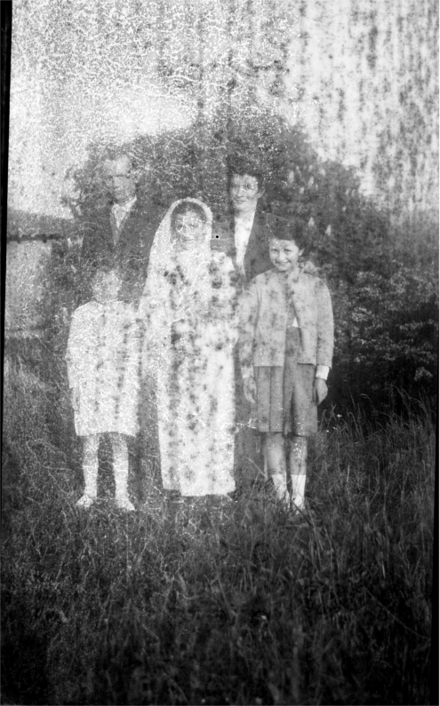

I developed a very old roll of 120 that was in a Voigtlander Bessa folder, purchased at a flea market. This https://foundfilm.livejournal.com/16982.html was a very helpful blog post, and I followed most of his suggestions, using HC110.
The film was unknown, it was in terrible shape, but still, there were a few latent images that came through, enough for me to approximate the age of the film and camera. These are scans of the negatives. It's easy to see just how damaged they were, but there is enough to be seen in the clothing styles to give a rough date of late 1930s and into the early war years. I found it both moving and sad that these images of some sort of family celebration, either a first communion or marriage (a friend and I disagree on this question) had been left in the camera for probably more than 70 years, and were never seen by those who are pictured. What happened to them? Who took the picture? Why was the film and camera forgotten, to grow old and musty, and end up being bartered for at a flea market? Who knows, they are just some of the unanswered questions I have, but will never have replies to.
So good luck developing those rolls of film, they'll probably be very worthwhile doing, especially since you know more about the films themselves.

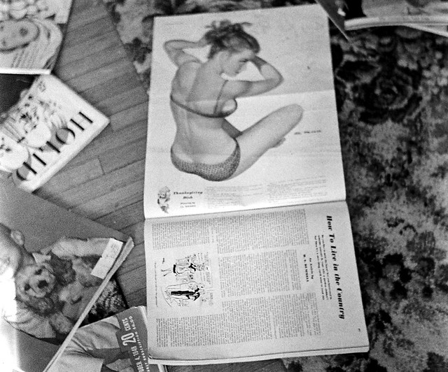

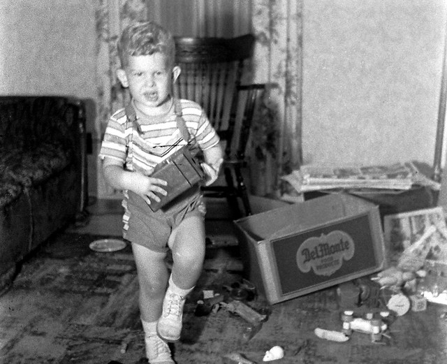

Of the nine rolls of film I have processes three. I started with my "go to" developer - D76(stock). I processed two rolls at different times (7:30 and 6:00). The images looked good, but there was a lot of base fog (OD = 0.47 and 0.58 respectively). The third roll I processed in HC110 (1+29) for 4:30. The images also looked good, and base fog was equal to 0.35 OD. On this basis I may use HC110 to process the remainder of the rolls.
I have not had time to print any of the images, but they look very printable. If there are any images that I am interested in printing I will post an example.
It is fortunate that these films were kept dry and in a dark place. There is not any indication of abuse (mold, mildew, ...). I have found several interesting things.
1. Each roll only has 11 exposures, not the normal 12.
2. The images are correctly viewed with the film strip horizontal.
3. Lots of "photographer error", mostly unsharp landscape exposures. The family/party photos are sharp.
4. No. 1 & 2 above make me wonder what camera was used to expose this film. Any ideas would be welcome.

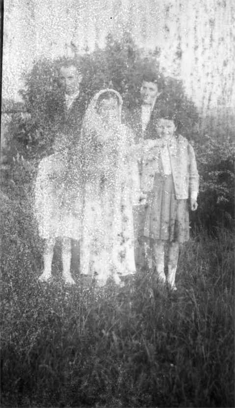

... there is enough to be seen in the clothing styles to give a rough date of late 1930s and into the early war years. I found it both moving and sad that these images of some sort of family celebration, ...... Who took the picture? Why was the film and camera forgotten, to grow old and musty, and end up being bartered for at a flea market? Who knows, they are just some of the unanswered questions I have, but will never have replies to.
If there were some sort of "lost photos forum" on Facebook or other common social media, there's a chance a family member would recognise them. Although the little girls in the photo are probably in their 70's or 80's, it's likely their children or grandchildren will have seen other similar photos of their family - for example, I easily recognize my grandparents in old photos when they were young and would spot them in any discovered photo.
