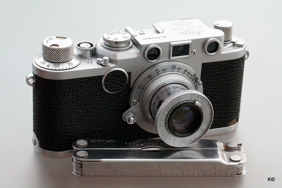

The reason I haven't added the Bessa R is because I can't readily find a body and a lens in good working condition for under 200$. I want people to be able to refer to this list as a way to get a complete RF setup for under 200$, and while I suppose that is possible by getting Russian copy lenses, that pricing still seems like a stretch to me personally...
In 2012 August I purchased Bessa R with perfectly matching Jupiter-8 on it for 250 CAD (CAD is bellow USD) locally. Used hell a lot of it across Canada and USA, daily, hot sunny days and freezing winter. Sold for 175$ at RFF after couple of years in 2014, it was worn out cosmetically, but absolutely working.
Those old single lens RF cameras you are pushing here as under 200 are actually under 100, BTW. Most of them will have issues due to their age and old electronics. And to be honest, they are something what I look at and don't even want to get into my hands. I prefer Leica IIf with (reshimmed) Industar-22 for under 200
and FED-2 with Jupiter-8 for well under 100$ (and 100% DIY serviceable) with free exposure meter in the phone solution to non-TTL meterring cameras you are wikipediing here.
Yes, if you are poor man it is still possible to have true Leica under 200$, not just something with RF and somewhat lightmeter in it.
