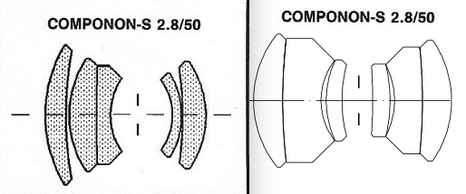

In none of my Componon-S data sheets is the number of elements stated by words, but all show a lens-sketch for at least the whole range of lenses and all these sketches show 6 lens elements.

Hi AgX,
in my data sheed the pictured section shows clearly 5 elements in four groups.
It looks similar to the 2.8/80mm Xenotar on a Rolleiflex TLR. Not a plasmat type like the other Componon-S variants from 80mm on.
Is there anywhere a lens section (Linsenschnitt) pictured for exactly the 50mm showing 6 elements?

Dedicated Componon-S 50mm 2.8 data sheet
Version 2, November 20th 2008

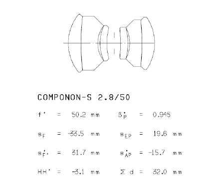

Jens has very kindly scanned his data sheet for the 5 element Componon-S 2.8/50 and sent them to me. I've created a pdf and put that online to share here:
http://photocornucopia.com/archive/CompS_5E4G_2f8_50/CompononS_5E4G_2f8_50.pdf
Unfortunately the data sheet doesn't give product codes for the lens so a bit more research is needed to differentiate the 5 and 6 element versions. If anyone can pin down the product code(s) for the 5 element version please let me know.

This diagram might also be of interest. It shows some five and six element Schneider Xenotar and Planar lenses to go along with our five and six element Componon-S lenses.
