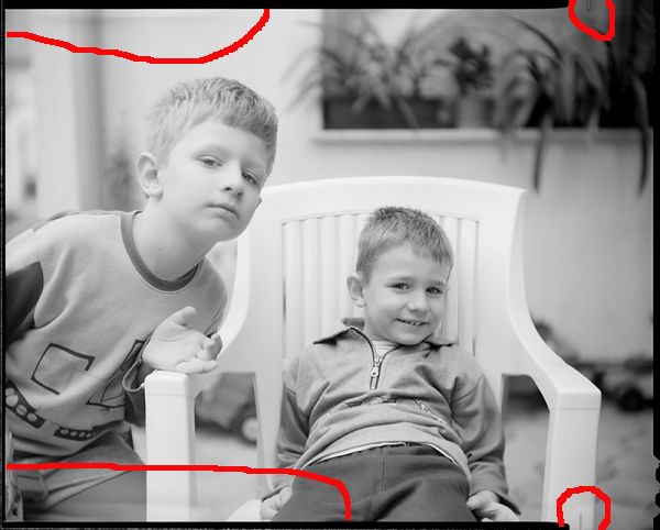

Hi folks,
I developed my first 4x5 negs only a week ago, and was quite happy - I used Jobo 2523 tank, and a variant of "tacos" system - i.e. I just "fixed" the 2 negs to the inner wall - see my thread "My first time! (in 4x5)" in "LF cameras and accessories" forum:
That came out quite nice.
However, a couple of days ago I finally got the Jobo original 2509N reel (purchased new), and developed 4 negs mostly just to see how it will work out. No problems with loading even without the leader.
However, the development wasn't quite even. I got some streaks on the edges of the negatives. Attached are two examples, scaled down, but the streaks are still visible.
Another thing is that in the right-hand corners of the scans you can also see some kind of imperfection in development, like a kind of "wedge" in top and bottom right corners.
I'm attaching two scans to show what it's all about.
Just to make it clear, I used the 2509N reel "by the book" - i.e. I also attached 2 "flaps" properly, as per instructions, with the "4x5" inscription facing outwards, i.e. with the tip of the "V" shape facing towards the center core.
The streaks could be due to uneven flow of developer - but the "flaps" are supposed to ensure evenness, right? What's this then?
The "wedges" in the right-hand corners might be due to negs touching those "catches" on the reel which prevent sheets slipping out... I guess.
Any ideas how to prevent this happening in the future? Or should I just forget the 2509N reel and use my DIY system as described in the previous thread?
Any suggestions appreciated!
Denis

I had these really annoying density patches and marks along the edges just as you have using these reels. I even thought of ditching the reels altogether because on some negs - especially those in the inside slots - the marks cut into the image far too much. I decided to tackle the problem, and now my negs are totally perfect, and are as good as any I have seen.
The marks come from un-even development at the edges, either under- dev'd or over due to 2 things - the little plastic pips all along the slots, and the neg surface touching the side of the slot during processing. The first thing is easy to cure. Just get a new, sharp scalpel and trim down the little notches - they are much bigger than they need to be. I cut them from being squared shape to triangular so they have much less contact with the film surface. Have a go at this, it goes a long way to reducing the messy edges.
The second thing - keeping the film surface away from the spiral edge is a bit trickier. I ended up glueing with epoxy little plastic 'pips' almost 1mm big around the spiral edges - about 3 per slot side, spaced out at the points where the film touches the sides - have a look with a duff sheet of film loaded in each slot - it does touch, and this is where the light streaks appear on the neg to give you dark streaks on a print. This is where it needs 'lifting' away from the spiral. If you feel brave this is well worth doing, it makes loading the sheets a little more difficult, but its permanent, cures the problem and makes for pretty perfect negs.

Forgot to mention I always got the streaks on slow or fast speed, pre soak or no pre soak. After I hacked up the spirals each spiral takes 6 sheets no problem. It really is down to un-Germanic poor design of the spirals, like they designed and made them without testing edge effects at all, or perhaps they thought all pics should be cropped top and bottom.

Richard,
After careful checking with a scrap sheet of 4x5 negative loaded in the reel, I think your explanation/solution is the closest to the mark. I can clearly see where the sheet comes in the contact with both the "pips" (which left the wedge-shaped marks on the negative, visible on the right side of the first scan, both in the upper and lower edges), and the spiral (which resulted in streaks with higher density - i.e. lighter areas along the edge in the scan).
Modifying the reel a bit, following your advice, might just solve this....
