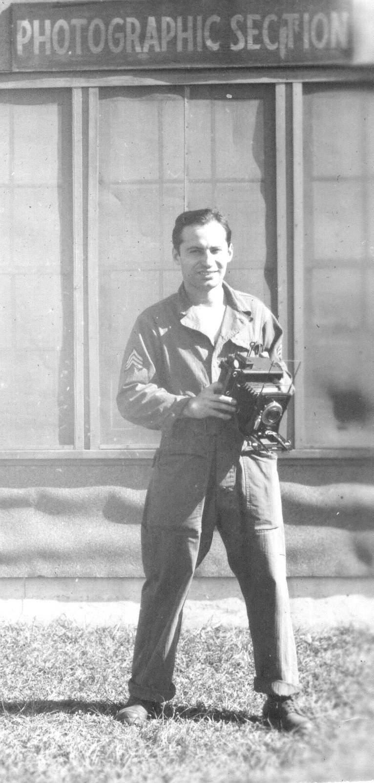

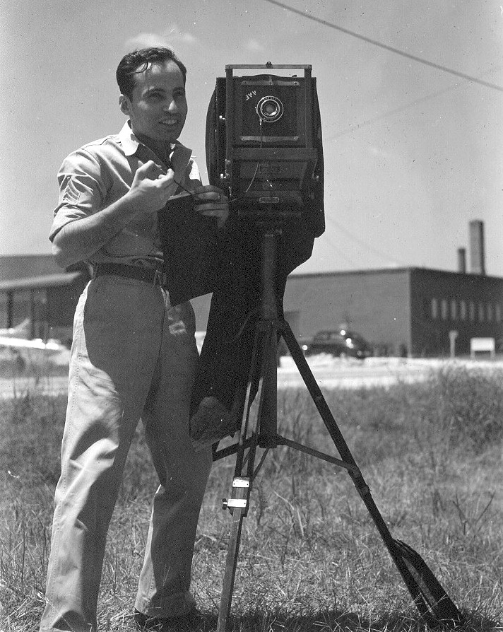

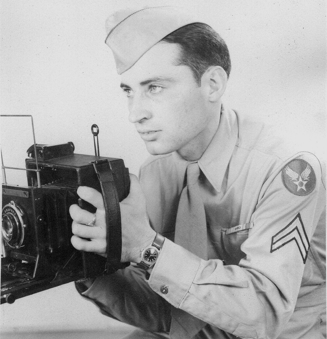

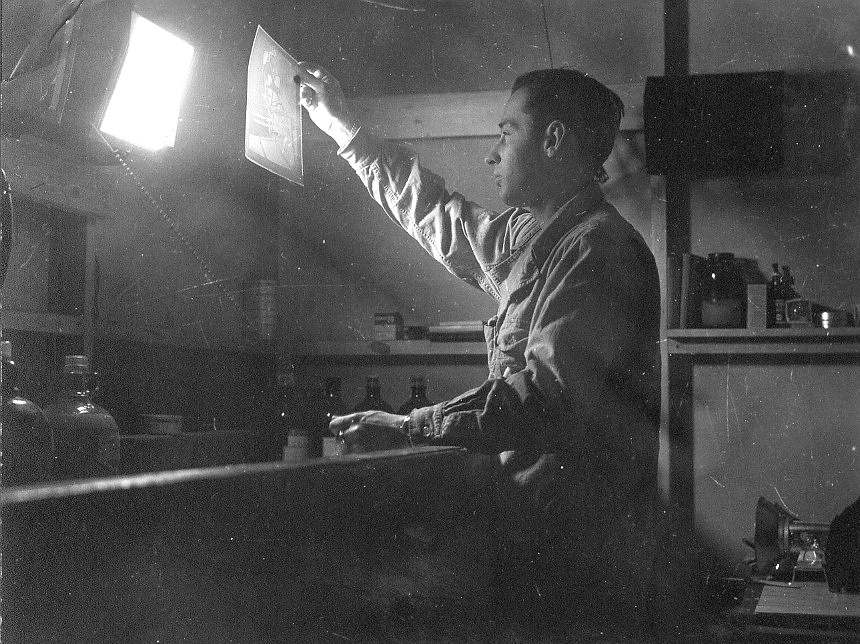

My father was in the Army Air Corps, and he quickly gravitated to photography during his service, having already been an amateur before the war. He was mainly a darkroom guy; his last assignment - he was a sergeant by then - was running a darkroom staffed by civilian women in Gulfport, Mississippi. Anyway, I never heard him mention roll film cameras/film other than the 70mm aircraft recon cameras; I got the impression that pretty much everything was sheet film.
Pics are from 1943-45, including a gallery show he did in New Orleans.
After the war, Dad was a pro photographer for over fifty years... and he always remained a sheet film chauvinist. We did some jobs on 120 with Mamiyas and 35mm with Nikons... but anything "important" was always shot on 4x5.
