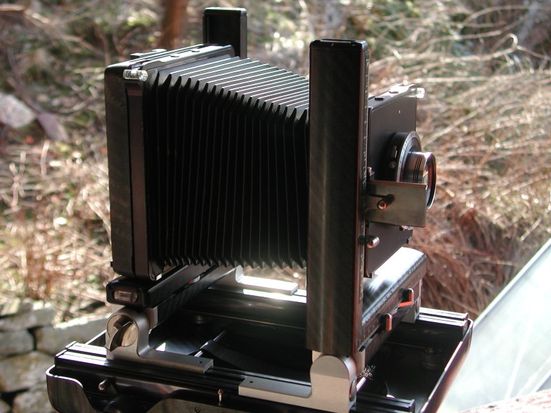

I'm using Opera on a Vista PC, so I think you should be able to find the same data. But they can be a little tricky to find.
Anyway, this is what a Carbon Infinity looks like. There are much better pictures at http://www.galerie-photo.com/carbon-infinity.html - and it's even the very same camera.

Very drool-worthy!
This must be the Bugatti of view cameras. It even looks racy.
But at US$6500, it is too much of a strain on my pocketbook, and at 3.75Kg, too much of a strain on my poor back.
