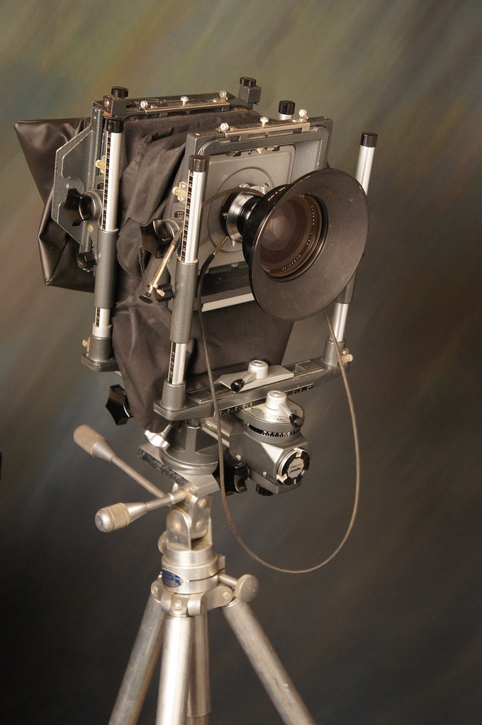

4x5 Plaubel Peco Profia 90mm F6.3 Komura Original 90mm Komura Hood by Nokton48, on Flickr
The lens hood cost nearly as much as the lens! LOL
Plaubel Peco Profia 4x5 ready for shooting architectural, Profia Bag Bellows, ingenious clamping 4x5 film holder (best I have seen!), Profia Monocular Magnifier/Bag Bellows on the back for stylish comfortable viewing. In the original Profia catalog is the 90mm F6.3 Komura in Seiko Shutter. The Lenshood for this lens is humungeous and attention getting. The Julius Shulman inspired modded Leitz Tiltall tripod is perfect, quick and dependable to use, quite solid after a few seconds. Sharp enough to make big prints. I also have the matching 75mm F6.3, the humungeous companion to this lens. Both of these lenses recess into the Profia Recessed board, this board will also accomodate all of my Makiflex boards, and also my Peco Jr boards, with the additional stepdown board, which I cobbled together with stuff from the parts box.

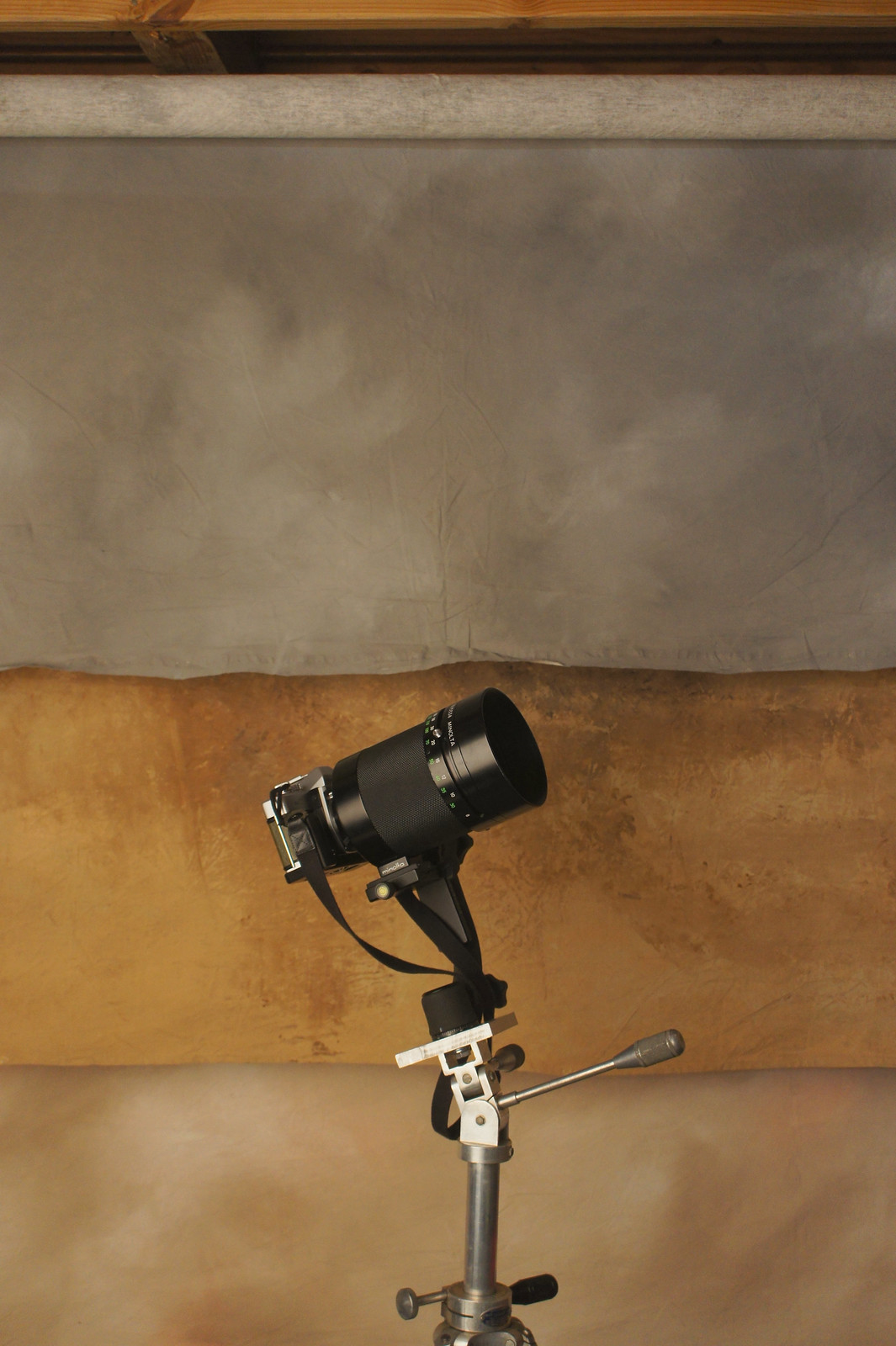

80cm Rokkor Cowboy Studios Gimbal Modded Leitz Tripod by Nokton48, on Flickr
80cm F8 Rokkor, Chrome SRT-100/Kangaroo Green, Cowboy Studios Gimbal Head, Modded Leitz Tiltall Tripod. Should be steady enough considering mirror lockup being utilized, and an SRT Cable Release as well. This lens will be coming up in my 800mm shoot-out. The 400mm Rokkor-X MD F5.6, with Matched 2X Converter, makes an F/11 aperture. This lens was a speed demon at F8 80cm :smile: One Stop Faster. The SRT100 only goes to 1/500 and no MLU, Will switch bodies to BD SRT101's. SRT100 is still my fave.

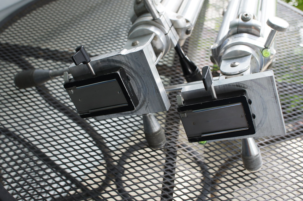

Hasselblad Quick Release Plate on Shulman inspired Letiz Tiltall by Nokton48, on Flickr
For Digital and Film Hasselblad Shooting, these Olde Leitz Tiltalls, modded and inspired by Julius Shulman, fit my needs greatly. I can use these on view cameras, it's pushing it but it works! But attaching two Hasselblad Quick Releases, these become about 1000 times more useful to me. Also I sawed a 9/16 round wrench in half, and attached it with white gaffer tape, to the tripod leg. So I have a way to tighten this up out in the field. Now this rig has no downsides and is super useful to me.

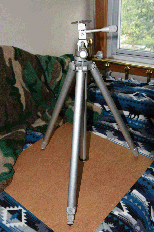

Hacked Tiltall Tripod No 2 by Nokton48, on Flickr
Here's Tiltall #2 which arrived yesterday from Tennessee. It took about twenty minutes to cut the holes and remount the other half of my aluminum block. To finish it I will enlarge the center hole for a 3/8" steel bolt, then the cleaning up of both tripods will be the final project. These hold up very well for their age and both of these fully functional (no broken or missing parts). Both of these are identical to the tripods in Shulman's book so the design has been time tested
When you modify the mounting plate like this, are you drilling through the original plate and bolting the home fabricated plate onto it? Or is there some other connection mechanism that I’m not understanding?
