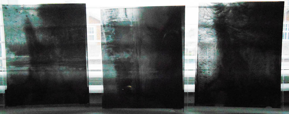

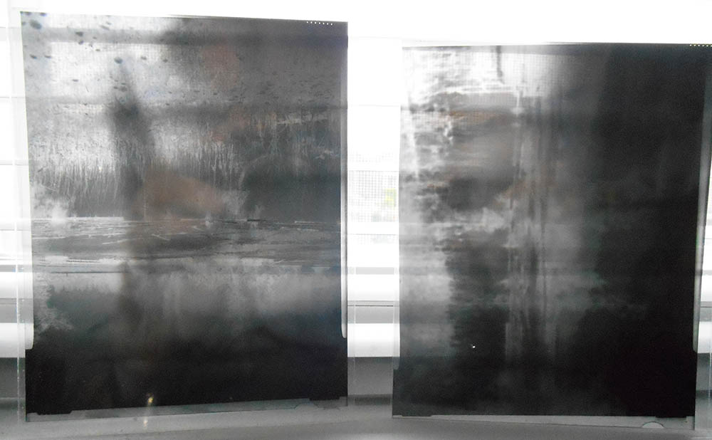

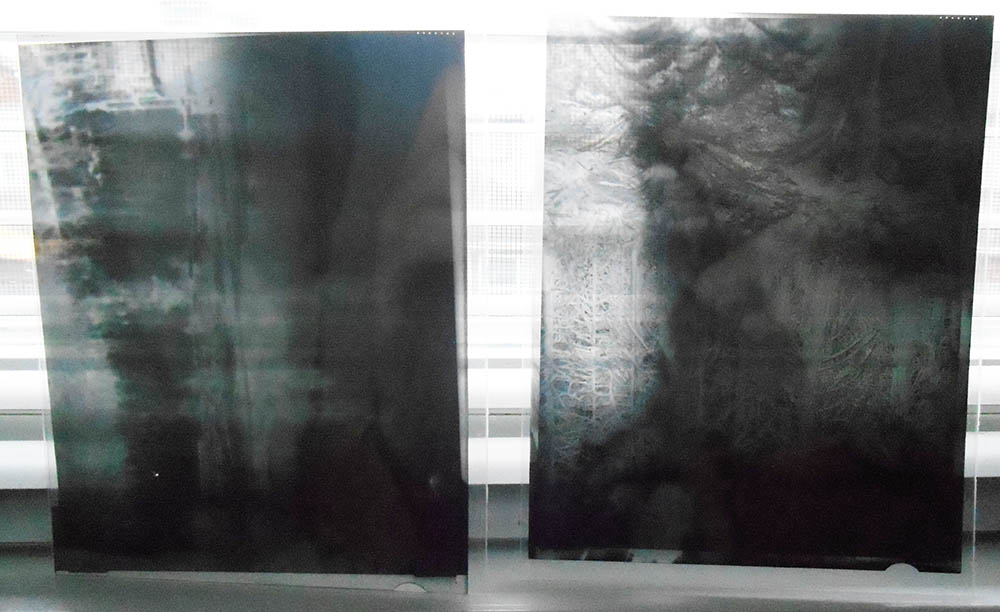

I just took a look at the sheets. Its not exactly the same in all of them, but at least it seems to be on the same side. The 4th sheet was completely fogged due to my error when I took the picture (forgot to stop it down). So Im showing 3 sheets here.

Did your film go through an airport? The new CAT-scan type x-ray machines can leave damage in discreet lines like those (or even sharper).
The fogging of the rebate seems to indicate fogging of the film while it was out of the holders.
