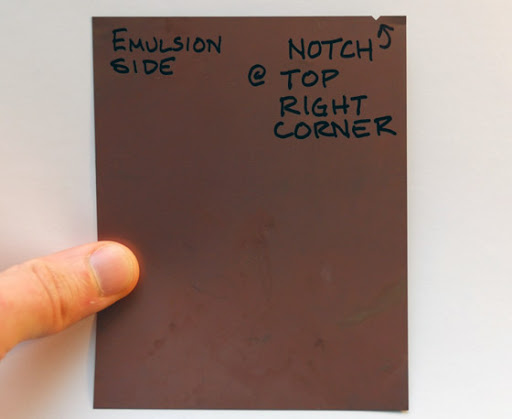

To avoid ambiguity, here's a picture illustrating what lantau said for film
