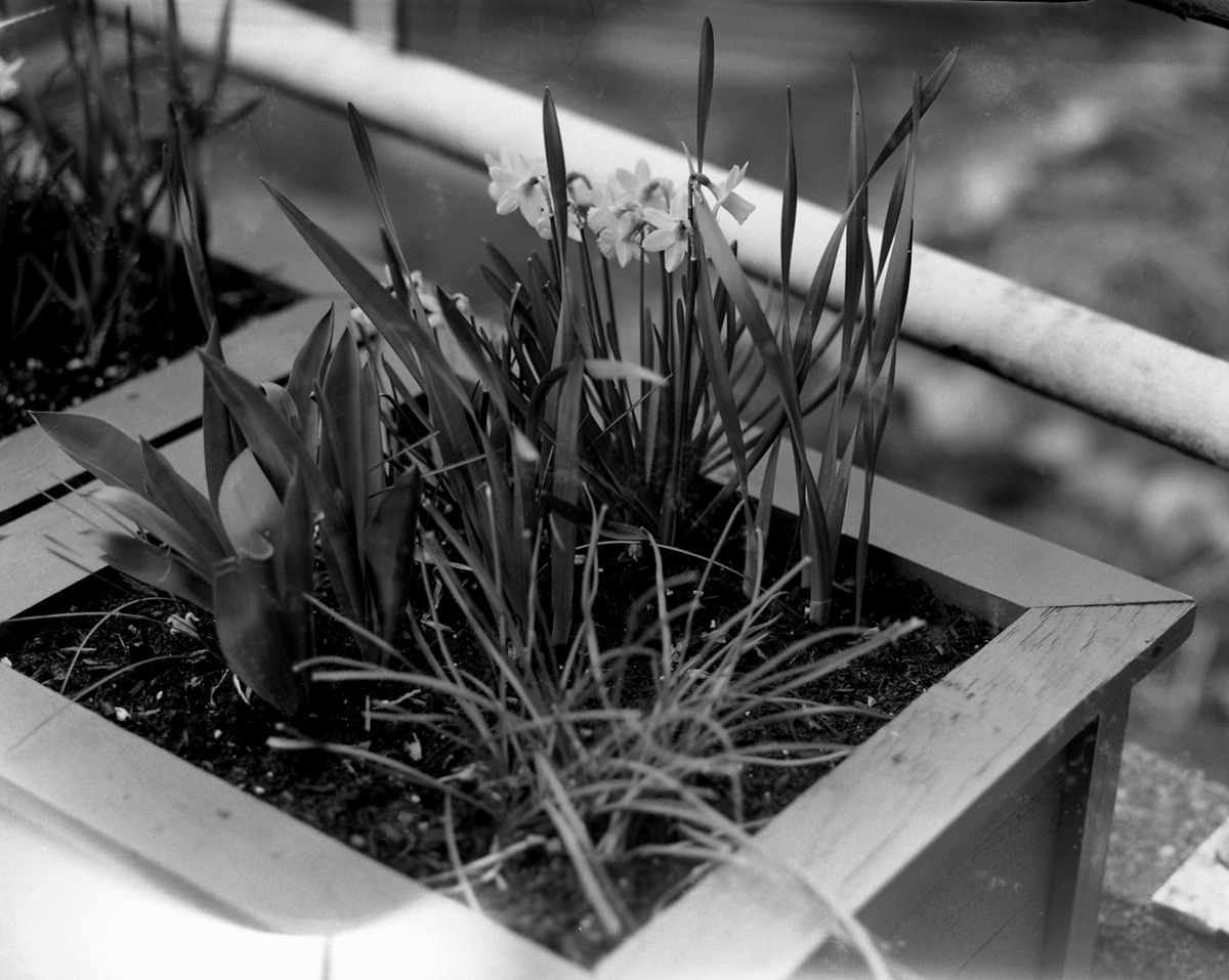

I am just starting out with 4x5. I have done 35/120 for a great part of my life. I have been "given" 4 holders that always leave light leaks on the negative. Is there anyone out there who has film holders 4x5 that are proven "sealed" ? I only need maybe 2 for now so I can see what it is like to make a great 4x5. I live in W/Canada so shipping will be the biggest deciding factor. I have invested in the camera, lens, enlarger lens and 100 sheets of film only to be discourage by the holders. Maybe that the marks are left by something else but people here and in LFP think as I do. Someone must have some proven light sealed 4x5 that are just taking up space in their collection. And NO I do not want your "free" ones as I have paid shipping across N America for crap.

If you're just starting out, then the first thing you need to know is to pull the black cloth back over the camera back as soon as you pull out the dark slide, especially if the slot is pointed up. All film holders are to be considered leaky, even when new. Don't just walk around with a Graflex for instance with your dark slide out. Also be sure it's not the dark slide at all, but the spring-back of the camera, the felt, and how much back pressure you put on the film holder while slipping the slid in and out. Film holders get blamed for light leaks and sent to prison, when they were innocent, all the time.
Been through this before. Black cloth is always completely over the back & bellows whenever the holder even comes close to to the spring back. Spring back is good. Light seal (felt) on the back has been changed. This was probably the + or - 10th photo done with this camera. Each time I tried I eliminated the probable and was always only thing left is the holder.
OK. I've seen the Riteway holders do this with the most frequency. Lisco Regals do pretty well. If that helps. Next thing is to get out all film holders and inspect by pulling dark slide out and looking for leaks through the slit with a bright source. Also check tapes on opposite end for pinholes whenyou open them. And see thet these end flaps do not have a lot of slop in their hingeing. Wooden holder should be summarily re-built.

Not all darkslides are the same width. I have a plastic graflex holder with a darkslide about 1/8" wider than a Lisco Regal darkslide. So check yours for any side to side play. Darkslides and holders often get mixed up over time.

Since no seller intentionally advertises leaking used holders, find an auction that allows a 14-day return. Buy some holders. Place a sheet of 4x5 b&w photo paper into each holder. Set them out in the light, over easy, like the eggs. Then process the paper and return any that leaked. No one can contest a returned leaking holder, unless the auction description originally stated they were leaking. Which of course it didn't.
