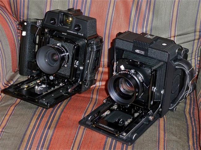

In 4x5 I went with a small metal camera (Horseman FA) as it is more compact than many wood 4x5 cameras. In fact the FA is not much bigger than a medium format camera.
But in 8x10 I went with a wood camera, due to availability and cost because lightweight metal 8x10 are rare and expensive.
