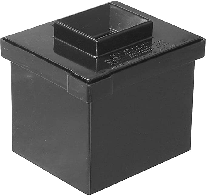

I use Yankee Plastic 4x5" Sheet Film Day Light Developing Tank
Only issue is that it takes a lot of liquid, but since I use home made Rodinal for my 4x5 not really an issue.
Pretty handy and easy to load. Also, sometimes I used it with my 2 1/4 x 3 1/4 film.

For those into stand development the Yankee daylight tank would ideal, Rodinal 1:100, gentle agitation by rocking, then go watch TV for an hour and dump, stop bath, fixer and wash which all be done in the same tank.
