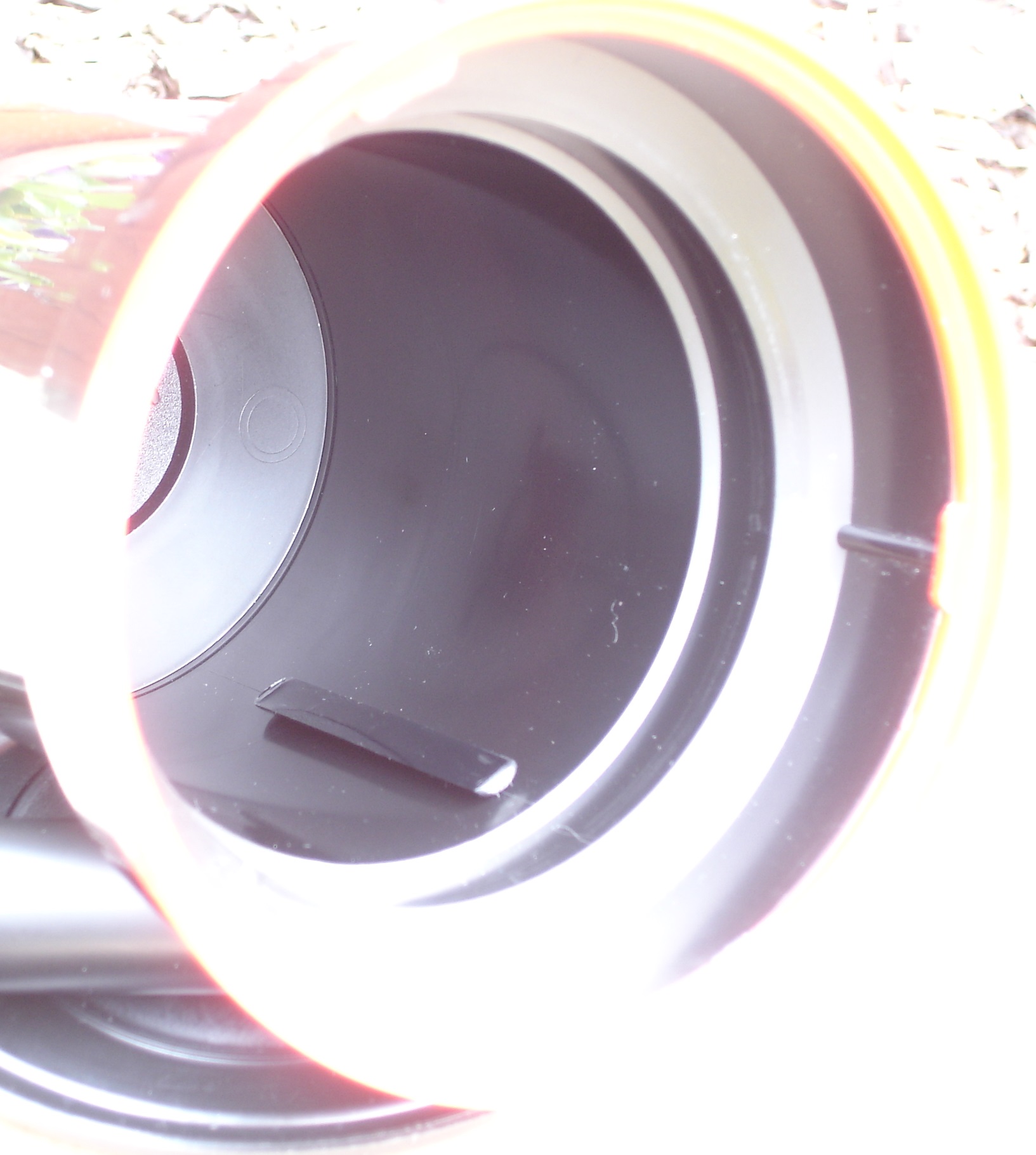

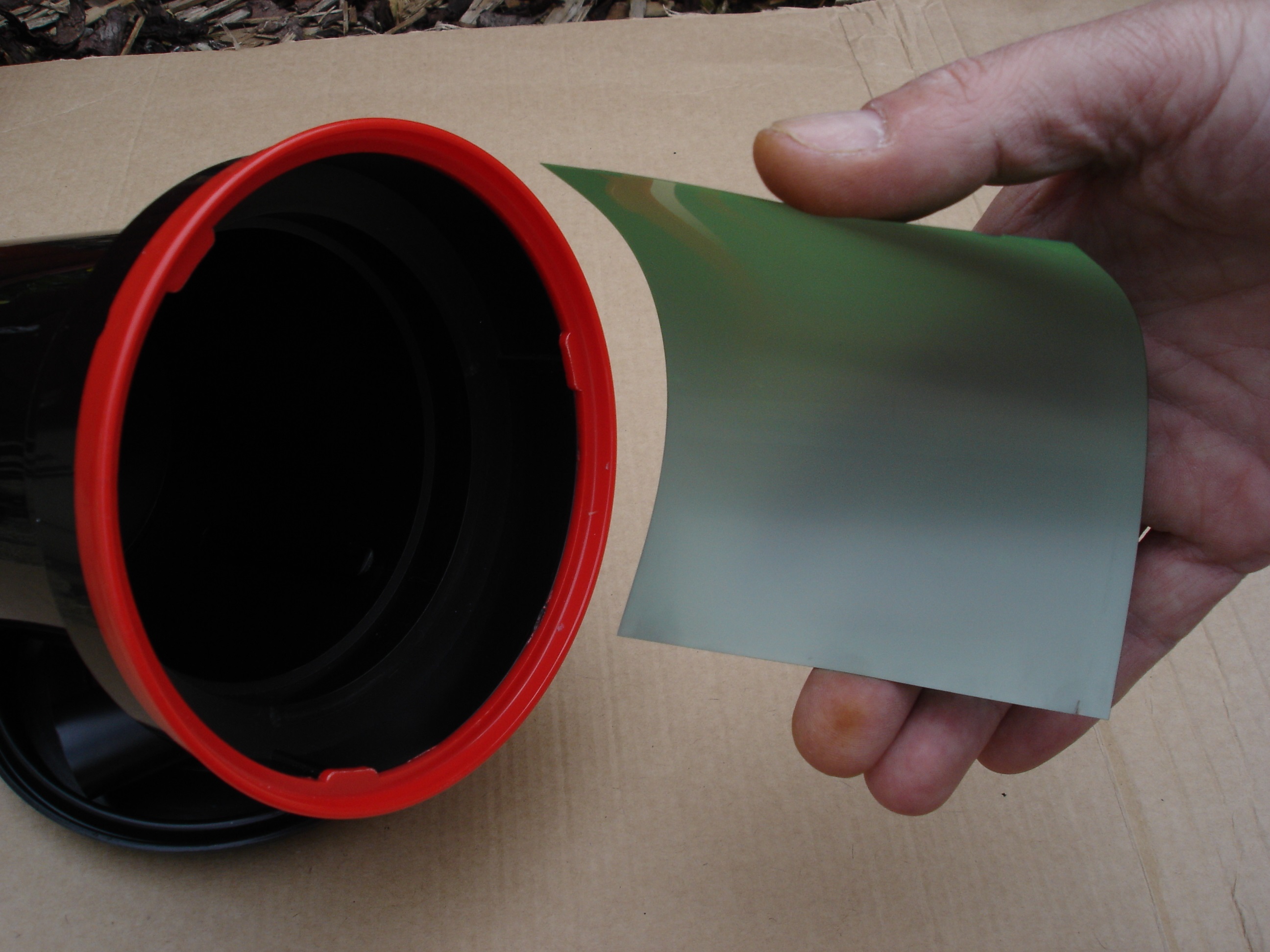

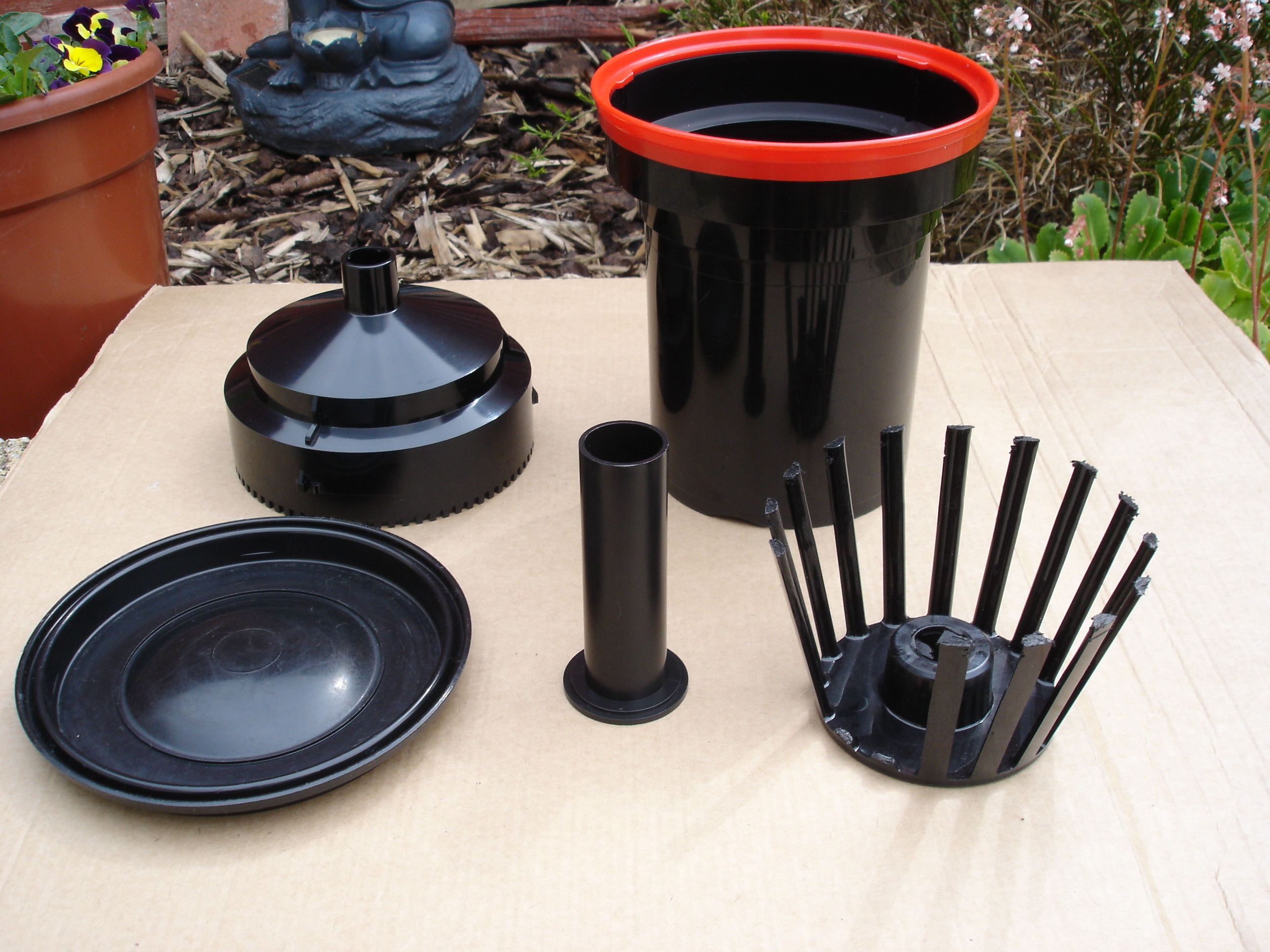

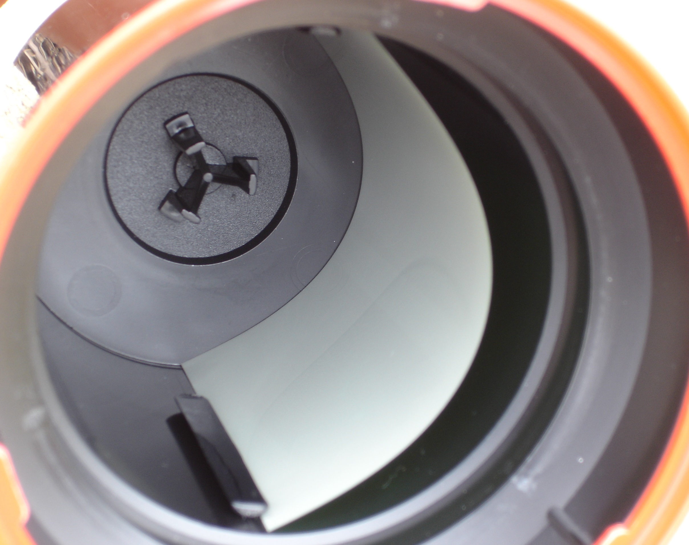

Hi Klaus,
This is my budget solution.
I adapted a Paterson tank by setting two small plastic rails taken from a 'flow-guard' plastic contraption that fits on the end of drainpipes.
The rails have a smooth surface to them and I fine-sandpapered the ends, they are flat on one side and bevelled on the other. I carefully epoxied them to the inside of the tank.
I can develop one or two negatives with varying degrees of agitation; without slippage.
This method is easy and has returned excellent results.
Two issues that may be considered minus points; I have to use 800ml of solution (but this is retained after development and used again - so no big deal).
Also, when cleaning the tank I have to be careful that the water I use is not too warm; or it can loosen the epoxy. Although this is easily repairedr...I would just re-attach the rail. It hasn't happened yet so, again...no big deal.

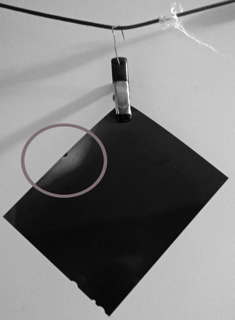

Well, taken my first ever pinhole image (using the Noon box), my first ever 5x4 negatives, developed in the Yankee tank with reduced liquid capacity.
Actually took two images but with the first the dark slide somehow fouled up the film which ended up outside the DDS so another practice negative. See the photo of the tank film holder with a block of foam secured with a cable tie. Still looking for a larger size piece, this only reduced volume to 1 litre. Quite difficult to develop with all the liquids sloshing about. I seem to have a case of uneven development, see picture - this was a practice negative without an image, but I have a similar mark on the one with the image. need to find a way to scan the image, will probably try to use the DSLR and lighttable (it's still drying) .

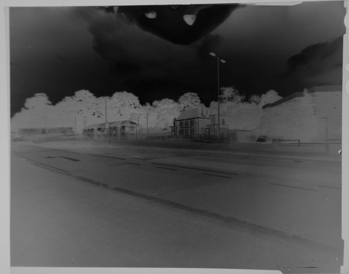

Will bear it in mind - I am just aiming at pinhole images but still if this is a regular feature then sure I will consider the options. Attached is a "scan" of the original negative and the final image. I just used my DSLR to get the scan off the lighttablet, freehand as I don't have a copy stand.

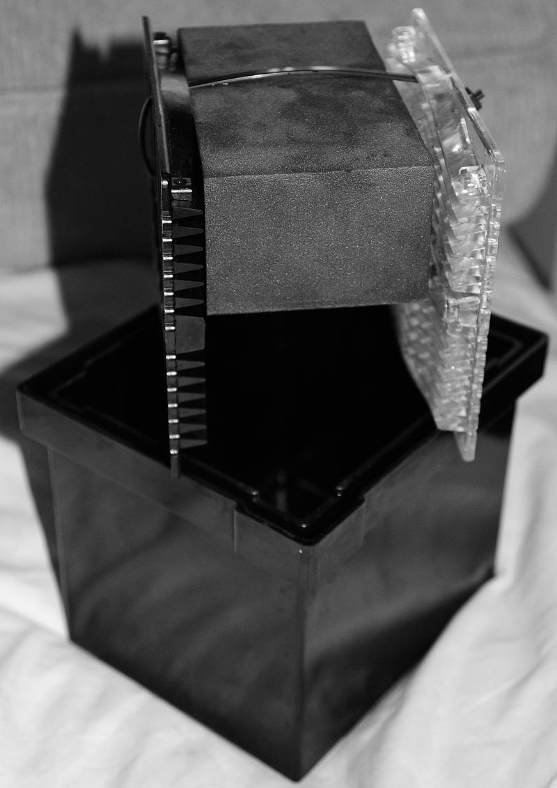

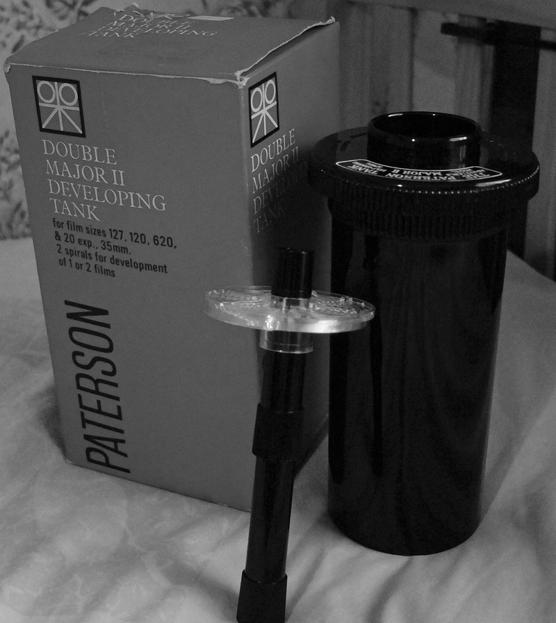

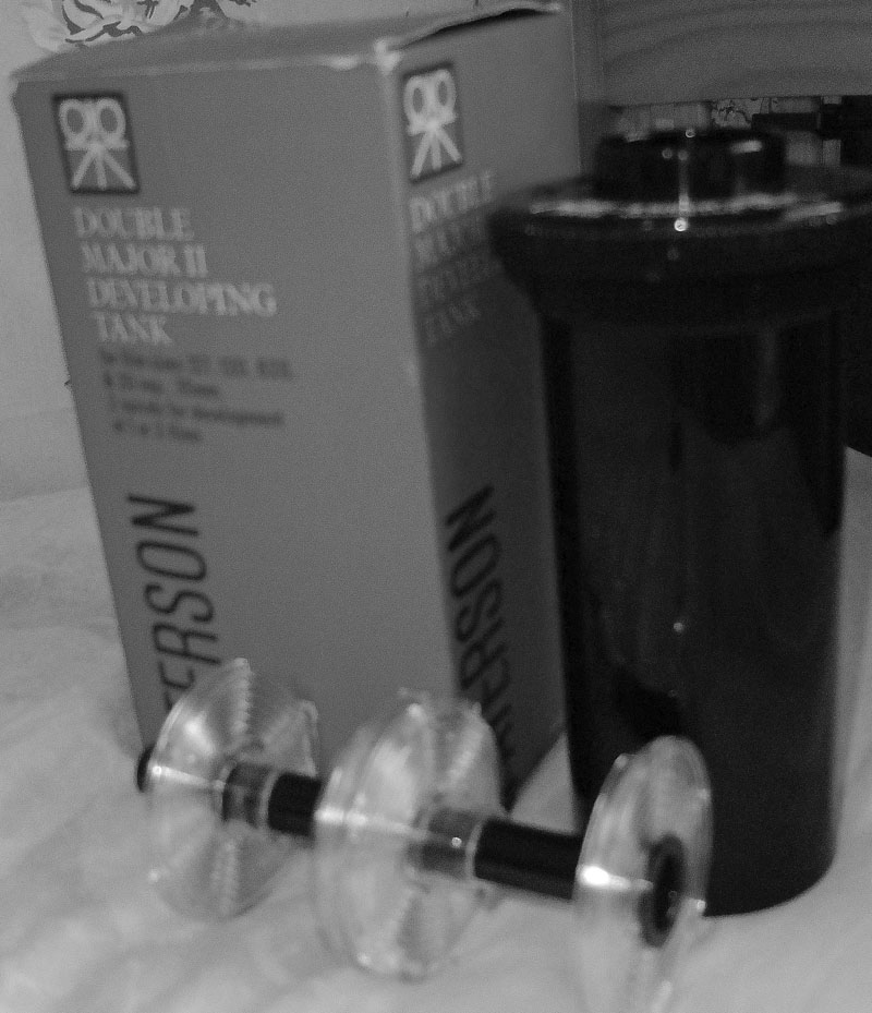

By chance I came across one of my less useful purchases, up til now. A Paterson Double Major II dev tank (image 1). Dates back to the 60s or early 70s - the price was written on in Pounds/Shilling/Pence! It's ok for developing two 120 roll films but will only do short 35mm films, i.e. 20 exposures. But with the pieces in the box I constructed a sort of of holder which keeps the 4x5 sheet in place and will allow me to process up to three sheets "taco hairband style" with just 600ml of developer (image 2).
Only thing missing is the top cap - I can probably find a rubber bung about 5cm diameter to keep the liquid contained during agitation. Don't remember how much I paid for it, never used it, but worth a try.

I am persevering: now got a stopper so I can develop without splashes. A pipe plug from Screwfix (UK hardware merchant) costing £1.09 plus some insulation tape to pack the end of the plug to fit tightly into the tank opening. Just now waiting for cooler weather to go out with the box .. it's too hot ....

I think I am on the way, with the tank shown above, very easy to work with, no splashing . Couple of pinholes done over the weekend, using Noon with FP4+ at ISO125 for 40 seconds, in Ilfosol3 for 8 minutes. Bit of scratching and other damage to emulsion which is down to my rough handling rather than anything else. Planning to do "scanning" with DSLR, have a copy stand coming in a few weeks so the picture is just freehand from the light table, not processed so far. Bit overexposed.
