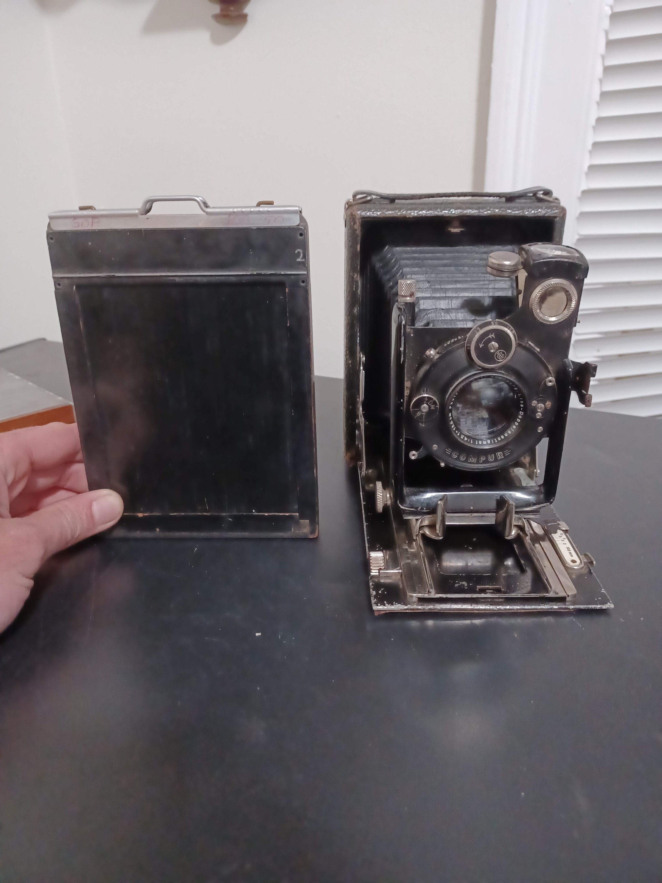

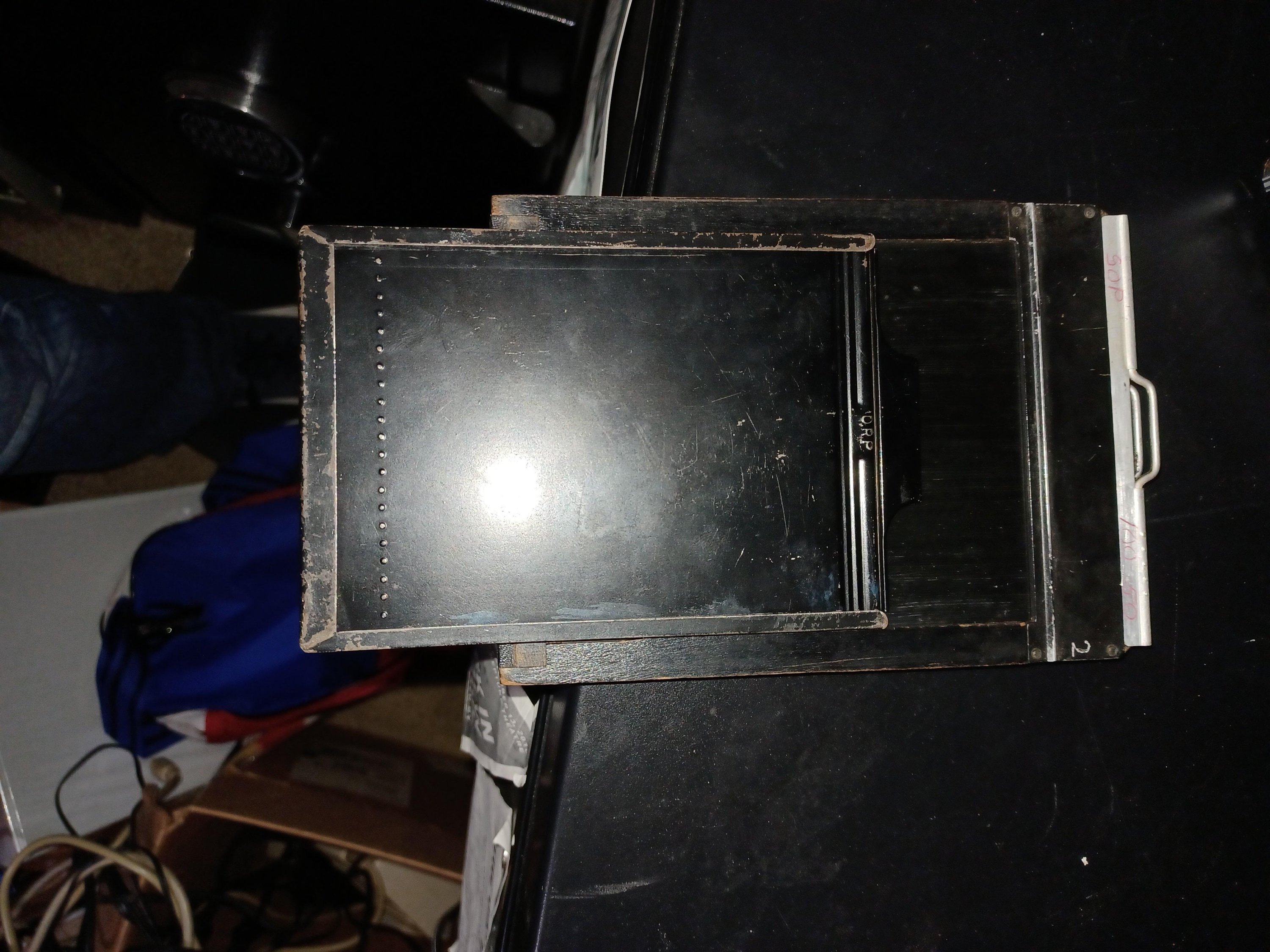

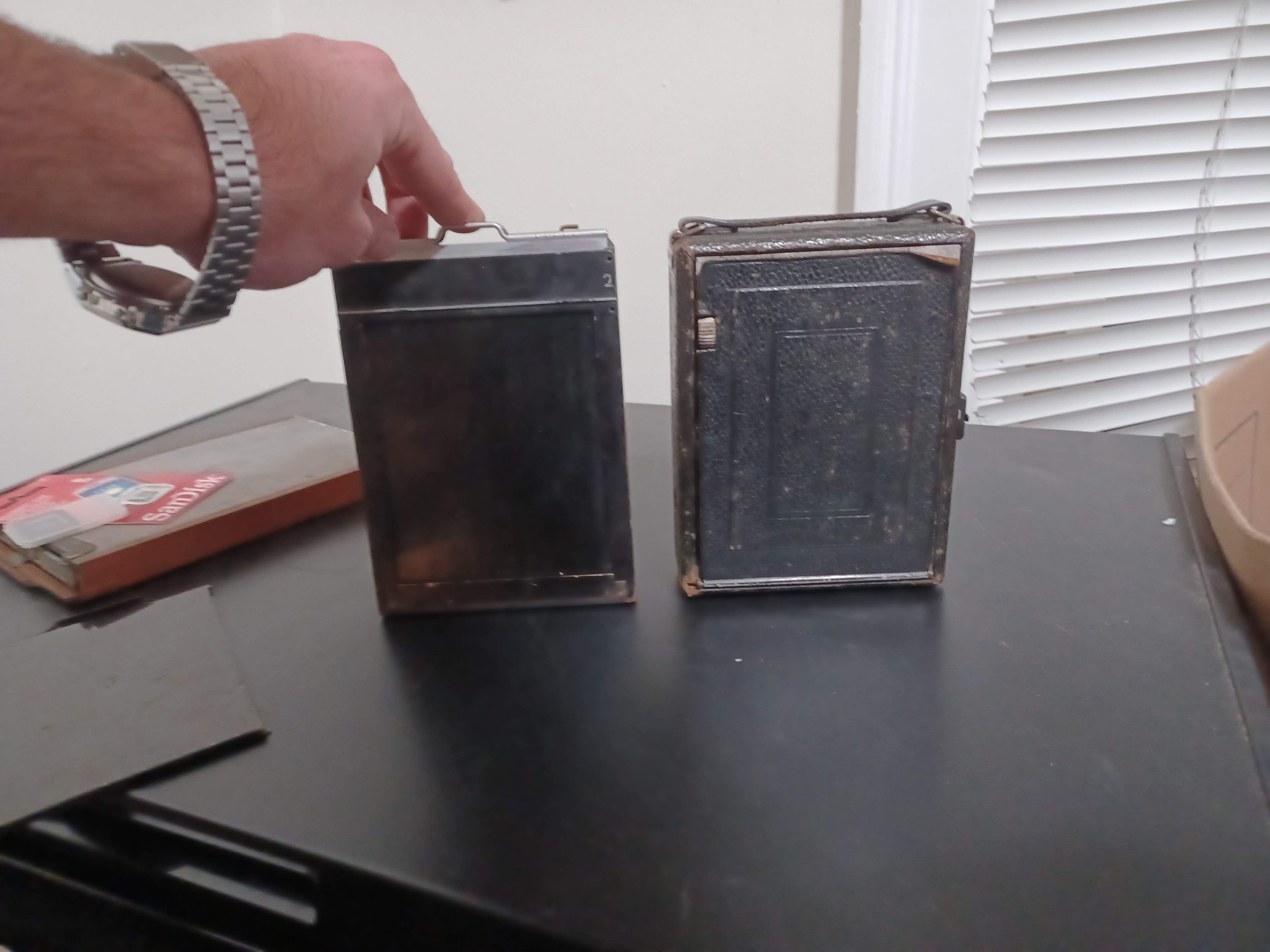

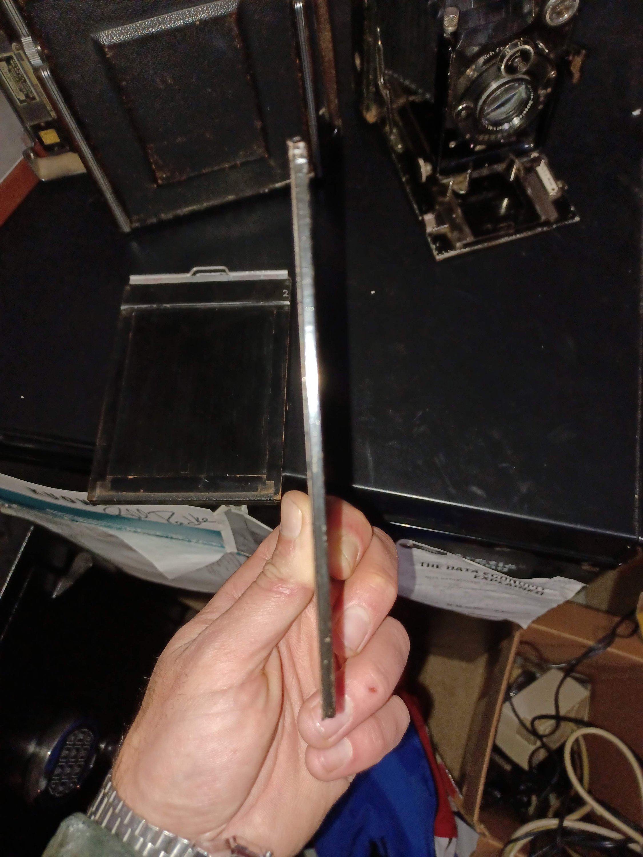

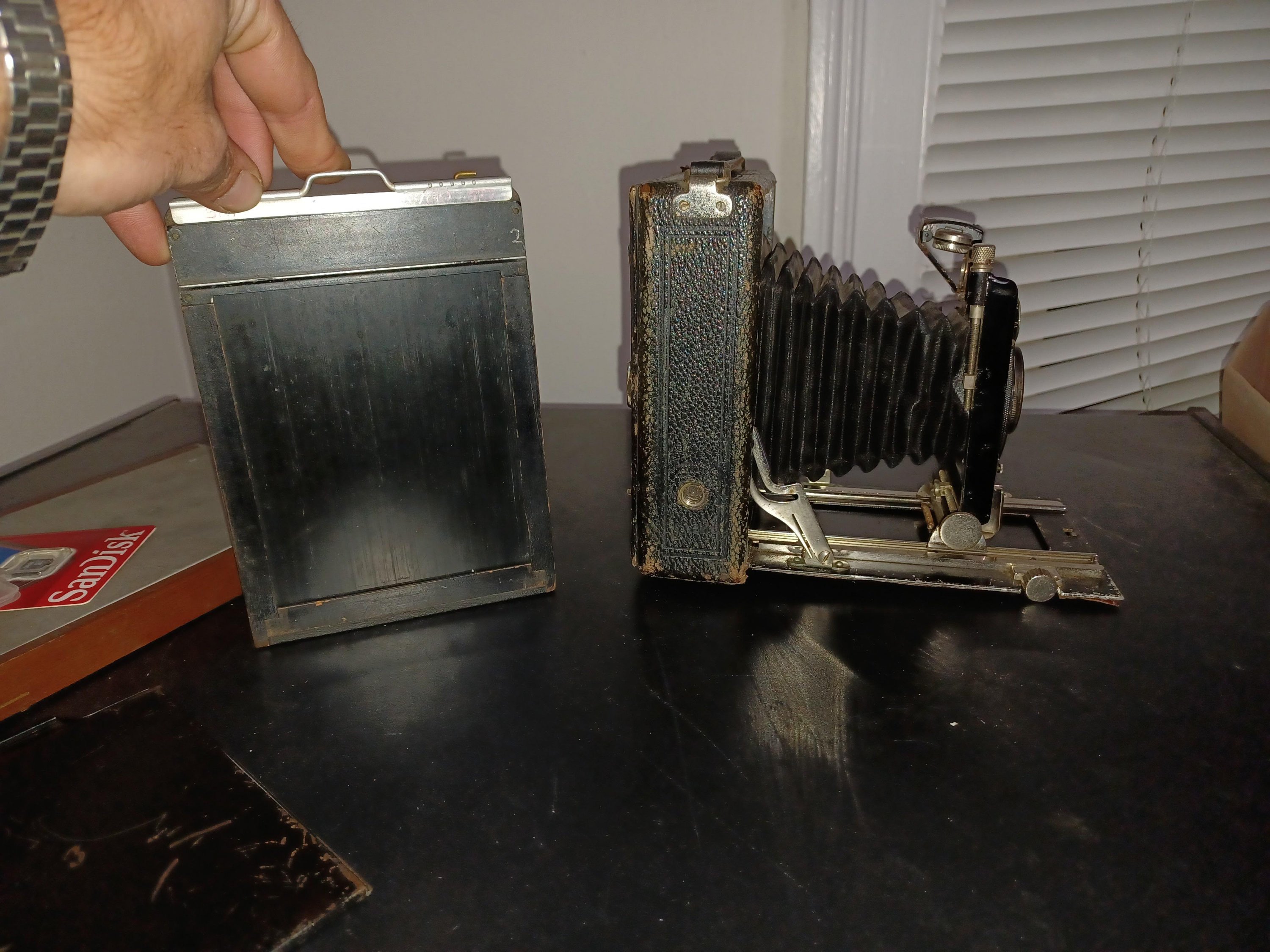

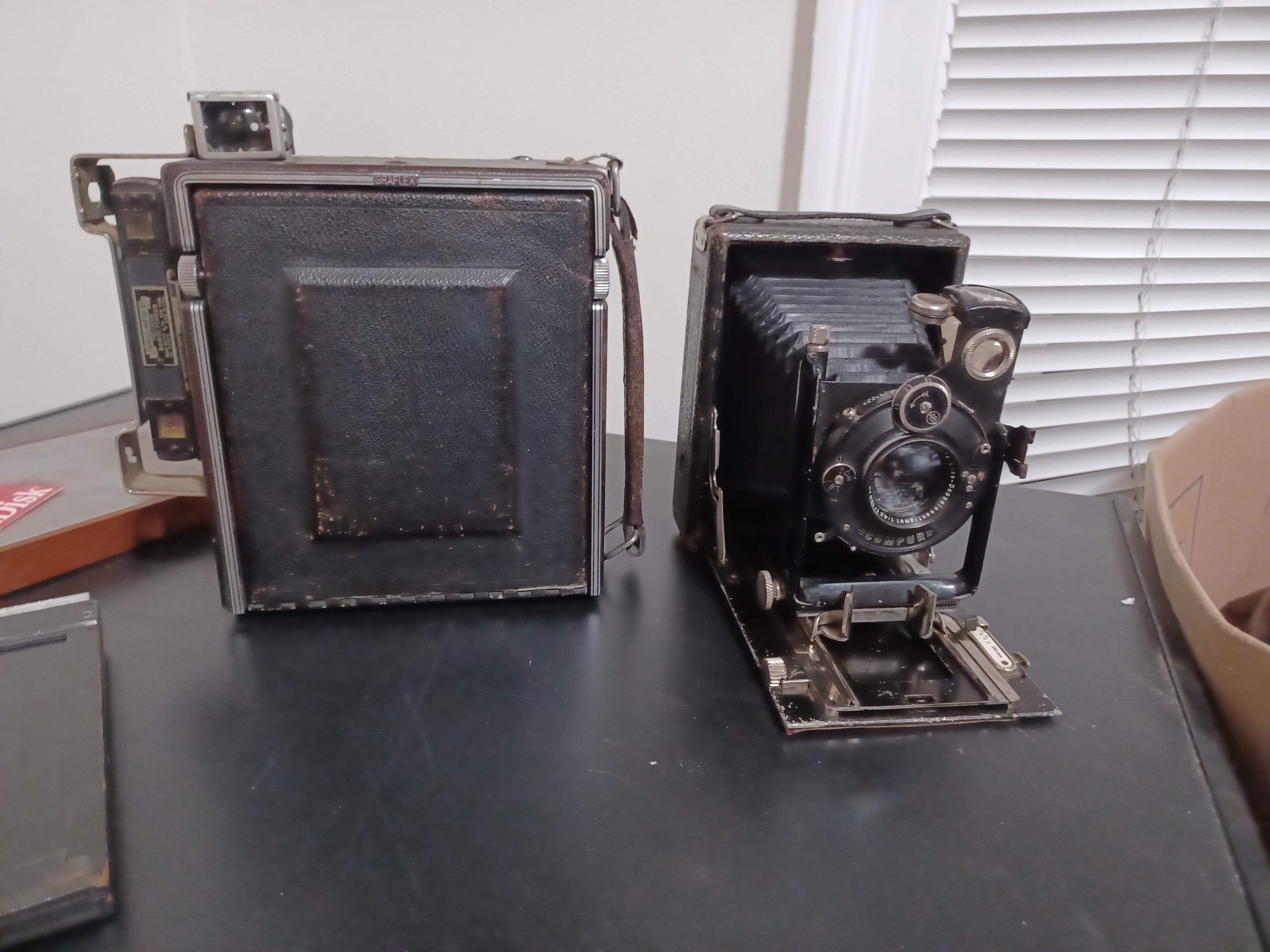

A photo of your 9x12 (with some object for size) would help understanding what size/form factor we are talking about.
Here are some pics of camera with standard Graflex 4x5 film holder for scale, and one next to a Speedview.
IMG_20211202_030041.jpg IMG_20211202_030032.jpg IMG_20211202_025959.jpg IMG_20211202_025933.jpg IMG_20211202_025816.jpg IMG_20211202_025729.jpg
Its a great little camera that is easy to throw in a bag and take with me, as opposed to the Graflex, which is a bit of a beast to just carry around.

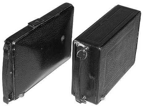

See if you can find a good set of photos of a KW Patent Etui -- widely called the smallest large format camera ever made. I owned one for a while; it was about half the overall volume of that square box plate camera, but still took a 9x12 plate or film (with film sheath). I could carry the camera in a suit jacket pocket and three plate holders in the other pocket.
There will never be a 4x5 camera that small, because as illustrated in a previous post, the Patent Etui, when folded, was actually about the same size (barely thicker) than a 4x5 film holder.
That's alarge 9x12 camera compared to some others.
A KW Patent Etui 9x12 alongside a PacemakerCrown Graphic.
The same Patent Etui closed alongside a Rodenstock 9x12.
