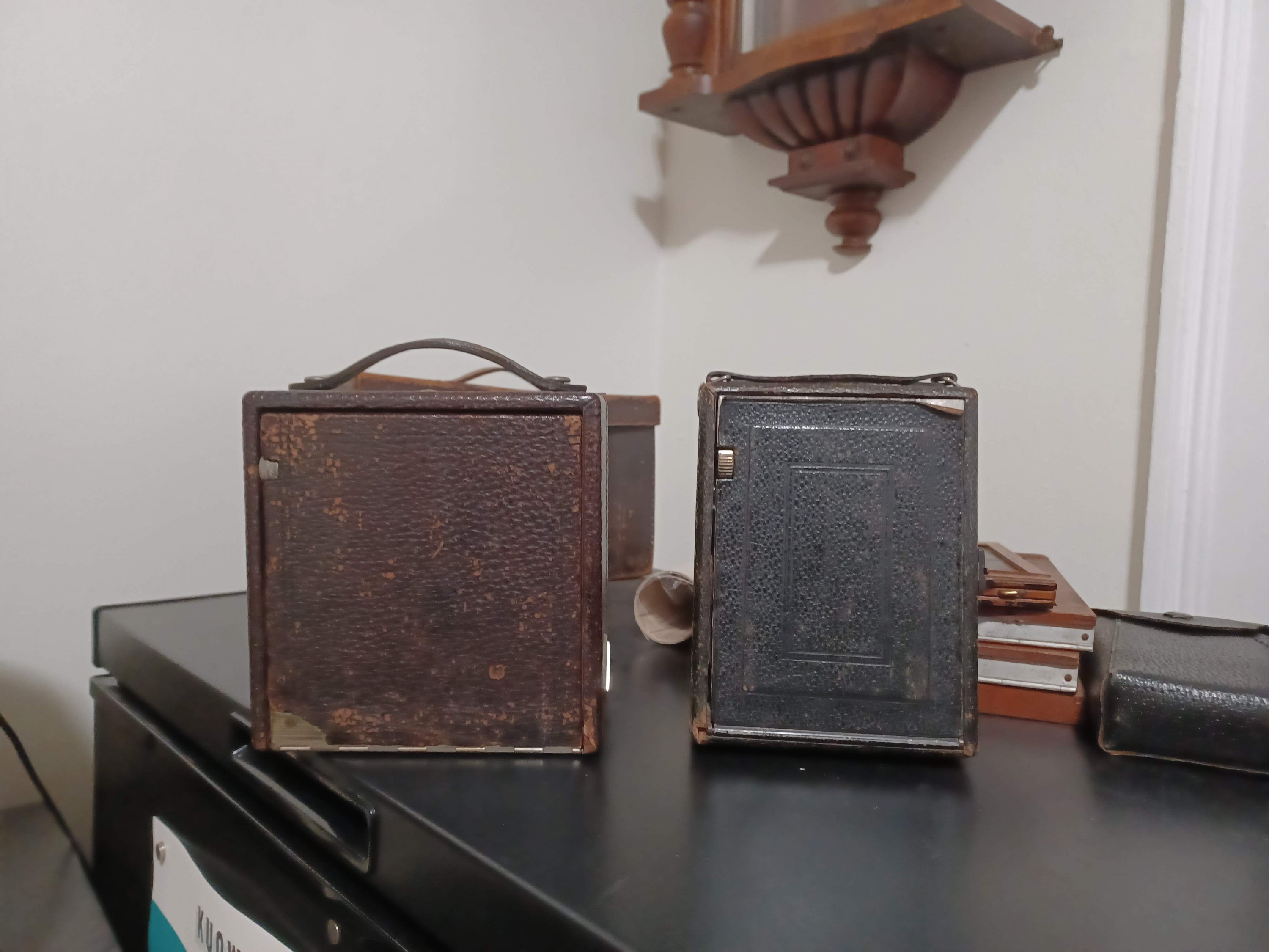

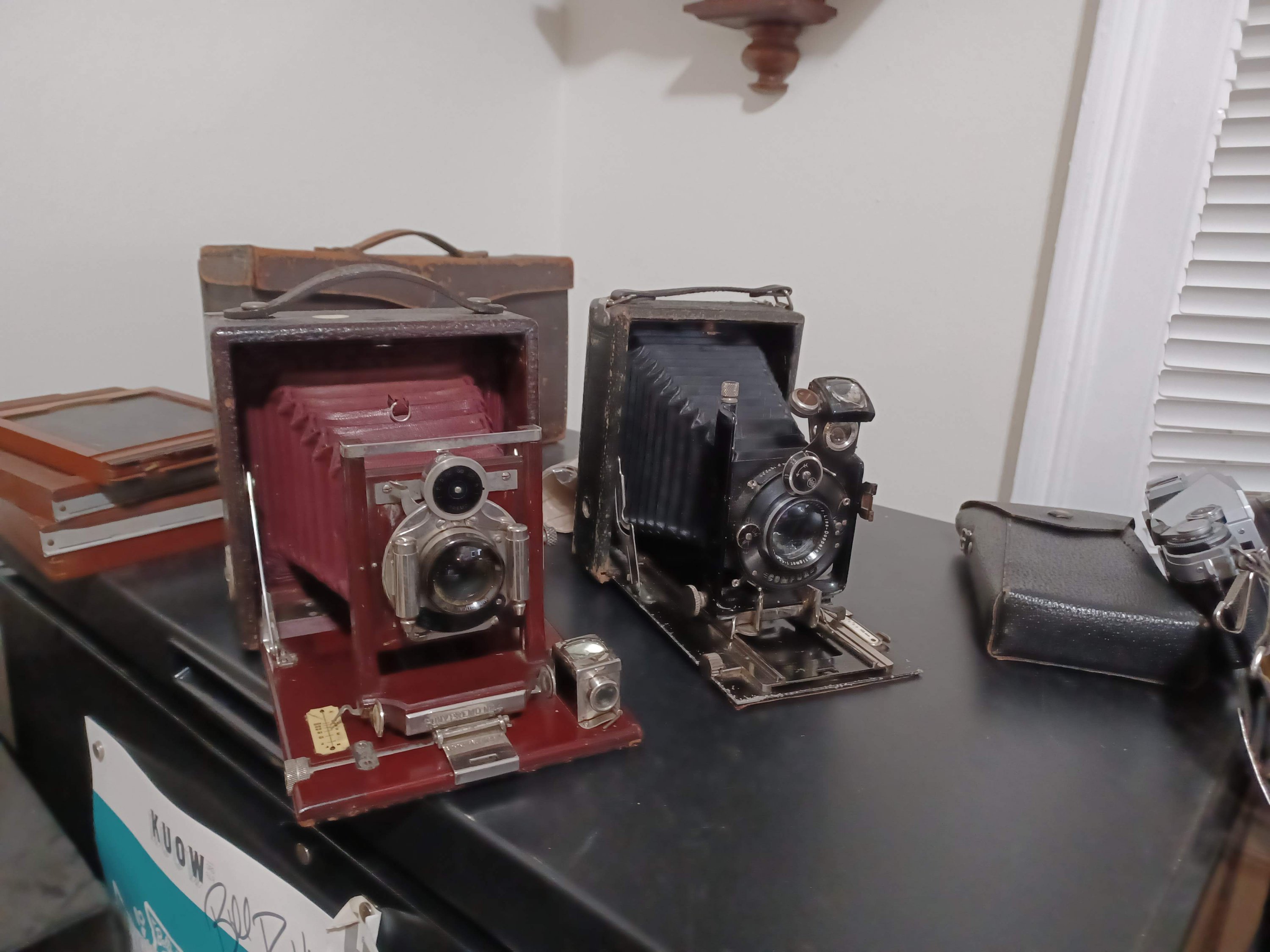

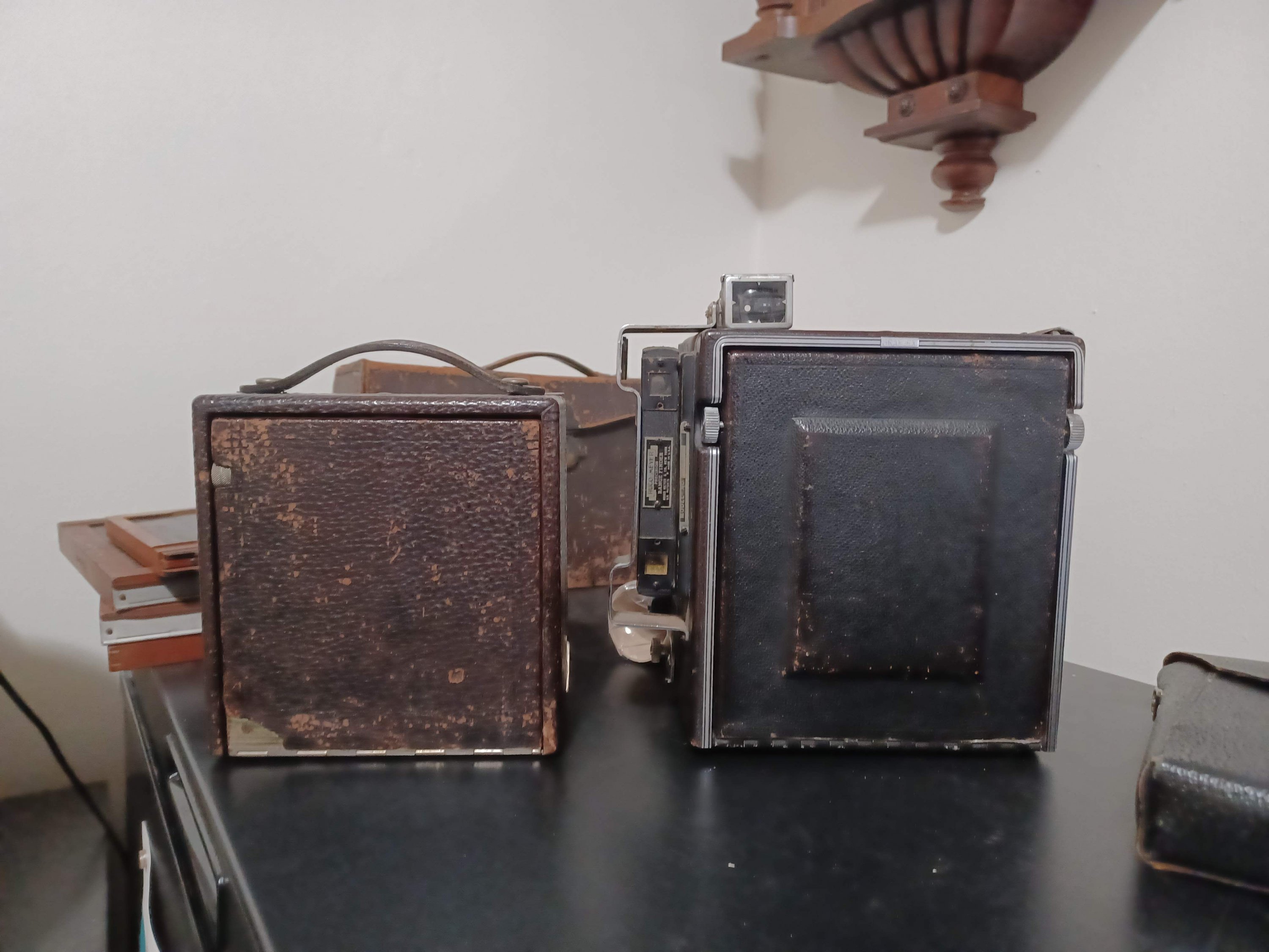

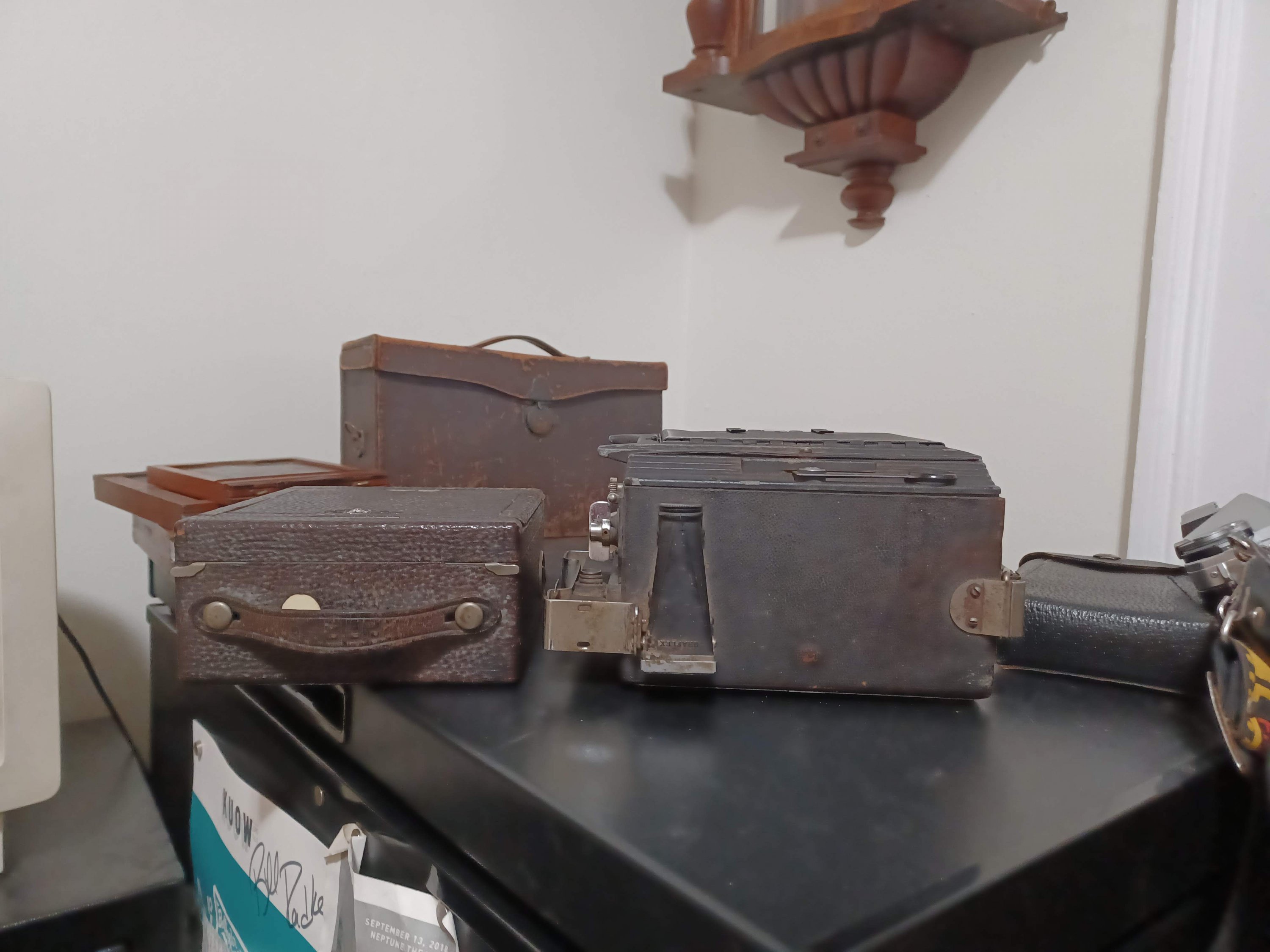

I love my 9x12, its mostly film availability that pushes me towards 4x5. I have enough cameras I have to re-roll or cut film for already. I ended up getting a Kodak Premo which is much more compact and light. It does not have the universal back, but I have the Speed Graphic for when I need that.
IMG_20211210_164130.jpg IMG_20211210_164116.jpg IMG_20211210_163854.jpg IMG_20211210_163752.jpg
