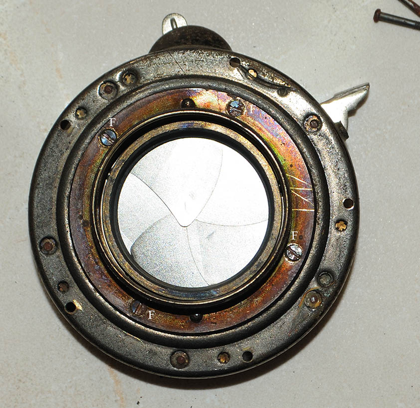

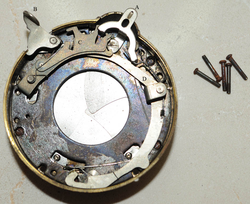

If you are good with small tools then a Kodak Ball Bearing shutter is not difficult to service.
A speed selector; B trip lever; C bulb & time levers; D main operating lever; E blade controller lug; F mount ring / main plate retainer.
Pressing B operates C and D so that D engages E and pulls the blades open then releases them by travel operation of D and spring tension.
Front cover retaining screws are on the outer edge of the shutter. All internal springs and levers have to be removed before removing screws F. There are 5 - 1/16 (.0625 inch) diameter ball bearings and 5 arced spacers under the rear mount ring plate along the collar of the shutter case.
Flush with a good solvent, coat the bearings and spacers with light weight grease (trace), the recess they sit in, and a pin point drop of oil on the lever pivots.
View attachment 201709 View attachment 201710 View attachment 201711 View attachment 201712
