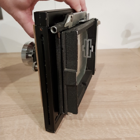

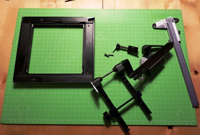

So first I dismantled the parts from the standard that I don´t need for my project.

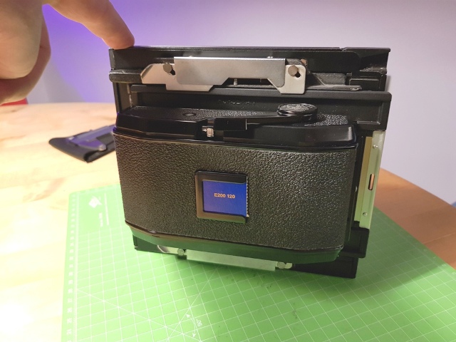

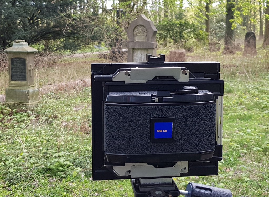

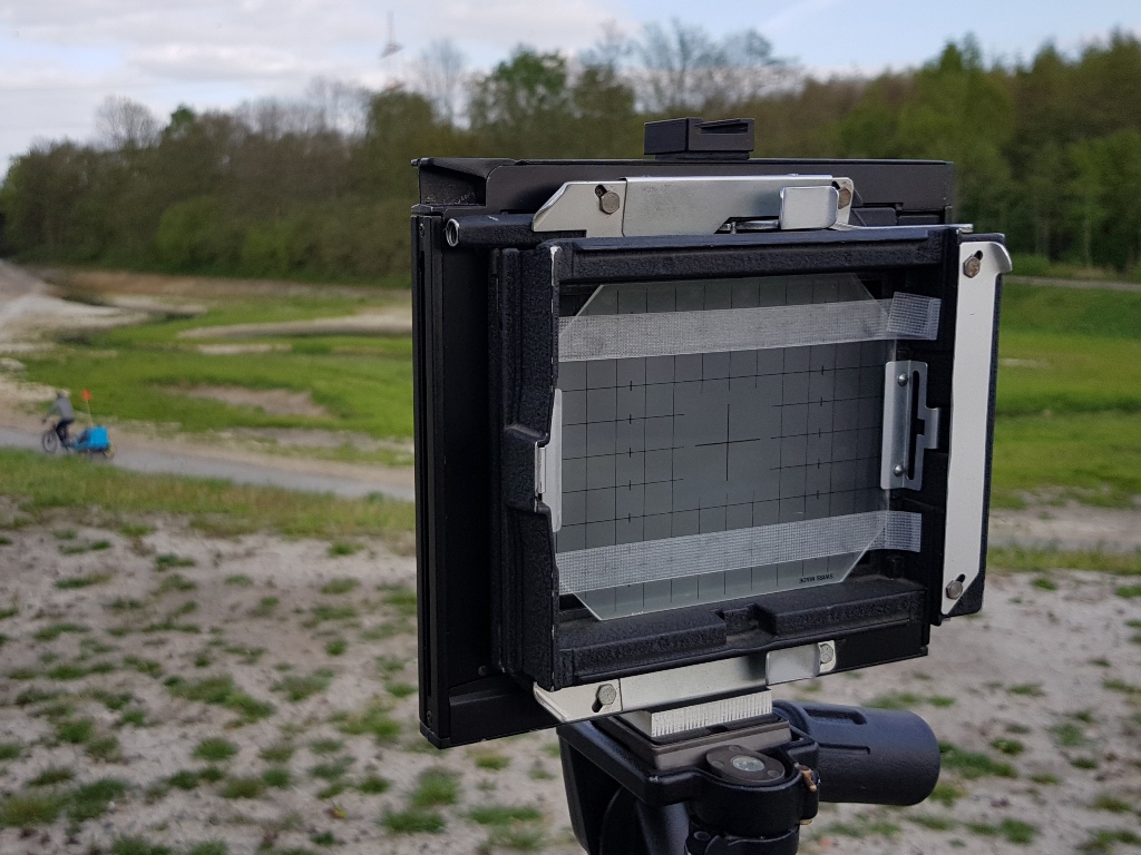

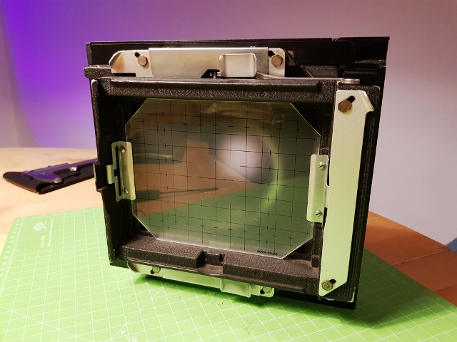

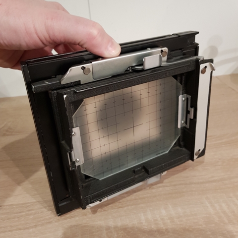

The F back and my 612 film holder fit on the standard, so the rear end is done before the work starts... .

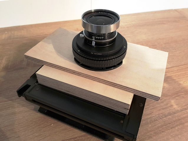

Work is at the front end. Luckily the lens board can be mounted every 90 degrees in the standard which means that I only need lens movement in one direction. If I need the movement in another direction I simply turn and remount the lens board accordingly.

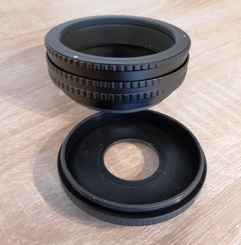

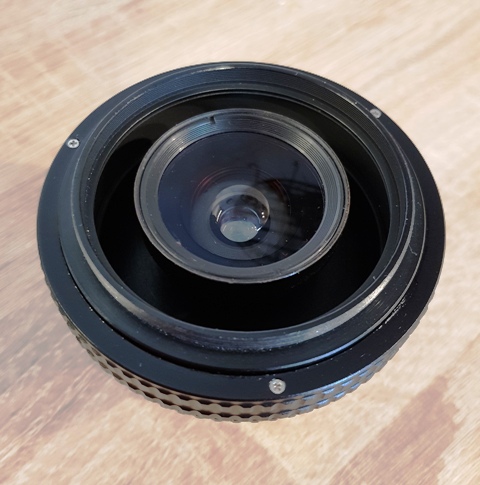

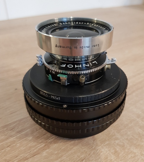

Due to the lack of bellows with only one standard the lens is focused by a M65 focusing helicoid. The minimum length of the focusing helicoid is about 18mm, fully expanded app. 31mm. The inner diameter is 61mm, the Schneider fits nicely into it. A M65 lens flange and body flange, some pieces of multiplex board and I was ready to start.

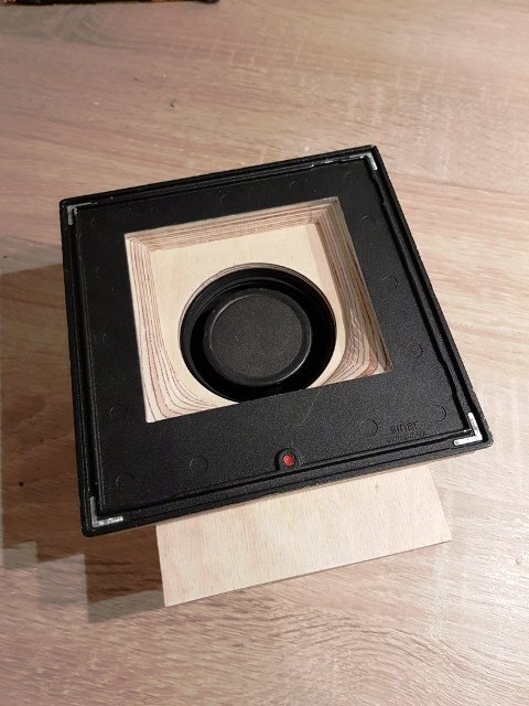

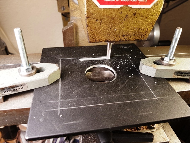

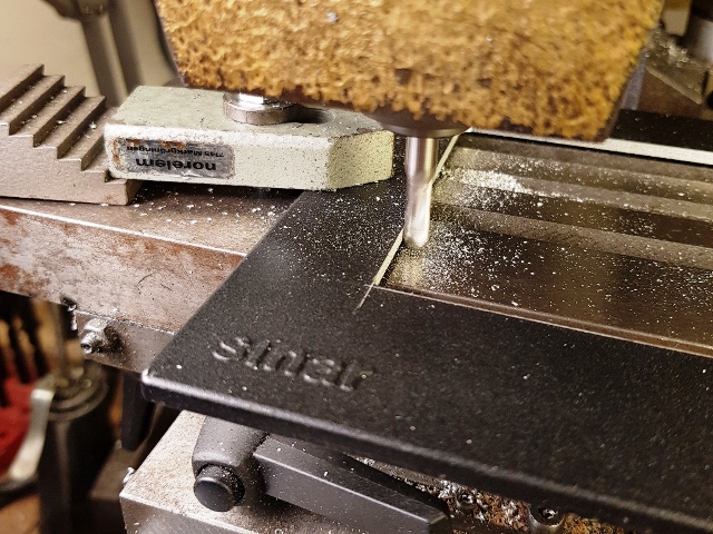

Machining the Sinar lens board

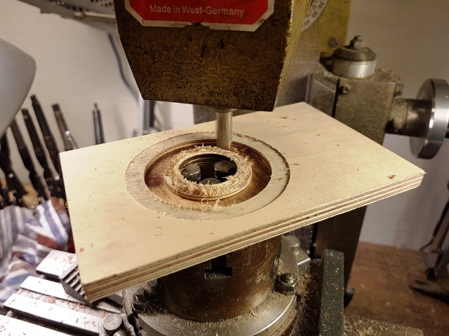

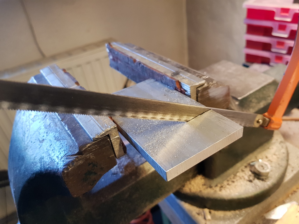

With the Sinar lens board and the back mounted in one Standard the distance between focusing plane and the front of the lens board is app. 21mm. So I made a sketch to find the app. dimensions of the hole in the lens board for the 65/8 on 4x5 (app. 90mmx72mm). I added extra 10mm in the direction of the lens movement for 612 use. Time to start the milling machine...

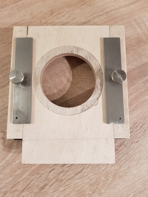

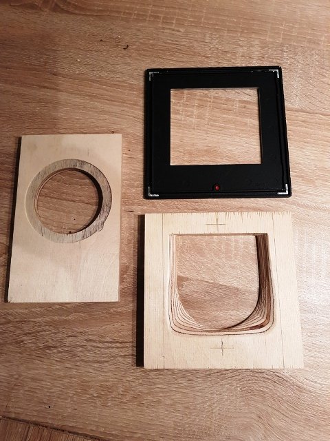

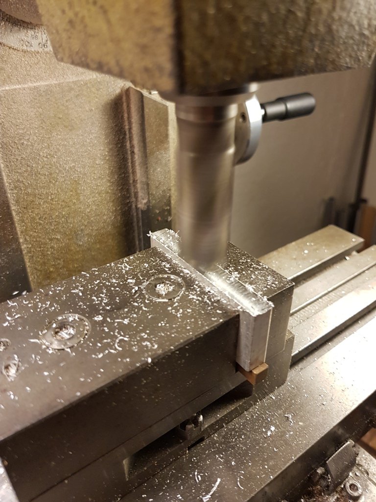

Machining the lens board slider and spacer board

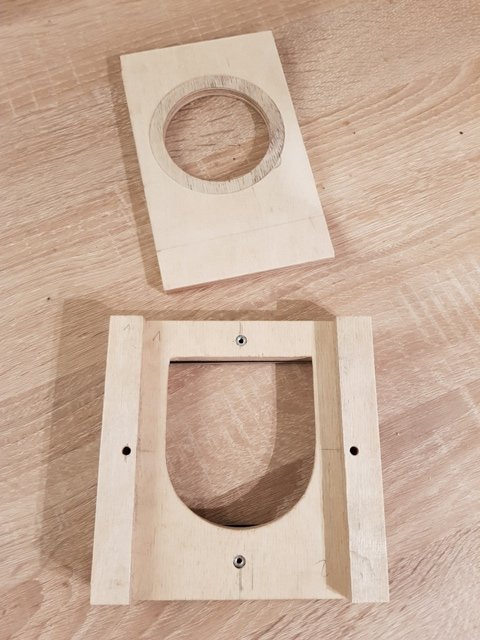

The lens board slider is made of 9mm thick multiplex board, cut to 100mmx160mm. I milled a small recess to center the body flange to the 65mm center hole, which I machined at the same time.
The spacer board (between Sinar lens board and lens board slider) is made of 12mm thick multiplex board, cut to 135mm square.

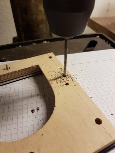

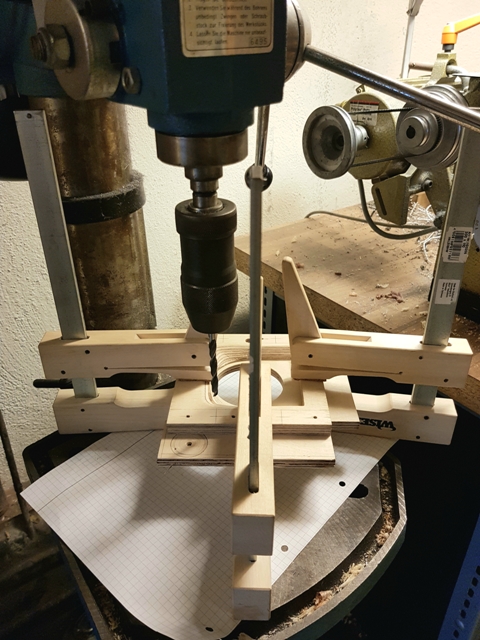

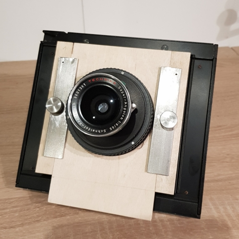

Back in my cave - today I made some progress.

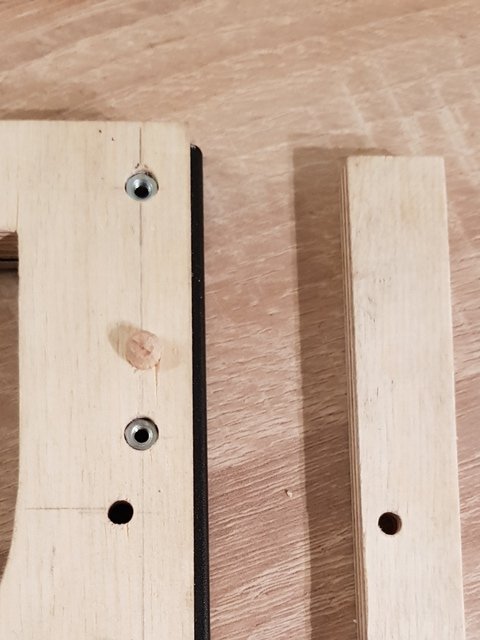

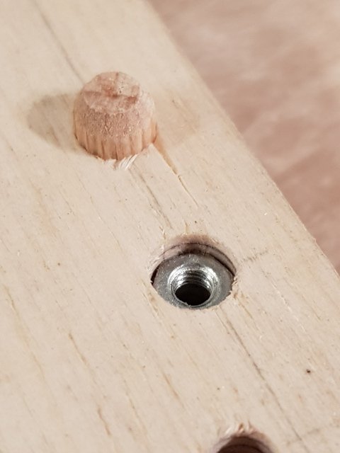

The Sinar lens board and sparer board are clamped together, drilled and connected with M3 screws. The Nuts are pressed in the recess and secured with Stabilit Express (they will be unaccessible after mounting the sliding rails).
Slider rail are held in position with wooden pegs.

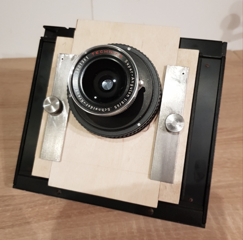

Locking of the slider will be done with pieces of flat bar 20x3, 100mm long & thumb screws M4, both stainless steel. I need end stops for the slider, I think... .
Next will be smoothing edges, staining, painting, polishing metal and all the small bits and things (handle, tripod thread, coldshoe, strap lugs).

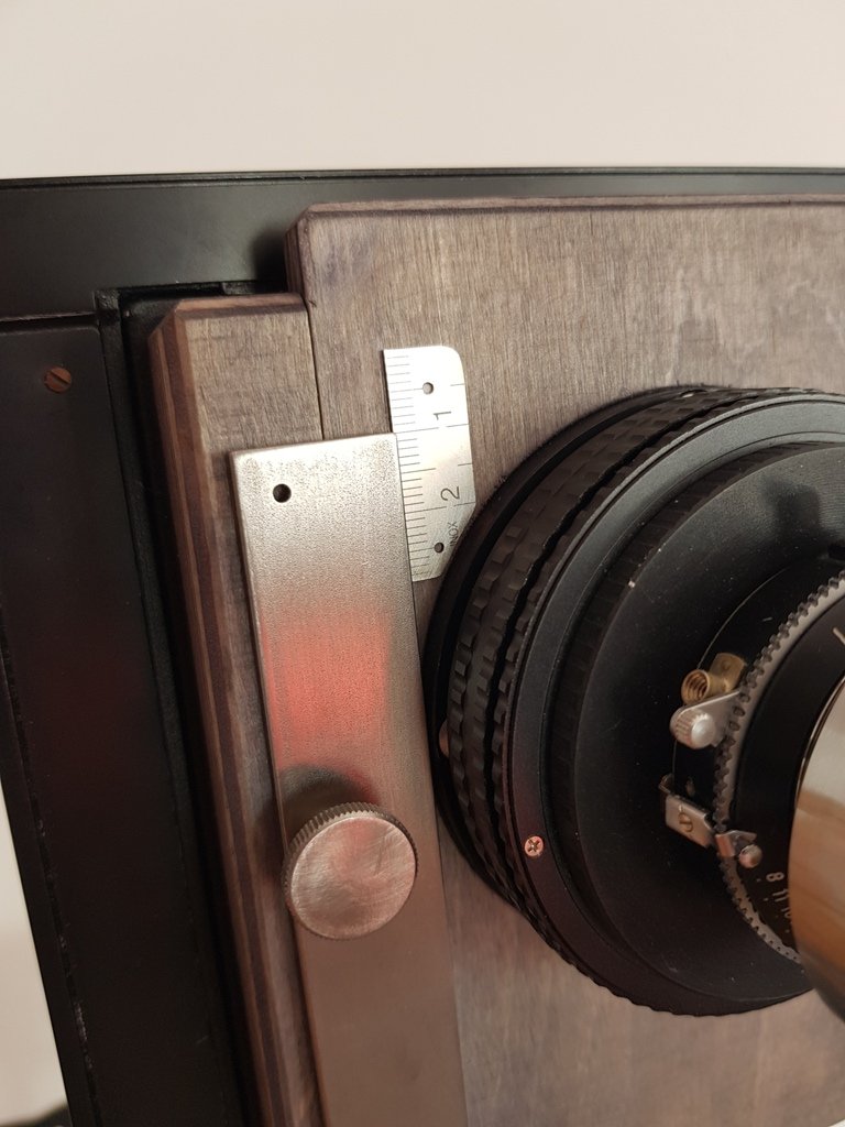

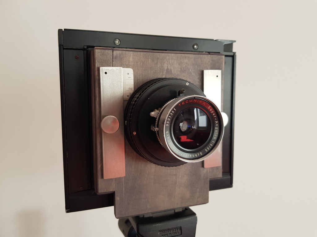

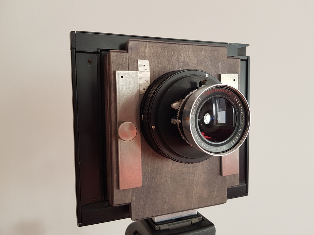

Work is slowly in progress - a tripod mount milled from a block of aluminium, stain and paintwork, small scale for the lens movement (needs to be fixed with pins), Handle, bulls eye level and coldshoe mount are next on my list.

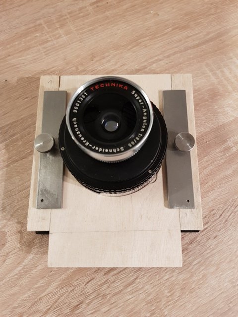

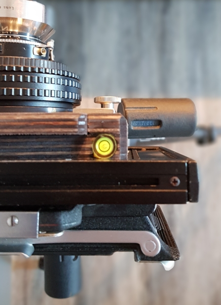

Today the bull’s eye level arrived. I leveled the standard first and mounted the level in a slightly oversized hole filled partially with epoxy. So I was able to level the level on the leveled standard... or so...

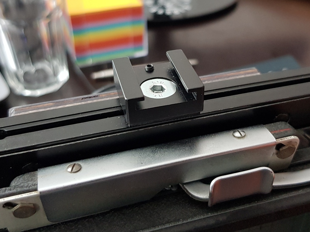

The cold shoe mount arrived today. incredible how the supply of bits´n things works even these days.

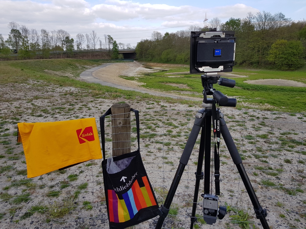

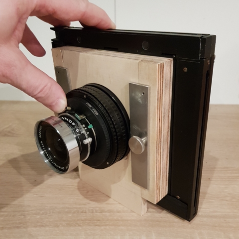

Yesterday I made some test shots. At the moment I can just focus to infinity, but I would feel more comfortable if I could adjust focus a little bit over infinity. Maybe I´ll do a bit of machining of the lens flange later this day.

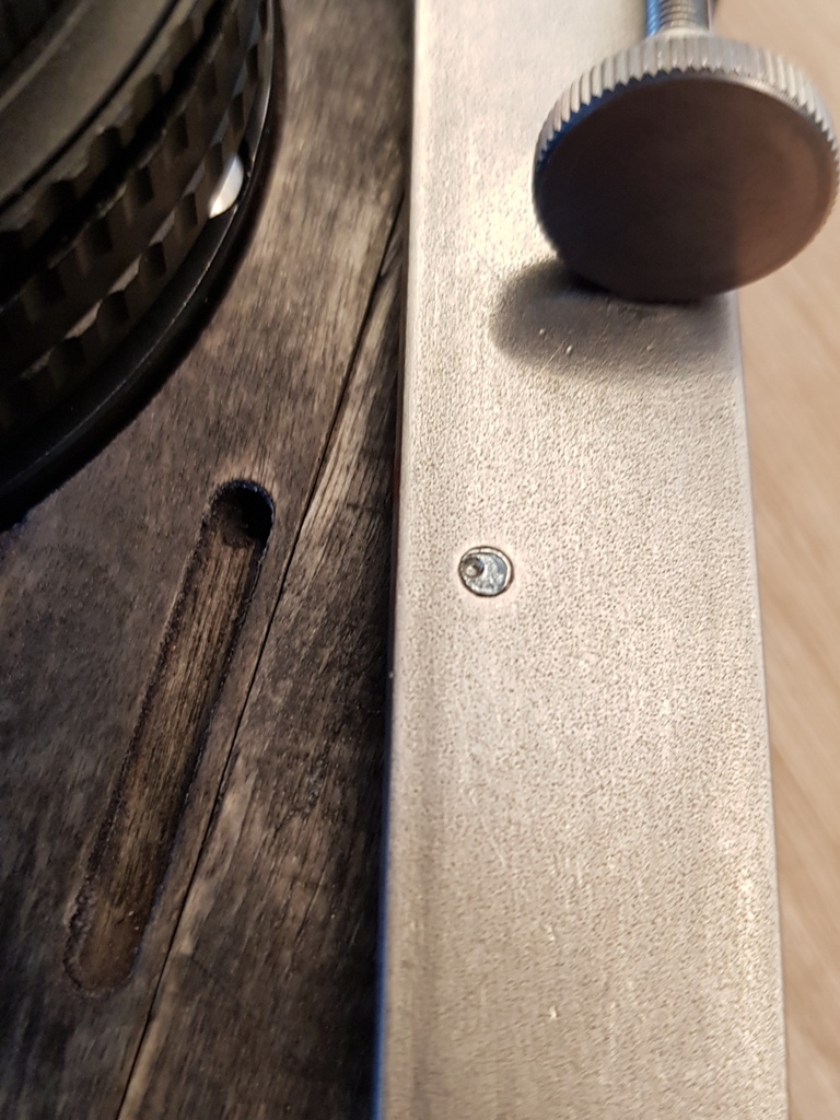

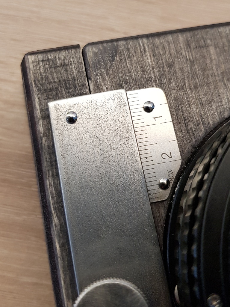

Yes, the extra 1mm focusing travel in the direction of infinity makes all the difference. I also worked a bit with the Dremel to drill holes for small nails to fix the scale and prevent the locking bars from turning/falling off. The slot in the slider and the screw stud in the right locking bar prevent the slider from falling off the camera when not locked.
