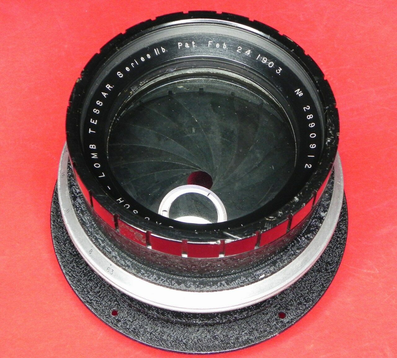

You may also explore the ancient B&L 14x17 Series IIB, which is a 489mm Tessar, reportedly.
