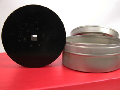

Opaque black bags that will fit in the can are difficult to source. LOL first time I did this I spooled out like 175' or 200' in a 35mm microfilm reel and of course it wouldn't fit in the black bag made for 100' spool without a reel. That went straight into a bulk loader. Second time I didn't use a reel and tried to get close to 100', that fit into a used bag and can nicely. You can fit 2 spooled rolls back in the original 400' bag/can and tape it back up.
Thanks. I was wondering how many reels I could fit back into the 400ft can. I found some black/aluminum food storage bags that are moisture proof and "blackout" (though explicitly not film safe). I figured those in conjunction with the metal candle cans should be enough.

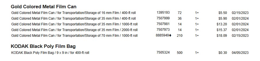

I used to laugh at the prices some antique malls placed on 100 foot metal cans, but now they are becoming competitive!
If you have any size film cans, don't toss them. Kodak is not shipping lab stocks in metal cans anymore, but they will sell you a can.
However, be sure to note the minimum order quantity, which is the 3rd column...

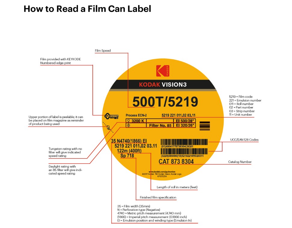

My last roll of 5222 was made in 2022, and has an emuslion number of 512, so your 524 is fresher than that. (betcha that Kodak had to make a couple of batches to keep their #1 customer Christopher Nolan happy loading 65mm 5222 in an IMAX camera.)
as soon as you develop the first roll, the year of manufacture is now "open" {Kodak has dropped using funny codes to encrypt the manufacture date} and will be the last field on the line that starts with "Eastman". that line should repeat every 18 inches.
