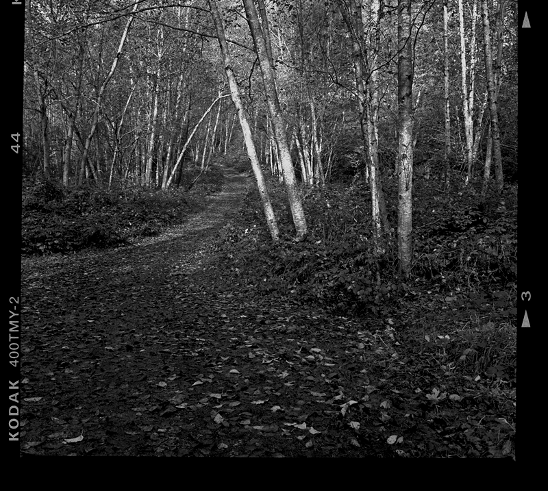

Here is reasonably faithful illustration of a strip of negatives. I created this by scanning the negatives as a positive and then adjusting the result to look like how the strip appears to the naked eye.
Negatives 1 and 2 were exposed in diffused light, they print well, and are of a good density and contrast for both optical printing and scanning.
Negative 3 was exposed in more direct and contrasty light. It too prints well, and is of a good density and contrast for both optical printing and scanning.
Here is the result obtained from further inverting and then re-sizing negative 3.
All the inverting and, in particular, the resizing to Photrio's requirements of the latter image makes it look much less detailed and sharp than it appears in full size.
I post this to provide a visual reference, not to show the images themselves.
