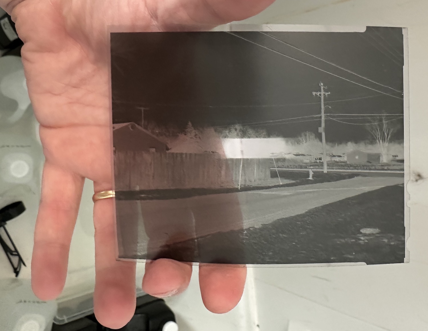

I first developed one of the properly exposed sheets and one of the fogged sheets in Dilution B @20ÂşC for 9 minutes(massive dev chart time) with my relatively fresh D76(16mL to a total volume of 500mL for my SP445 tank). Without scanning or doing a ton of analysis, this looks like at least a respectable negative to me, and the fogged one(not shown) showed respectable density. I'll throw it on the densitometer later and see what these actually are.

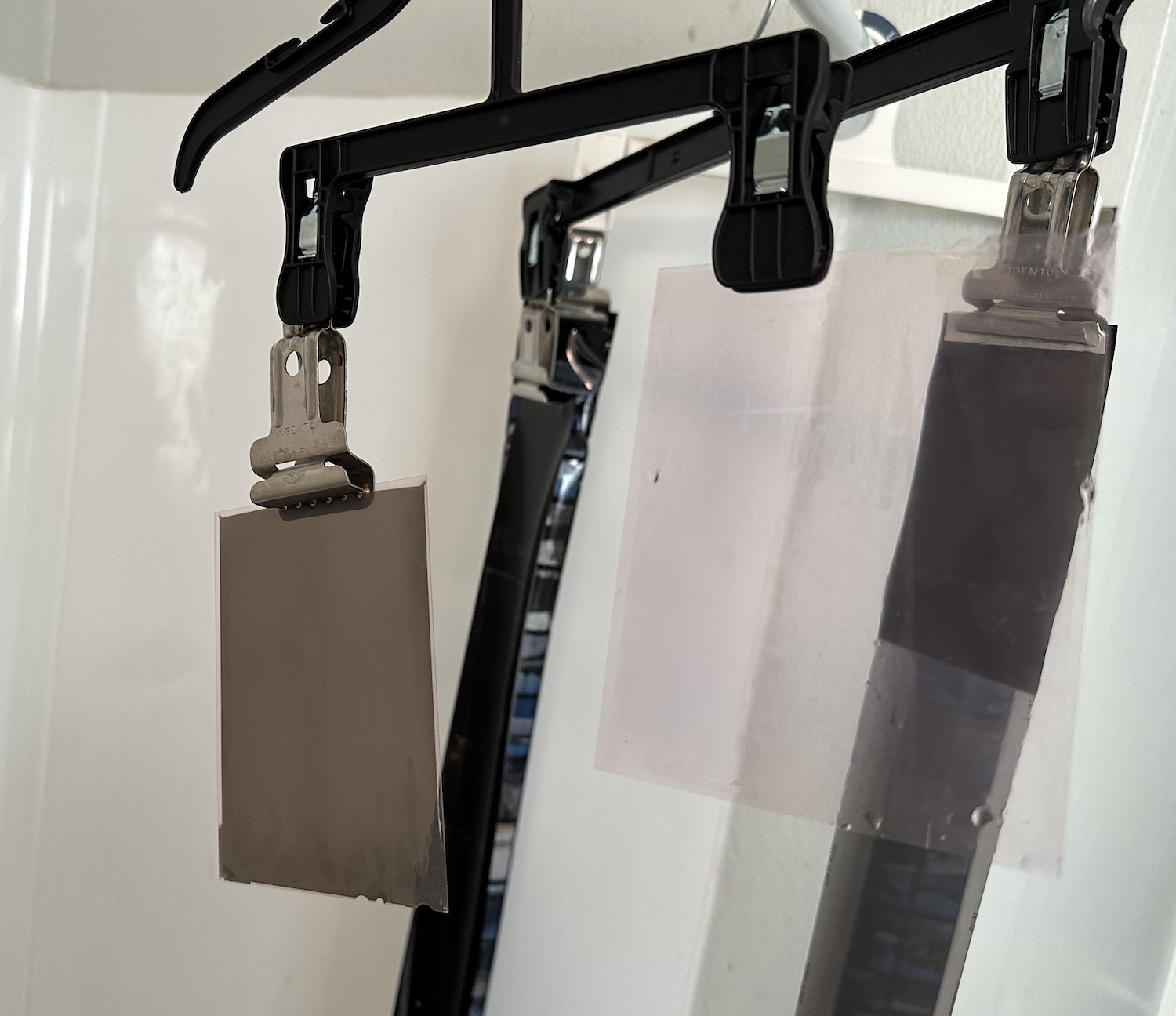

I did the old bottle of HC110 exactly the same way, and this was the result
There's the faintest trace of an image on the right, but nothing usable. The fogged one on the left shows very little density compared to the fogged one in fresh(er) develoepr.
So, I guess it's not COMPLETELY dead, but it's definitely nowhere near as active as you could expect HC110 to be, and as far as I'm concerned not usable.
