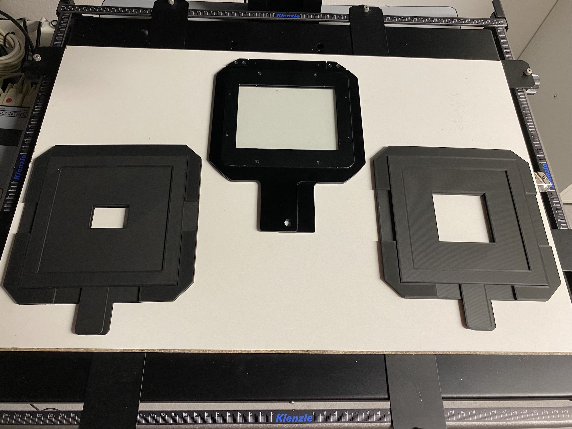

Since about a year I also have a 3d printer in my basement (Creality Ender 5 pro) and decided that I will make my own carrier. I took all measures of the 4x5 carrier and made a design in Fusion 360. It is adjustable for all film sizes, I personally have printed it for 35 mm (24x36), 6x6 and 6x7 by now. Works perfectly

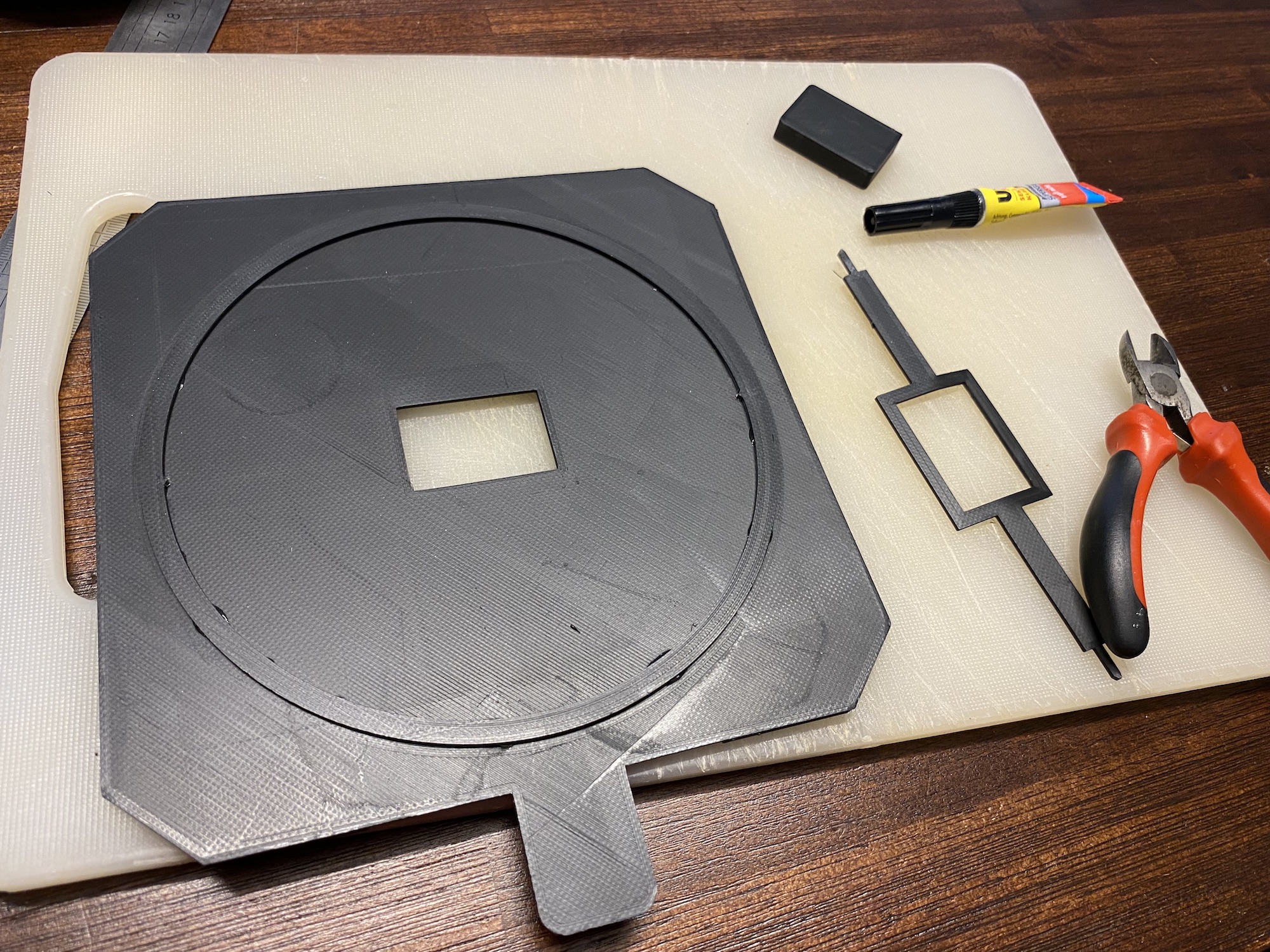

You will find four different files there called base, top, ring and center.
The top can be used as it has been printed.
the bottom piece comes in two parts, base and ring. You also need the center to align the two, see image (1). The ring is needed to center the base exactly in the middle of the enlarger above the lens and I decided to not print in in one piece because I then would have had to use support structures which would have scarred the base.
Add a few drop of glue to the ring (only on the actual ring, the connection in the middle will be cut away later). then stick the center into the hole in the base and put the ring on top so that everything aligns perfectly, see image (2).
When the glue has dried a few minutes, cut the middle part of the ring away, see image (3).
Done.
