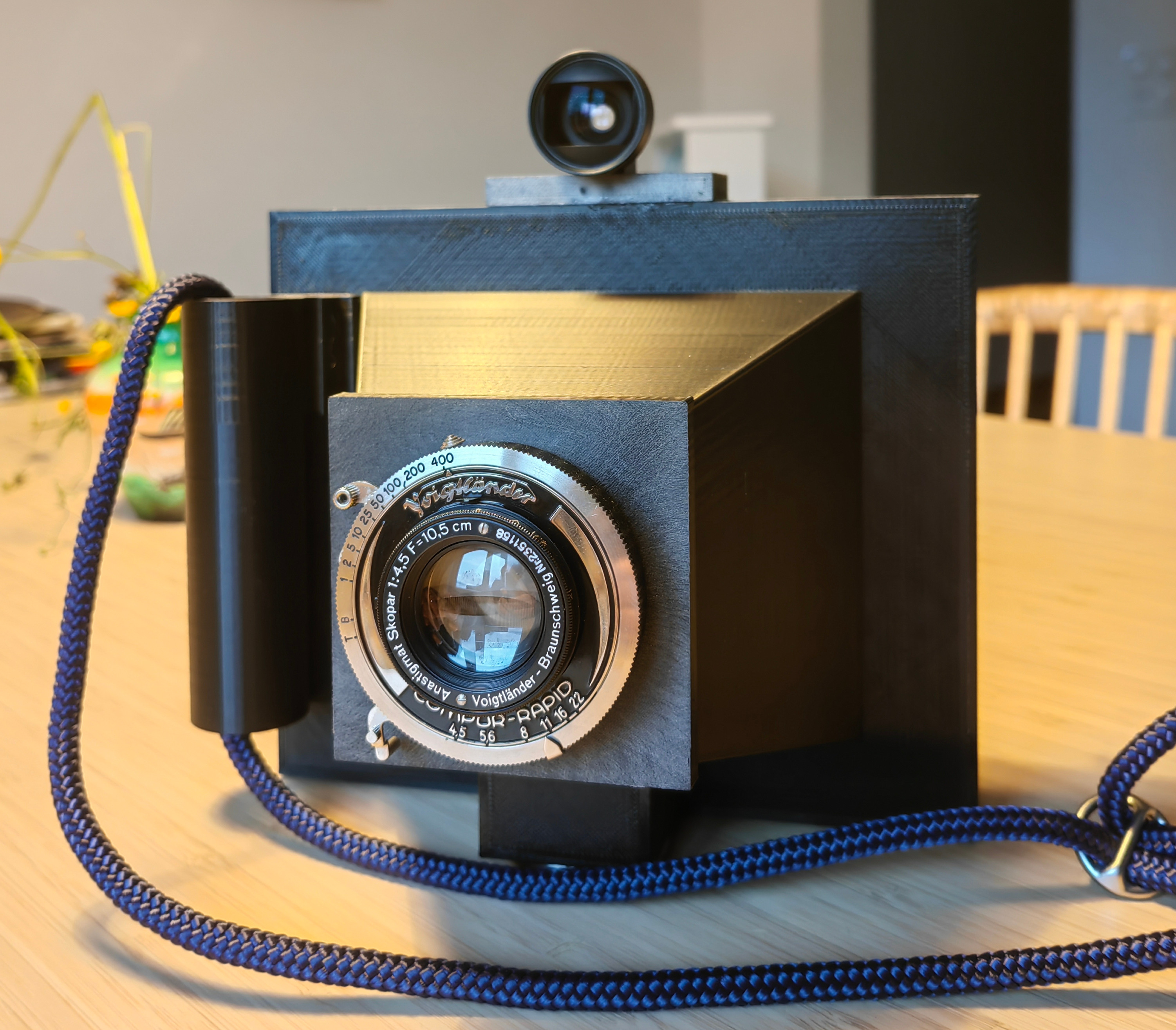

3D printed 4x5 Camera Body, what do you think?

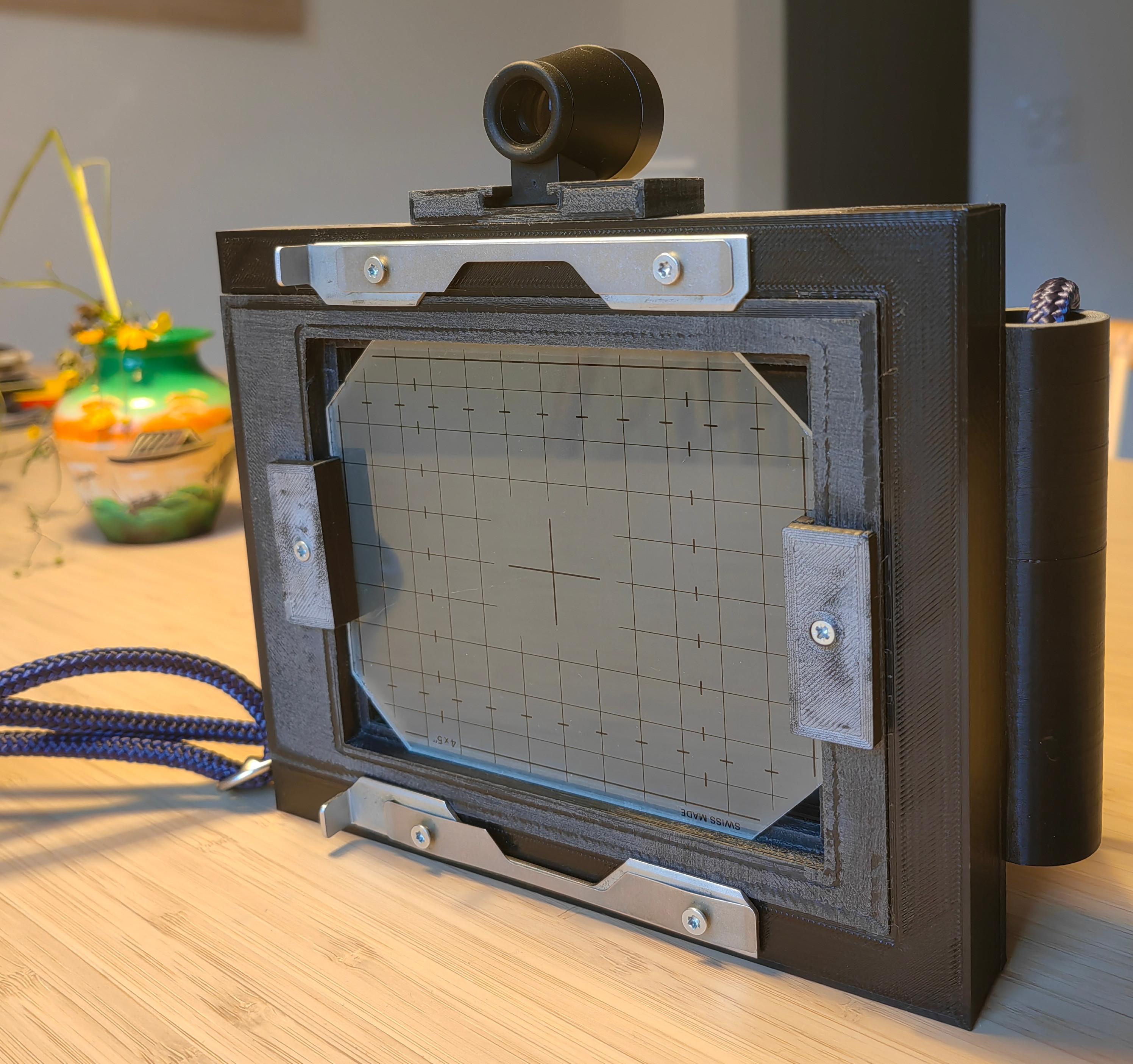

Hi Friends,
I made a upgrade to the Camera, now with viewfinder and a newly printed back with exact distance to groundglas (before it was 5.2 mm) now is 5mm. I also added a strap.
i like this thing :smile:

Interesting. I have a Wanderlust Travelwide 4x5 that was sold through a Kickstarter project a few years ago. It works great with a 90mm Angulon lens and I enjoy working with it. The Travelwide has a focusing helical that works pretty well and there was a pinhole provided with it.
I noticed another fellow is advertising a similar Will Travel camera design in various large formats on e-bay. If you don't need movements these lens cone designs seem to work well.
