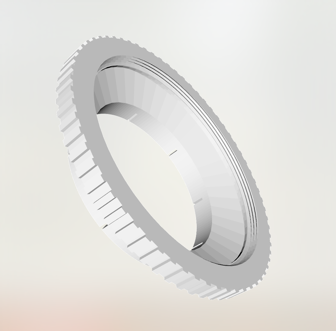

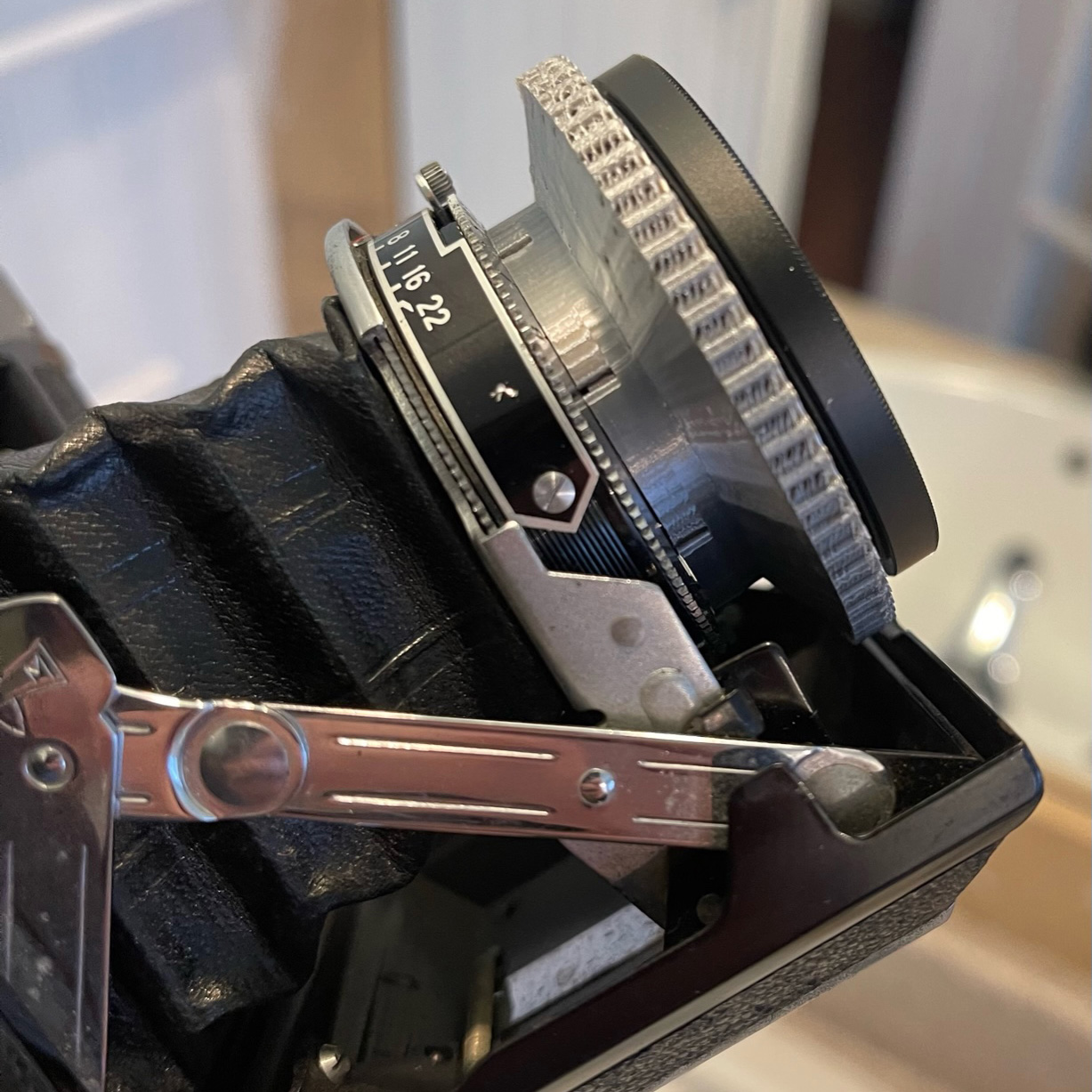

I made a 3D printable slip on adapter to fit 49mm filters on old folding cameras. The opening is 37mm, fits perfectly on my Mamiya six which has a 36mm wide lens.
Here is the link.
I would suggested printing with the smallest layer height you can, to ensure accurate 49mm threads.

Link works fine for me. As to threads, my experiences trying to accurately print threads like these on a filament printer aren't very good. However, due to the softness of the material involved, I usually just use some protruding notches where the threads are supposed to be and then make the fitted part 'thread itself' in there.
It might be easier to embed a 49mm filter ring or a 46-49mm step up ring to get a robust thread, rather than try to print it.
I have the file running on the printer at 0.1mm layer height at the moment out of curiosity. I have a camera this might fit, so it is worth it. Finding push on filters for the Zeiss is a bit hit or miss.

As I expected, my standard nozzle cannot manage threads that thin. A filter did snap in and screw out, as there are some incomplete lands. I have done coarser threads (M6) with some success.
This is pushing the limits of my FDM printer, though someone with a finer nozzle and more patience may get more consistent results. I am curious what the settings were for the original - material, temperature, speed, nozzle diameter, and layer height.

I printed mine in pla at 190 degrees, max speed 150mm/s with a layer height of 0.05mm. I used the anycubic kobra 2 printer, I believe the nozzle diameter is 0.4mm. The print is not perfect, but it gets the job done.
