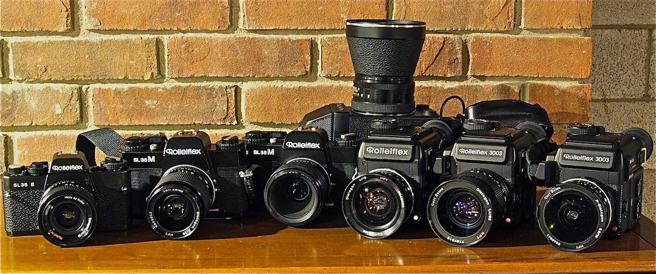

No "Jena" equivalent for these Carl-Zeiss lenses designed in the 1980s.
Indeed: that's when Carl Zeiss AG began having their lenses made in Japan and later in Thailand, and cameras made in Singapore...
