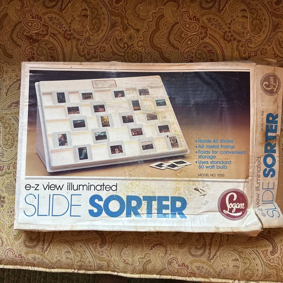

I use one of these to do that - thrift stores can be your friend:
I swapped in an LED replacement for the bulb to keep it cool.

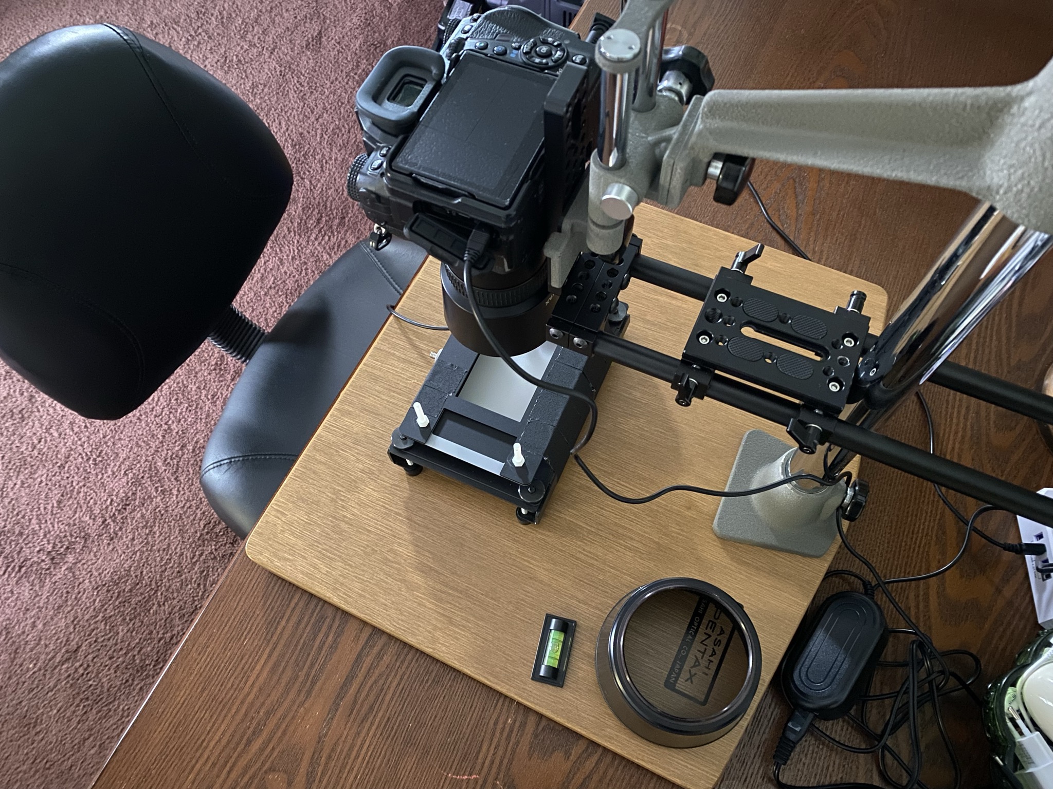

I have a baltic birch frame that holds both the LED light panel and the EFH. This is all set under the camera mounted on a Kaiser copy stand setup.
I'm using the NLP plugin with Lightroom Classic. This has been a very big help in recovering some of my slides from the 80's, when I was a big user of Agfachrome. Most of these have been hit with color degradation, very recoverable with NLP. Of course, my Kodachromes have all survived in stunning color.

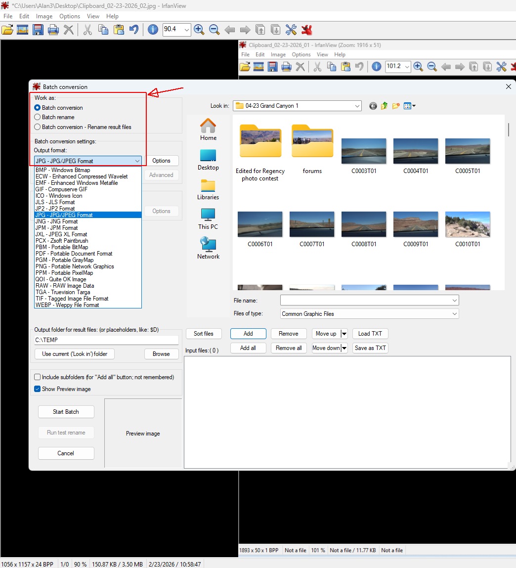

Irfanview (free) app has batch conversion and renaming. It also has simple quick crops and other edits, rezising, etc.
Download the Plugins too.
Here's what batch replace/ rename looks like. You can change formats etc as well.
