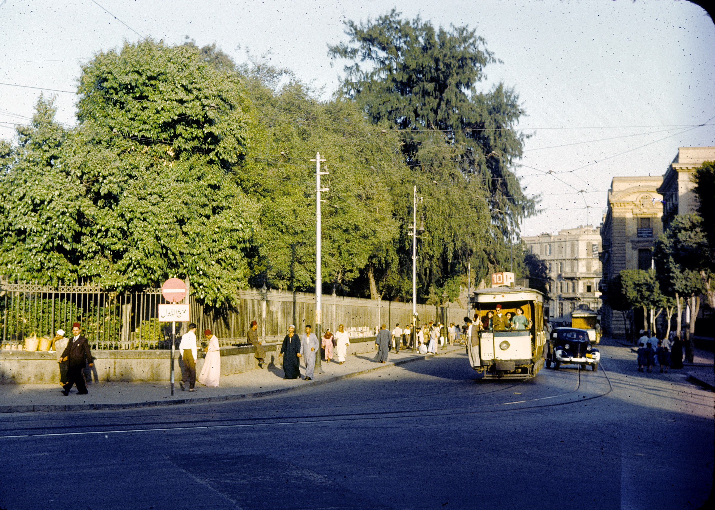

With my dad's hundreds of slides from all over the world, I applied a naming convention of <Date_specific-location_City_Country>. I use this when I scan the item. I do the same for my negatives and slides. For example, the full size scan of the Kodachrome below is <19501016b_Tram_Cairo_Egypt.TIF>. While scanning, I try to correct color (if necessary) and crop (if necessary) for each frame. I do not understand how a bulk automated scanning can be successful, or how bulk naming can work. Also, I find the follow-up work takes a lot of time. I add some Exif information, especially date (if known) and a title.
