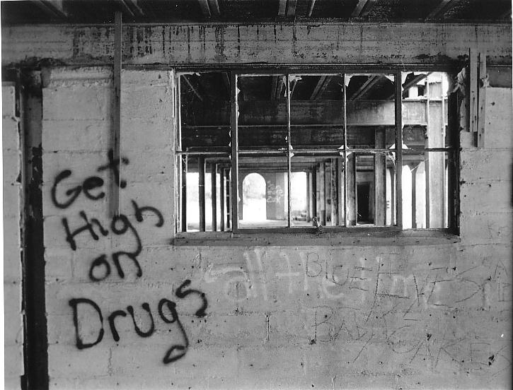

This post raises some questions that I have been curious about. Most of my B&W work is with 2-1/4 square medium format. I much prefer the larger negative for simple ease in printing. I feel the tonality is marginally better, but more importantly, I feel I get sharper prints with 2-1/4. This may be due to the extra care when shooting, don't know for sure. I usually use a tripod when shooting medium format with Mamiya C330 or Rolleicord IV.
Recently I reprinted the attached 35mm photo taken 25 years ago with a Nikon F2 and 35mm F2.0 lens. The film was Tri-X shot probably at F5.6. The edge sharpness on this print is not good. I do not believe it shows up well in the scan, but is very evident on the print. Left of the G in High and right of the window frame is quite soft on the print. The bottom row of block is getting soft, but the I beam is very clear in the center section of the print, but fades on the left side and right side.
I feel that I would get these results consistently with 35mm, but not with the 2-1/4 square negatives. Does anyone else out there get similar results with 35mm?

Loren, what you're describing sounds to me like an issue of the lens you used. As a Nikon shooter (when I do 35mm stuff), my own opinion is that the Nikon 35s are the least impressive lenses in their lineup- far inferior to the 50s, for example. The new Zeiss 35/2 ZF for Nikon mount is substantially superior to the Nikon 35s and should not show that edge weakness.

This softness is not a result of the format. It is a camera/lens/focus, or enlarger/lens/focus thing.
After looking at Loren's scan I agree with Jason and would just add it could also caused by lack of neg flatness in the enlarger, it's highly unlikely that softness in the corners is caused by the taking lens.

I agree. I just condensed, because it could be a number of things, film flatness in the camera, neg flatness in the carrier, enlarger alignment, etc. The thing to keep in mind is that the problem shown here is mechanical/optical, and not related to the gauge of film.
Agreed.
Loren, why not scan that negative and then you'll probably find that enlarger alignment is the main culprit.
[however, I stand by my assertion that the Nikkor 35s are not a fine example of what 35mm can do!]
