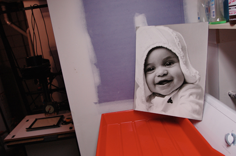

I'm just getting into b/w printing and was also pondering the same question a couple months ago until I started to experiment. I found that a 16X20 is definitely more than possible with 400ISO 35mm that is exposed and developed correctly. This print below is an example. Yes, a tad grainy up close but gorgeous 2 feet away with excellent midtones. T-max 400 (400) HC-110 (B) Ilford warmtone developer +paper (pearl finish)
