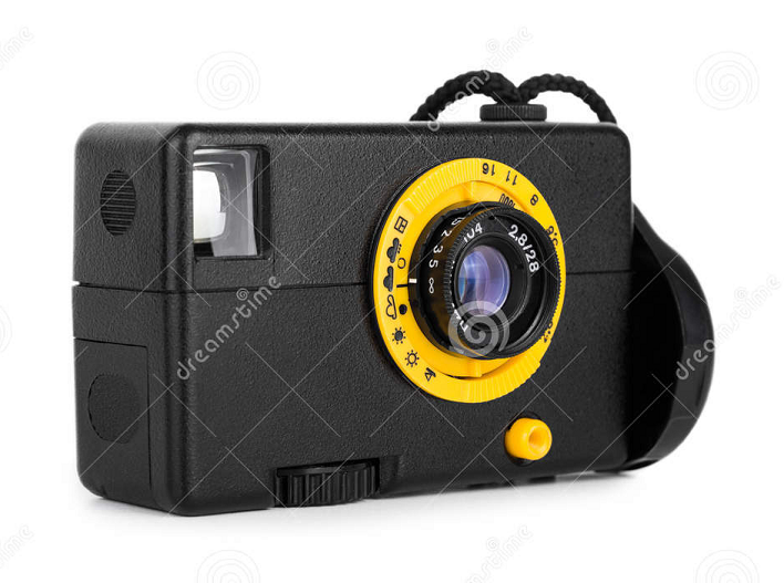

This stock photo showed up and I'm quite curious about it, but no branding at all.It appears to allow several apertures and several ISOs
https://www.dreamstime.com/stock-ph...-dubious-quality-isolated-white-image52144454
EDIT its an AGAT 18K
https://www.photothinking.com/2018-10-15-belomo-agat-18k-plastic-fantastic/

Its an AGAT 18K
And this Pentax Pino 35 is basically the same thing but from a more respectable brand.
It is basically not the same. As the Belomo Agat got scale focusing, the Pentax Pino has only fix focus.
And I assume that both cameras got glass lenses, the Agat at least even got a Tessar type, which contradicts your prerequisites.
