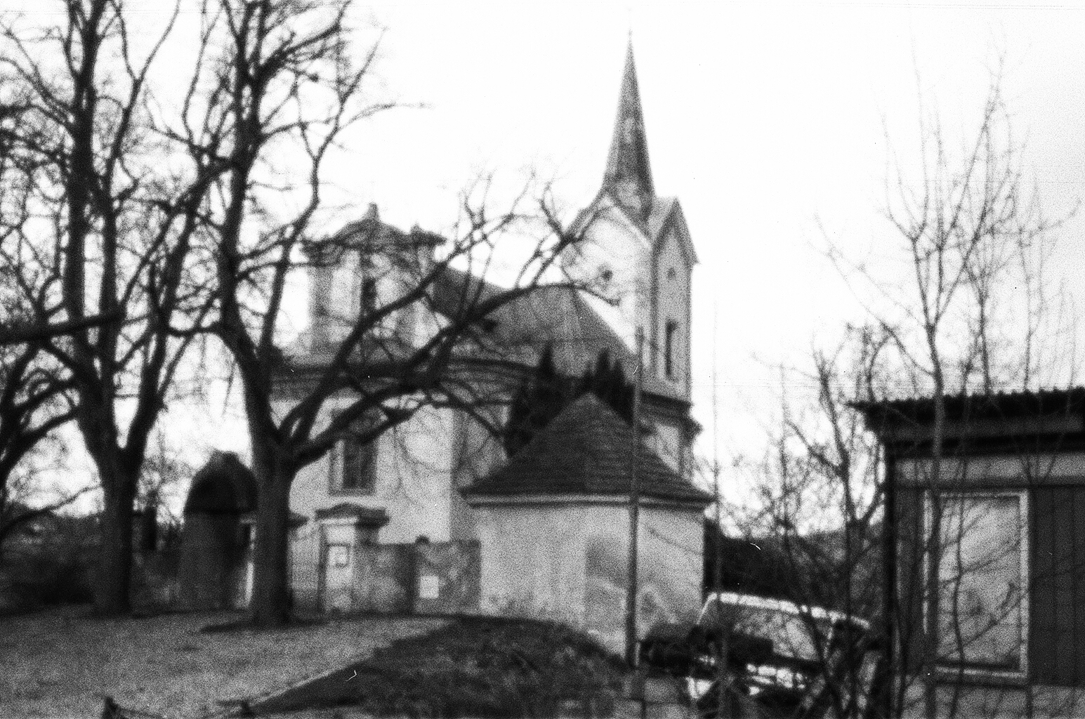

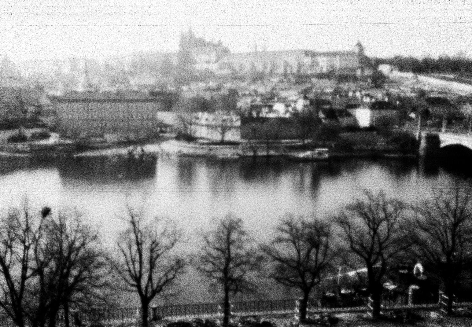

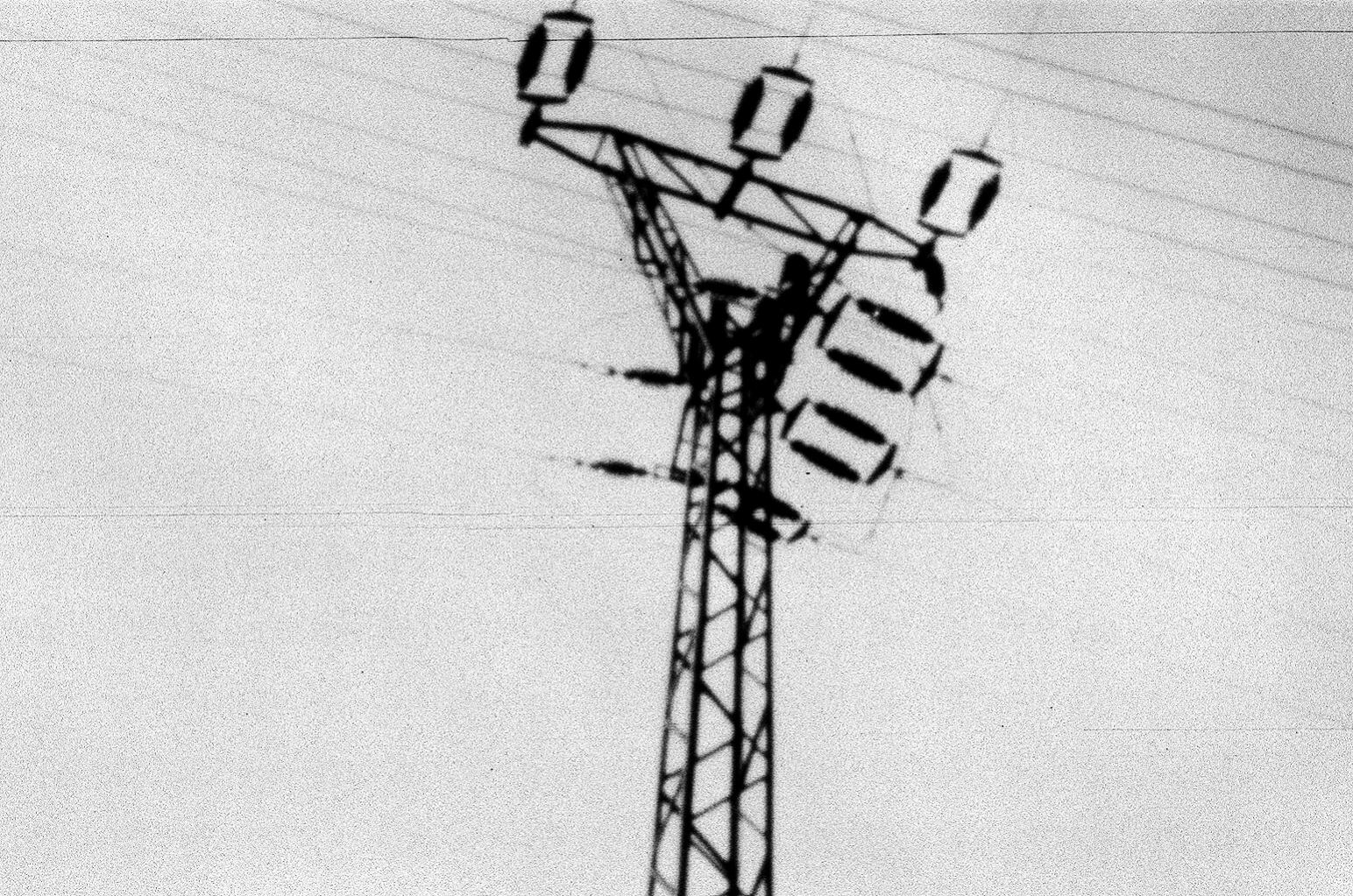

I'm new here and i have a question. I have made my pinhole camera last week and today i have first photos.
Is it possible to get more quality photos-i mean sharper? Basic dimensions: pinhole diameter: 0.3mm / focal lenght:45mm / film:35mm (the hole is perfect round-laser drilled)
I know, that i can't make super sharp and quality photos, but i want to achieve the best results.
And the 2nd question: do you think, that change the diameter of pinhole (0.2/f.l.25mm) will help with something?
Thanks!
Petr
Here are the samples..the color ones seem to be better-don't know why..

Petr,
Welcome to APUG! Its great to see more people working with pinhole cameras :smile:
The 0.3mm pinhole diameter you are using with 35mm film and a focal length of 45mm is just about optimal (according to the pinhole camera calculator). Its going to be challenging to get better sharpness from a 35mm pinhole device, since the negatives are relatively small and will inherently not have the greatest resolution/sharpness. If you want sharper images, the best thing to do is to go up in film format size. The Zero Image 6X9cm cameras provide excellent sharpness - in part, because the negatives are so much bigger.

I agree with Paul, but I want to tell you that I like the black and white images better, and they look normal for 35mm pinhole to me. I really like the 1st one!
( edit: agree with Joe too! we were typing at the same moment )

Petr, that is close to the result that I get with 35mm pinhole shots. I also use a .3mm laser drilled pinhole.
What Paul said about larger format is my experience as well. I have shot up to 4x5 with a pinhole, but have not pulled my 8x10 out to try it as yet.
I think part of the "romance" of a pinhole shot is the lack of sharpness, but the appeal of a pinhole image has a lot to do with the subject matter - so some would say.
I think your images are just fine, by the way.

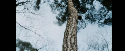

Here is an image shot with a 0.2 mm laser cut pinhole:
This was shot on 35 mm film. The format is 24x72 mm.
I was happy with the look of this one.
