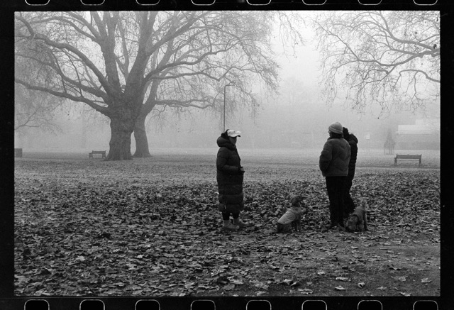

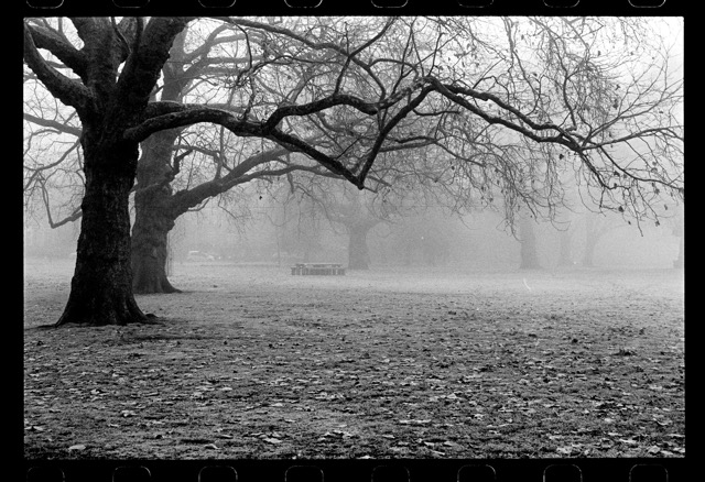

Guys …….thank you for all your replies……I was able to roll some fresh hp5 into some pre- checked cassettes this morning and sneak out to my local park and take some early morning test shots in the frost…… happy with the results ….. edges are clean with so signs of leaks so I’m guessing Craig was right. These were shot at 400 and developed in ID-11 for 13 (1+1) at 20…..
