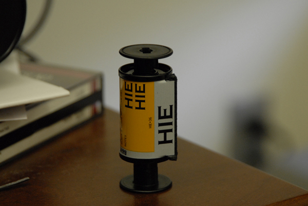

Let me suggest getting a 6x7, 6x9, or 612 back for 4x5, then you won't have to deal with curl issues etc. I cut a 120/220 spool in half and filed it down so that I can put the 135 canister into the holder. The rest is obvious.

Pretty darn smart, would love to see a picture of the setup.

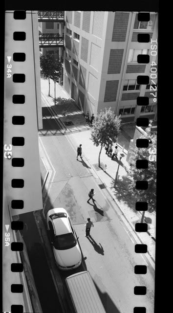

You can do that without tinkering, and having to deal with curling strips.
(Notice, by the way, how Portra makes a fine BW film. :wink: )
But no fun if the tinkering is why you want to try this in the first place, of course.
The above is a scan of a 35 mm strip, which, in digital editing, can be used as mask over any other picture you like.
That of course also won't do if you only print direct from a negative.
